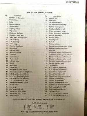

The green/yellow wire is for the rear screen heater, so it has probably come of the back of the switch on the switch panel.
Here is the wiring diagram for the UK 1.8 Marina Mk1. The heated rear window and switch are number 115 & 116. You can see the it takes its power from the switched power fuse 19, which also controls the tachometer (rev counter), indicators and brake lights and several other things if fitted. Start with the fuse, by a bunch (say 6) 35 amp fuses and check the one in situ, it’s the lower one of the two under the dashboard. Then replace it, switch on the ignition and progressively try each item until the fuse blows again and that will be the one that needs investigating, probably for a short or a wire off.

Have a look in the thread I started on here called Lucas Wire Colours where i listed all the commonly used wire colours. The picture shows the Yellow wire attached to the flasher unit this is clearly not an origonal BL wire. At the bottom left of the picture is a clear plasitc cover on a spade terminal not connected to anything the wire looks to be Green this is a fused ignition wire so should light a bulb all the time ignition is on an is the origonal supply wire to flasher unit. Looking at the diagram as supplied by Chris 19 is the fuse and is common to both indicators and wipers. I suspect the yellow wire has been added to replace a possible defective green wire as the connector on yellow wire is unisuated theres a good chance fuse is blown.

It's this relay. The wiring diagram is the same as posted by Marina Coupe earlier in this thread.
