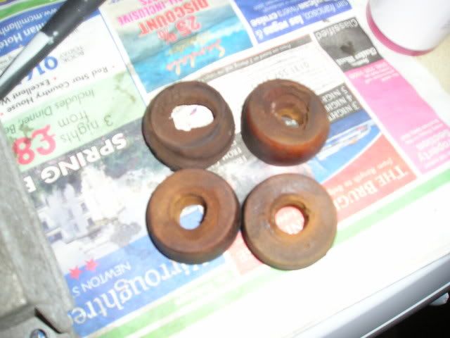

I replaced (at long last) my tie rod bushes today, the front suspension had been rattling and knocking for some time and, well, once I saw these, um, it wasn't exactly surprising :oops: :lol:
Needless to say, they're bin fodder and have been replaced by a set of shiny new PU bushes, they look great on it, I've still to drive it to feel the difference, but I'm expecting big improvements in road behaviour!

8) Just done that little job on mine mate :roll: ..are your tie rods still good?, take a good look at them while they are off as i have known these go like an hour glass on the stem where they pass through the eyehole in the lower chassis rail, then snap under the pressure of the new bushes :wink:

8) Tut tut Sean and Joseph. Just fill in your elongated tie rod hole with a weld and re drill it. :lol: :lol:
