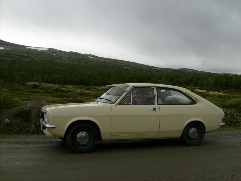

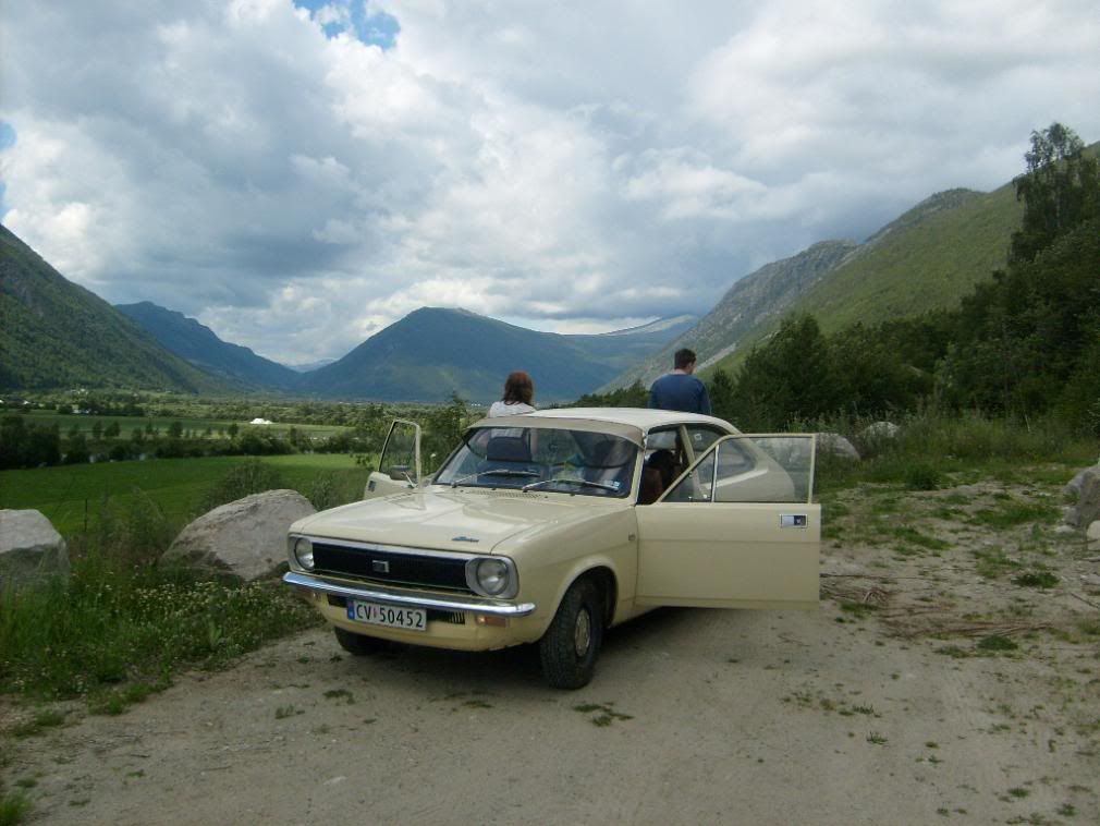

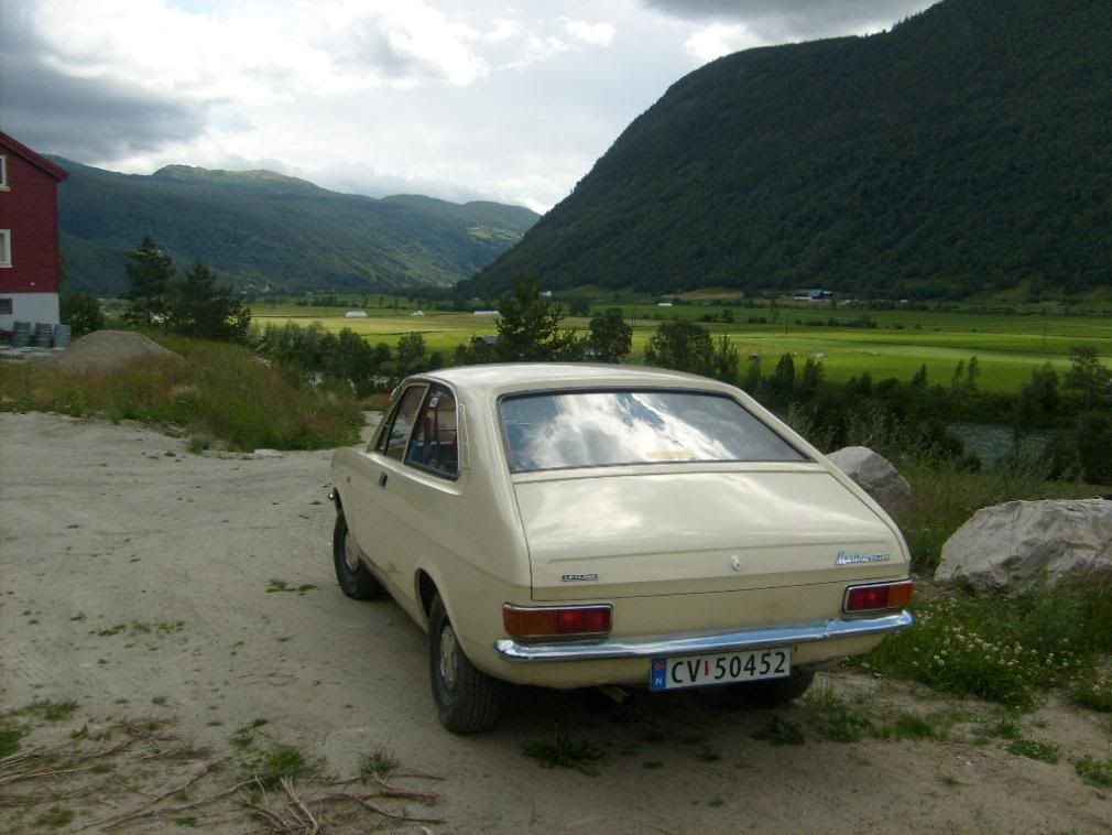

these are from the early stages approx 3 hours drive from Oslo (otta)

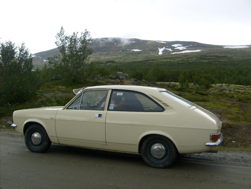

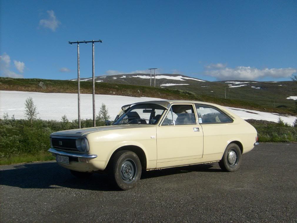

then we went over hardangervidda (sometimes refered to as norways roof)

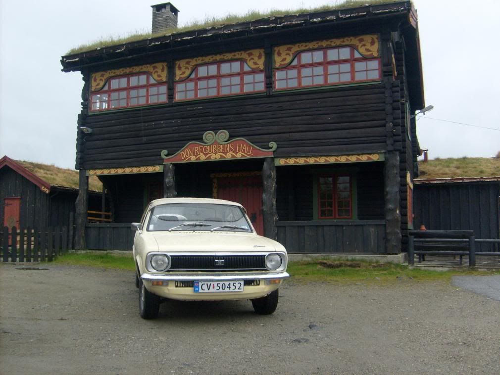

we stopped at this place for some traditional norwegian "rommegrot" before heading off.

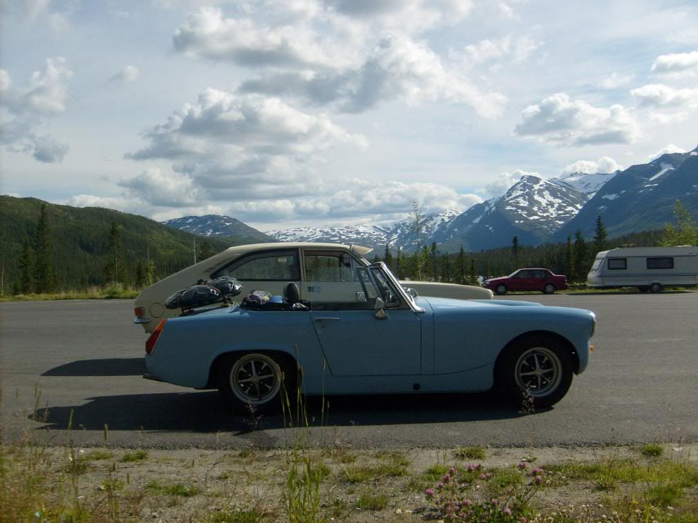

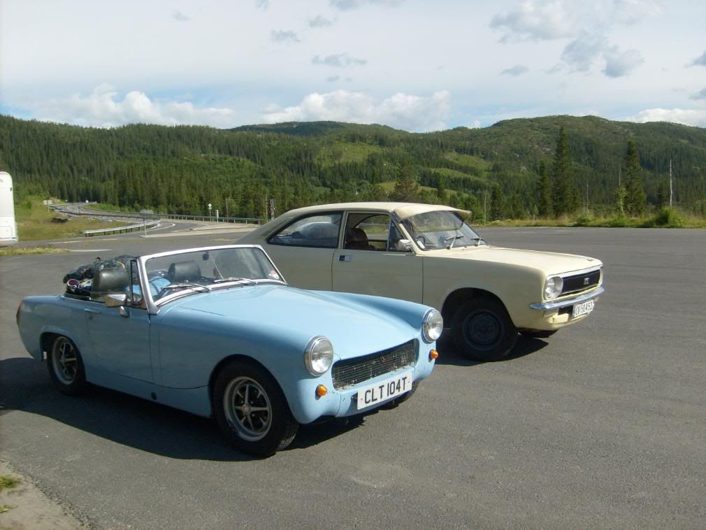

we sat off from steinkjer with a fixed wheel bearing, but as it turns out i think the mechanic have tighten the hub-nut a little too much so i've decided to drive without hub-caps for now. After a while i spotted a Midget with a uk -registration in the mirror. We followed each other for a while and when he pulled off i did a u -turn and spoke to him. He was from down south in uk and was on his way to lofotoen . lovely late midget with a triumph 1500 engine.

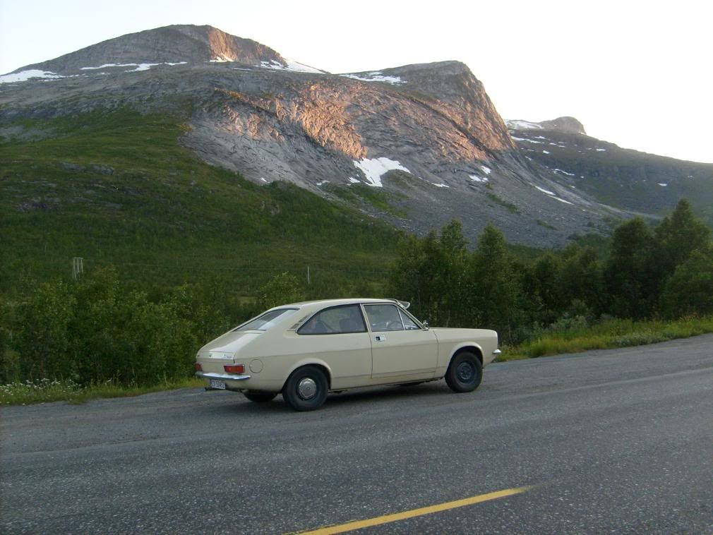

We headed further up coming closer to the polar circle

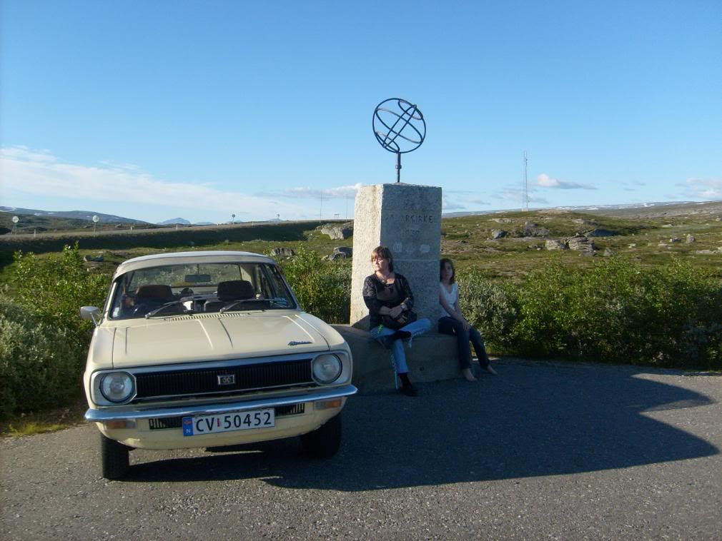

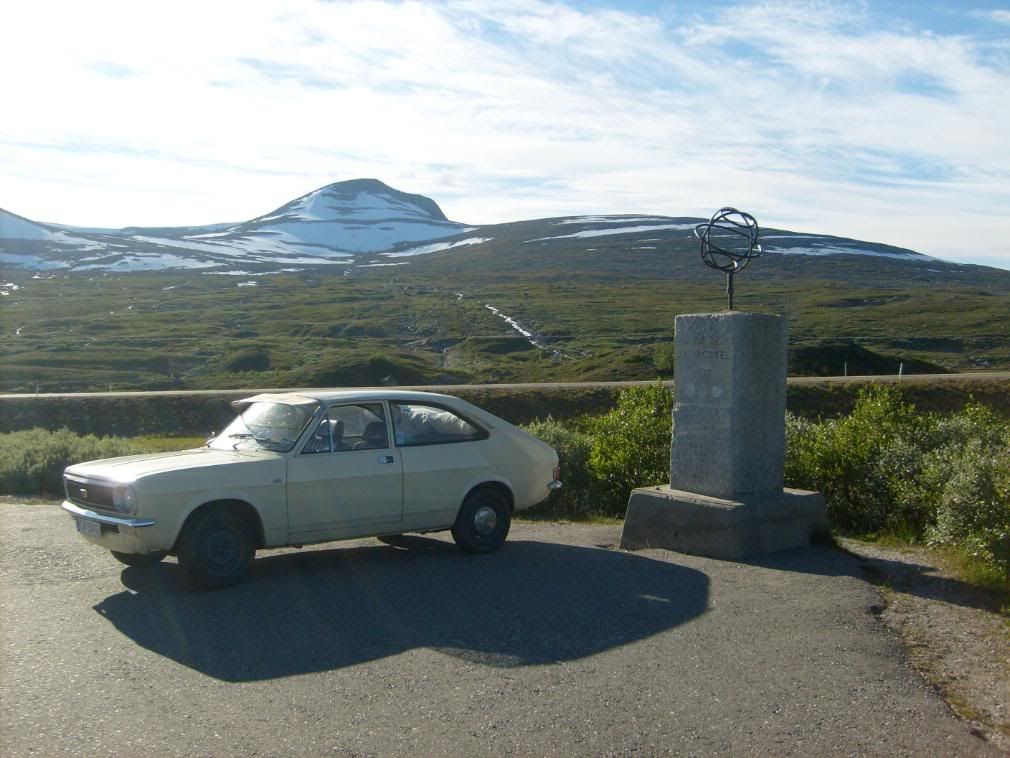

Then we was at the polar circle ans stopped for some photo-session even if we were a bit pressed for time if we were to reach the last ferry. The polar circle also mark the point from where the midnight-sun begins

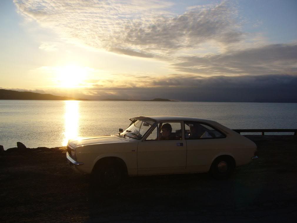

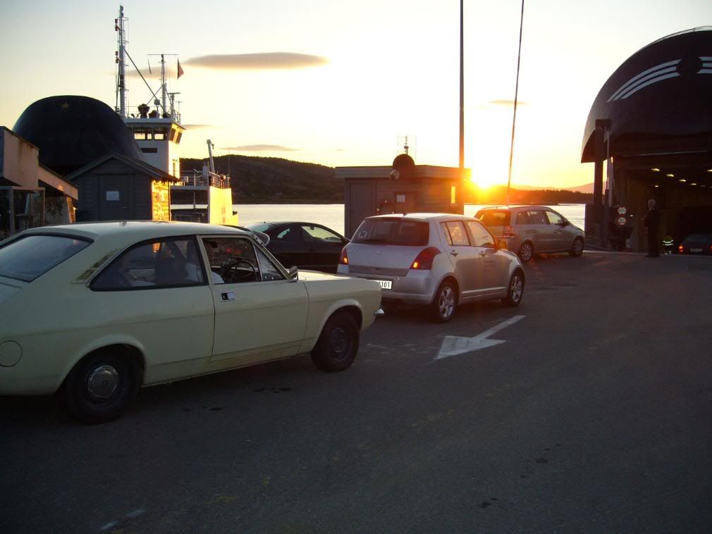

at 00.30 we entered the last ferry
from the ferry at about 01.00
reached harstad at 02.30 in the night - still midninght sun. We have now finished approx 1400 kilometers and are 2/3 on the way to north-cape :)
(pic could probably be better with some photo-editing...)
