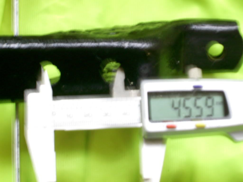

I'm wanting to fit a roll bar to the front of my Mk1 Coupe...
I need a later lower arm so that I can mark where to drill t'ole! (I'm from Yorkshire, sorry)...

So, back to the bottom arm.
Anyone got measurements or a spare arm/s ?
I can return them once I've done my measurements.

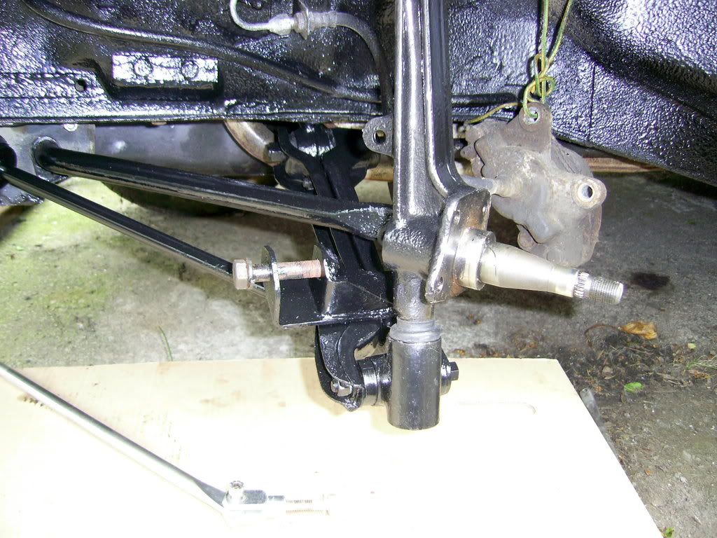

The anti-roll bar (ARB) passes through the bracket below the chassis rail behind where the Tie Bar mounts to the chassis.
The ARB body mounts bolt up to the bracket. When Paul Mondey did my bodywork recently, I got him to cut the slots required to mount the ARB. However on talking with Paul Viney, when Frank did his bodywork on his Jubilee, they had to fit a new chassis section and this had the later slotted mount. To fit the ARB you really only need to have one side slotted as you can slip the other side through the mounting hole.
I'll take some pics in the next few days, so that you can see what I mean.
On v early Mk1s, there isn't enough bracket to mount the ARB, obviously at that time they weren't thinking of having ARBs at all.

Post by Muskydo » Wed Aug 20, 2008 5:35 pm
Hi Rob here's a picture of lower arm if it's any good to you,
the measurement for the ARB hole shows 45.59mm the left hand hole being the ARB hole.
This pic hopefully shows the Chassis bracket which needs to be "slotted"to allow ARB to fit.
Hope this proves helpfull, any other pics you want need just let me know.
