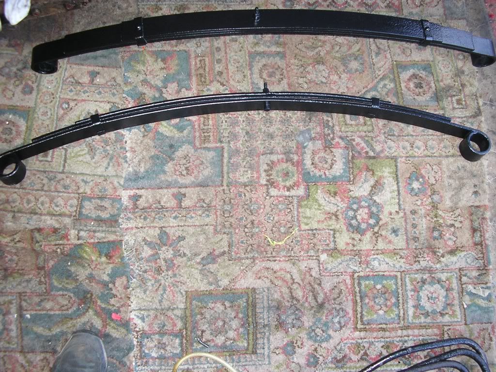

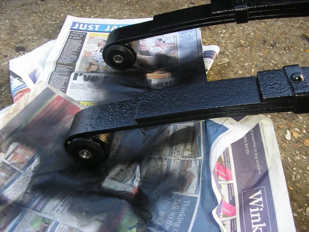

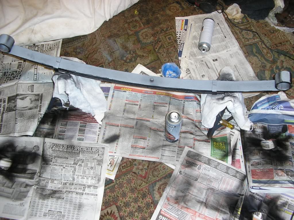

had a go at cleaning and re-painting some decent leaf springs and fitted superflex spring bushes,wondered if anybody had also tried superflex bushes and do they give better results?
primed

superflex bushes fitted

I love the newspaper ad in the first photo.......WOO HOOO :!: :!: FREE PORN :shock: :D :D
