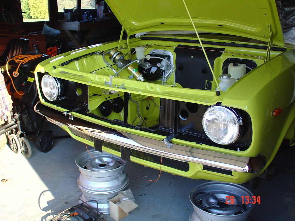

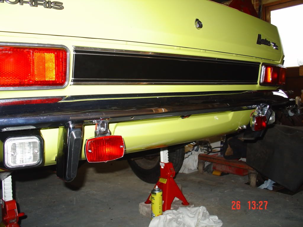

I have lower fogs and upper spots on the front and rear fogs with no holes in chrome and just a small pilot hole behind the grill for the steady strap.

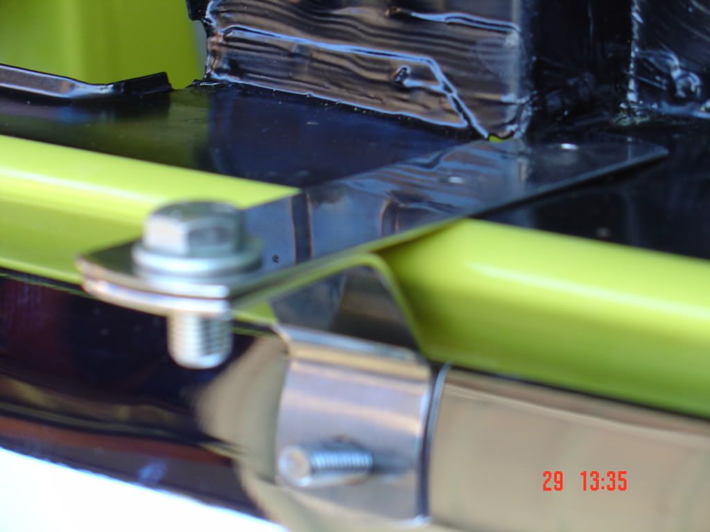

Rear clamp on to bumper so can be removed to leave no trace.
Front mounts use the bumper irons.

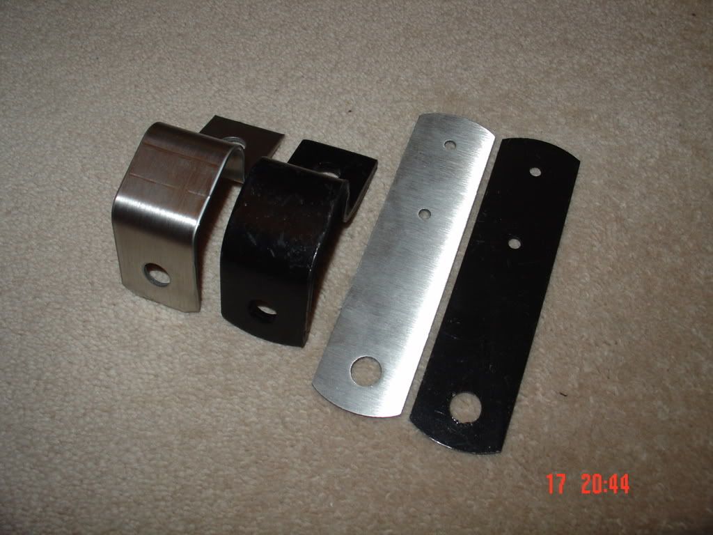

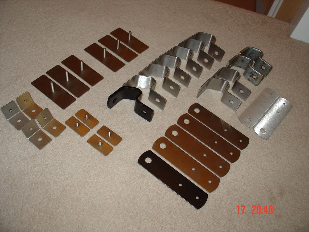

I copied the front brackets from an original BL one and got them done in stainless and polished up.
the rear fogs which are 1970's NOS have the clamps already. That's why I searched for those as my original car had them 23 years ago and they fit nice.

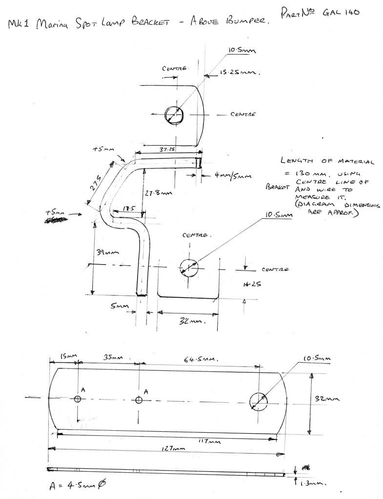

the rear fogs are small Lucas units. Can't remember the lucas number but they are not the more common large type with metal backs. These are all plastic but have a chrome finish on the rear so are light weight.
I had some brackets made up
Here is a rough drawing of the front upper bracket.
The lower front bracket is easy to make as it is a 90 deg small L bracket which fits to the front bumper iron and the fog fixing also has an Eye bolt which acts as a steady and this is bolted though the flat baffle panel which sits behind the outer front panel.

Re: Spotlights / Foglights etc
Thanks Paul, especially for the dimensions pic
