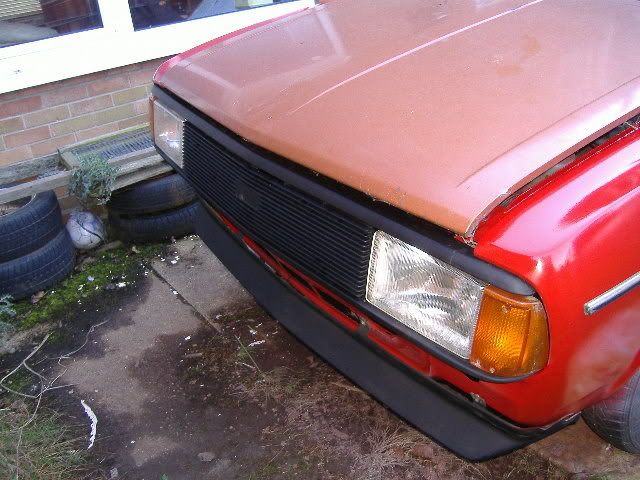

Just to let you know what has been attended to:-
Both sills
Both rear spring hangars
Rear valance
Wheel well
Both rear arches
Nearside rear jacking point
Both front jacking points
Bottom offside A post
Top offside inner wing
Both light 'bins'
Front valance
Front crossmember
Headlamp panels
All nearside A post
Top nearside inner wing
Both front wings from Smith & Deakin
Both wing tops re-inforced
Refurbished propshaft
Nearside rear brake cylinder
Both rear brakes new shoes
Brake master cylinder
and a rough respray in Rover '89 Flame Red......
I only carried on when I found out how few of these things are left running as when I found the nearside A post rotten away I very nearly cut out all the good repairs and scrapped it. Mind you, it feels good to have finished it!
