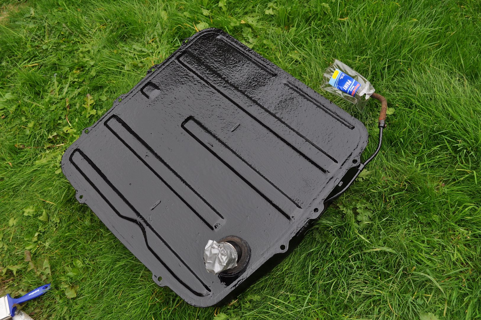

I had the tank out of the V8 over winter...
This is what they look like.

Re: Can we try an MGB tank for size?
Does that mean the MGB sender is the same?
Or is the exit pipe bent differently?
Looks a bit different.
May be they still can be used?
The MGB filler hole is on the top rather than the Marina on the right.
The MGB sender is on the right rather than the Marina sender on the front.
