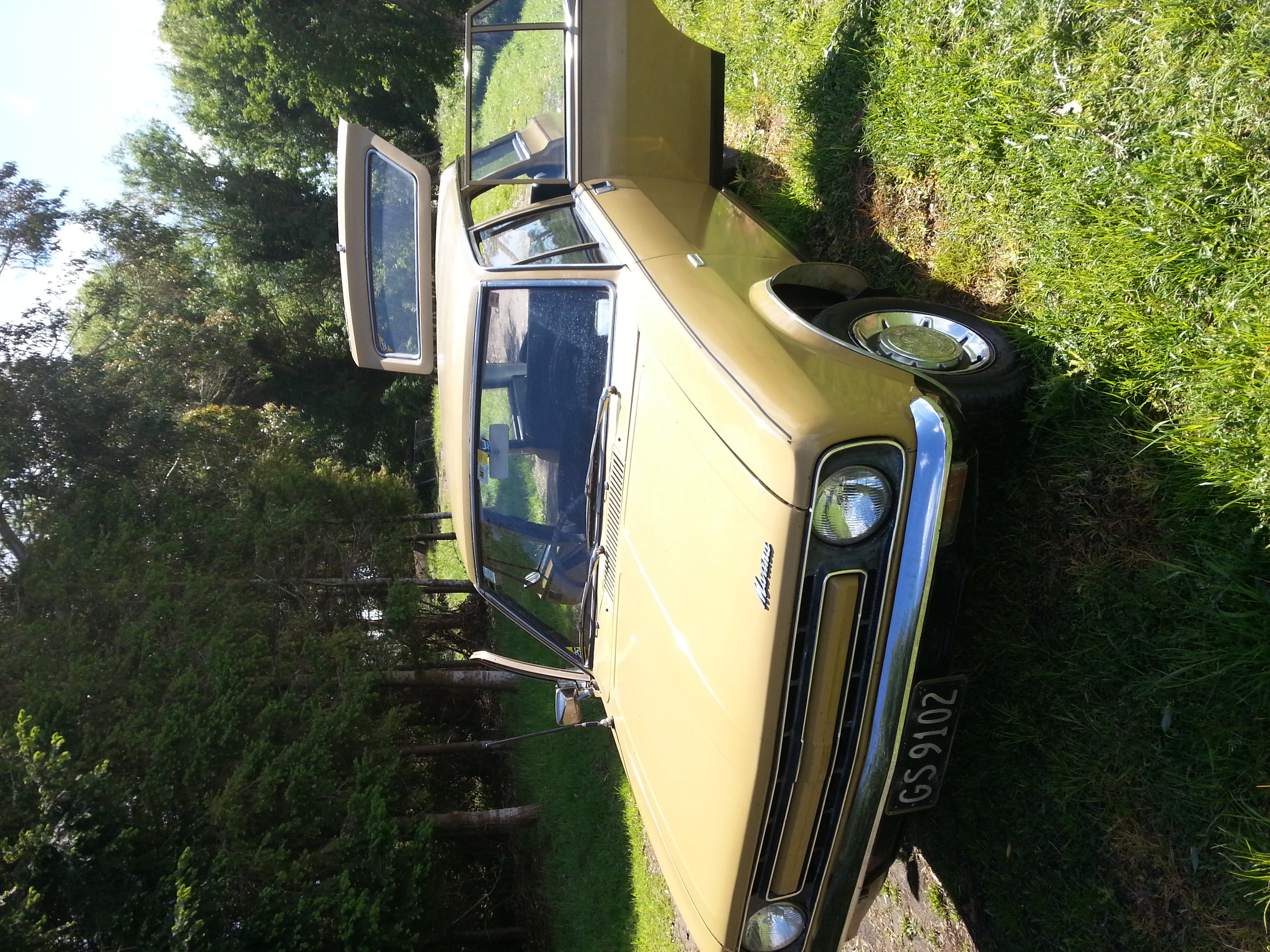

Scott here with the 74 marina estate from Belfast.
Thanks for your help again, will try drop off that gearbox next time im over your way.
Kind regards Scott
Kind regards Scott

Re: Gearbox bearing
Nearly driving happily around. ...just failed wof on the steering rack.
Im trying to get this fixed asap, then i would be keen on attending any morris related events. I did meet all the morris guys at the chch swap meet, nice bunch of fellas.
