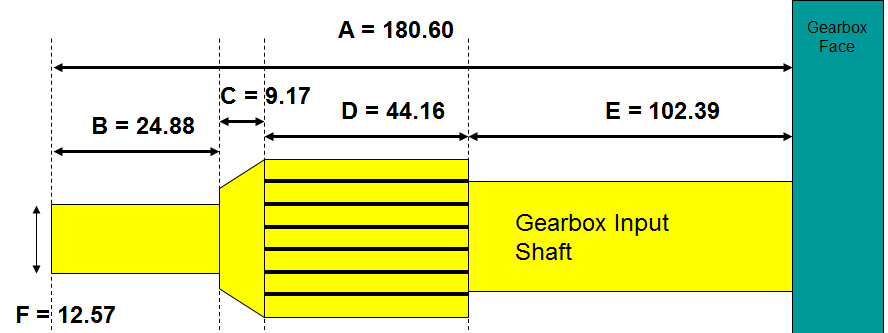

Funnily enough Steve I was digging back through my Type 9 conversion files and came across these.
The second one below is the 1.3 Marina for comparison

That length I have been given (11") must surely be the total length of the shaft. I cannot imagine 11" inside the bell housing. If it is the total length, would that be the same size as the 1.8 Marina shaft, and would that then give you 9mm of spline into the clutch disc?
