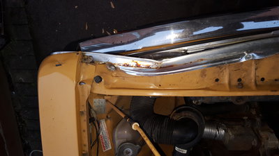

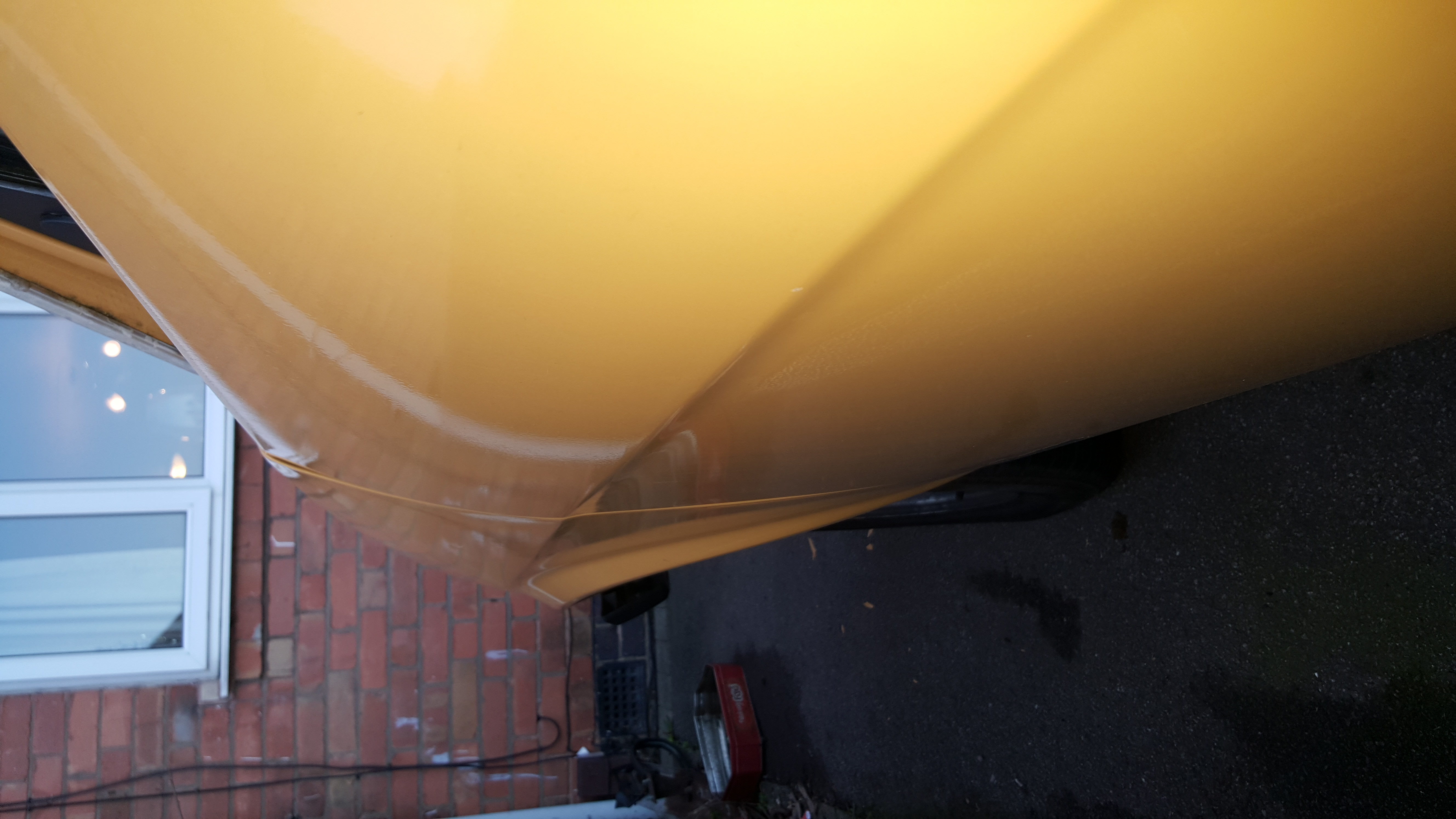

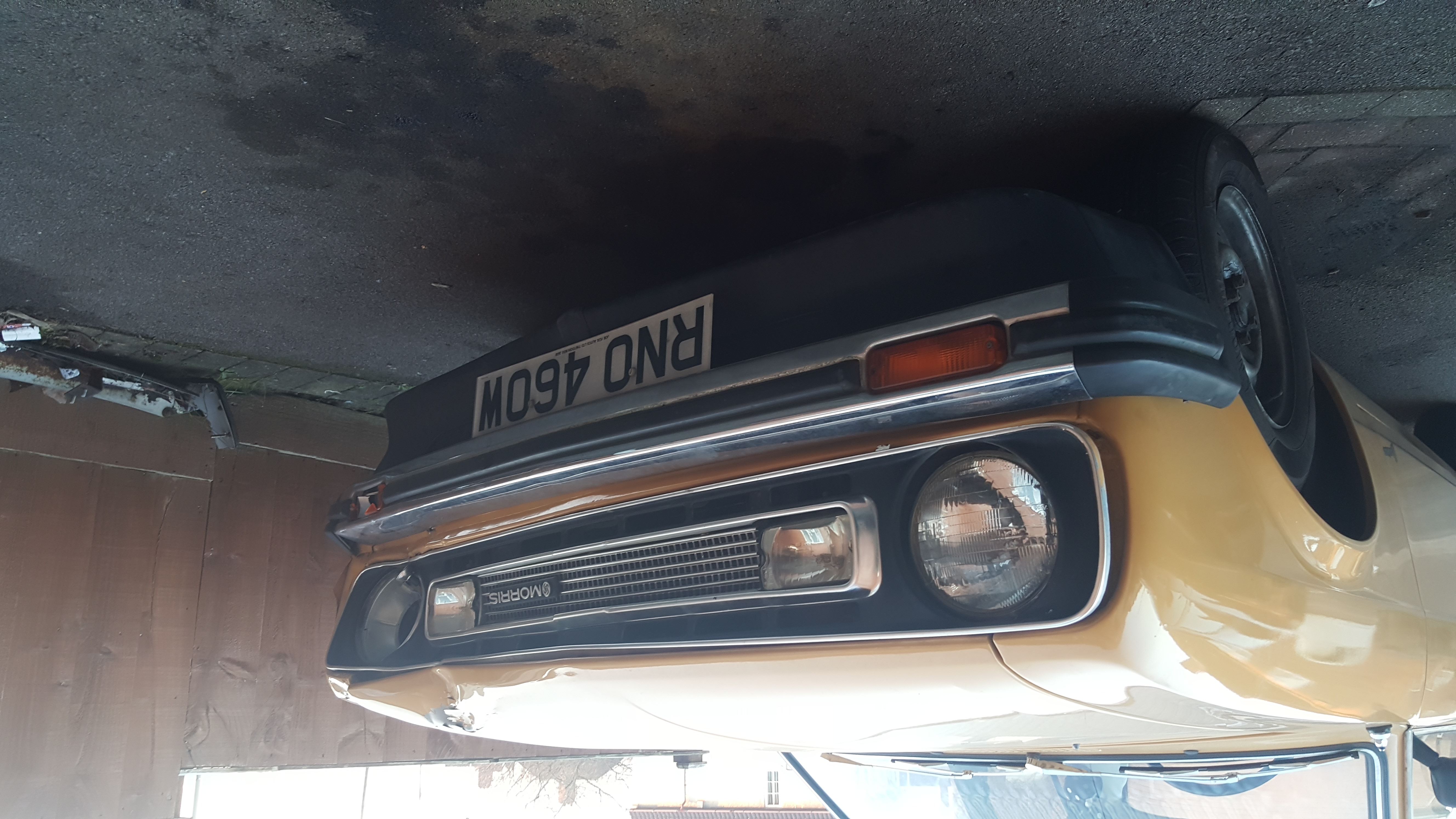

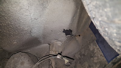

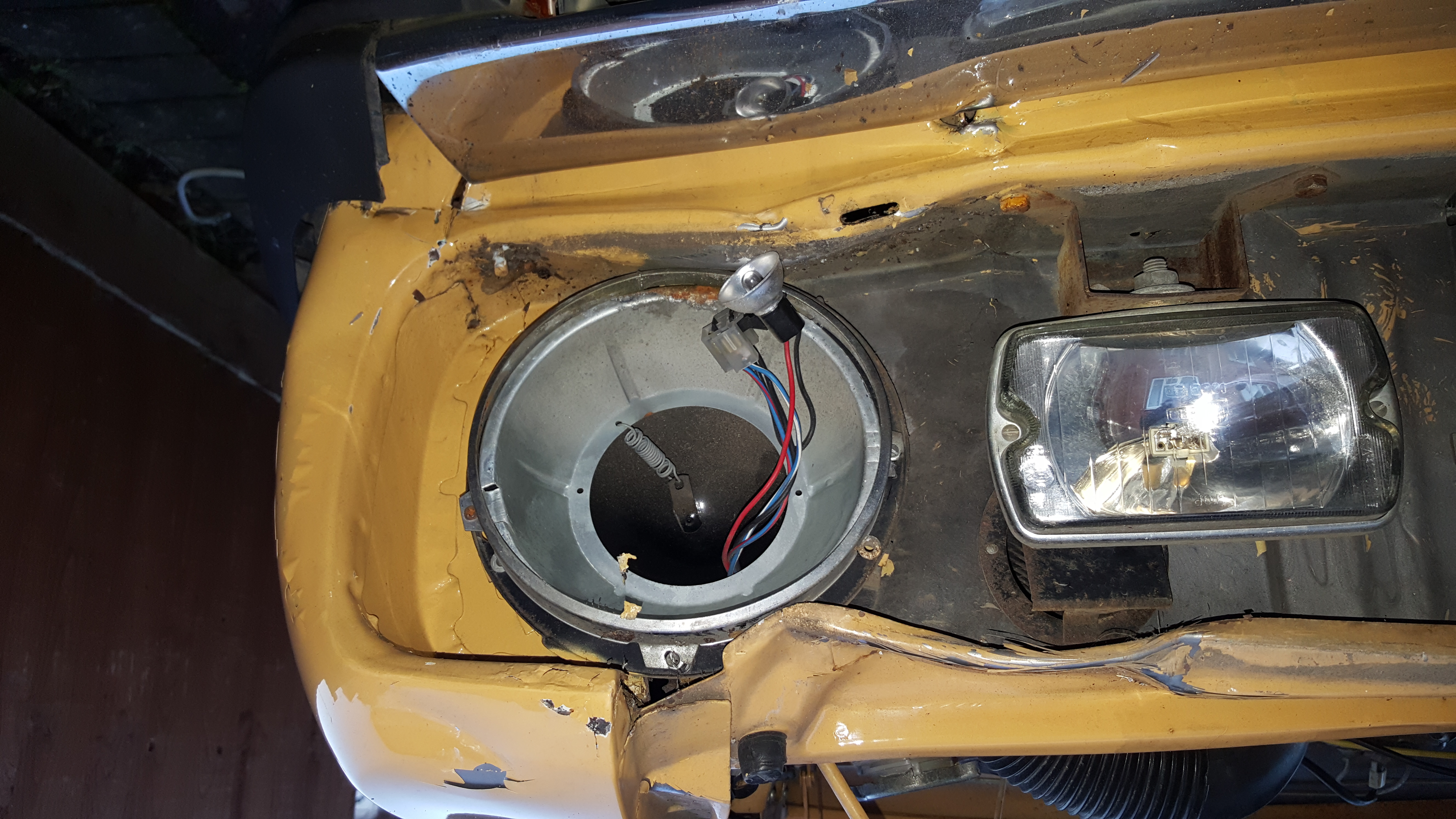

Hi, yesterday my marina was involved in an accident when I was cut up in an overtaking lane at speed, you all know how it is with those certain drivers who think they rule the road. Anyway, I've spent a good 9 months making the marina roadworthy, to the point where I haven't seen a penny to myself since then. All the hard work and the long repair list I have had to fight through all seems to be done for nothing. I am completely stuck on what to do with the car now. It does seem easy to just call the car a write off but the damage seems to be to the body and inner wing, the chassis is still straight as it narrowly missed the point of impact by a few inches. I am quite fond of the car as I have had to do so much and what is a bit of bodywork after coming this far? Here are some pictures I have taken of it so please let me know what you think, however bad your outlook on it may be! Doesn't seem like I've had much luck with this one! Apologies for the upside down photos, I can't get them to rotate!

I my honest option, I think the damage is repairable, though it would take quite a bit of work getting it straight again, but if you're saying the chassis is good, that's one big thing you don't have to worry about. I know how your feeling though, as there's been points on my car when I've just wanted to give up on it, but I think the same as you, what's the point in giving up now as I've come so far, and it's once you do the work and drive it, that you know it was definitely worth it. It would also be a shame to lose such a nice example from the roads for good.

I second that, damage does look repairable, soul destroying though after all the hard work, but would be a shame to give up on it now, although I might give it a rest for a while, wait until you're ready to get properly stuck in to it again and it'll feel even more worthwhile in the long run.
Re: Is this too far gone or worth saving still?
Certainly looks repairable but assuming you are going through insurance it could be a minefield and may prove to be your biggest obstacle. If it's not on a classic policy then it will be written off as approved repairers such as Nationwide wouldn't have a clue what to do with it and the parts aren't available off the shelf. Somebody hit my 309 and the damage was similar to yours but it was going to be a write off if I went through insurance because of the parts availability and the fact repairs would have been more than the value of the car. I ended up buying the bits myself to fix it, a bit annoying as it wasn't my fault (my car was stationary) but that's life sometimes
Where my inner wing had folded up I cut the bent sections out and welded new steel in, it was easier than trying to unfold it all but on a Marina it should be a bit easier. I have a MK3 bonnet sitting around doing nothing if you need one, it's even the right colour!
The panels are all out there and no amazing technology is needed to repair it. All it will take is skill. Sadly skill costs money but then again we do it for the love rather than any financial benefit! The inner wing looks to be OK around where the shock absorber is which is a good sign.

The car is certainly repairable. Like others have said it just needs the right skills to get the job done.
From what I can see you need:
Passenger wing
Headlamp panel
Slam panel
Valance corner
Inner wing (easier to fit entire panel when wing is off. Makes a better repair and returns strength to the shell.)
EDIT: Just seen this on eBay! Inner Wing
Does the door open and shut ok? Looks like you might have been lucky and not moved the A post backwards.
Marinas are strong old motors, and the inner wing did its job in keeping the impact away from the cabin.
