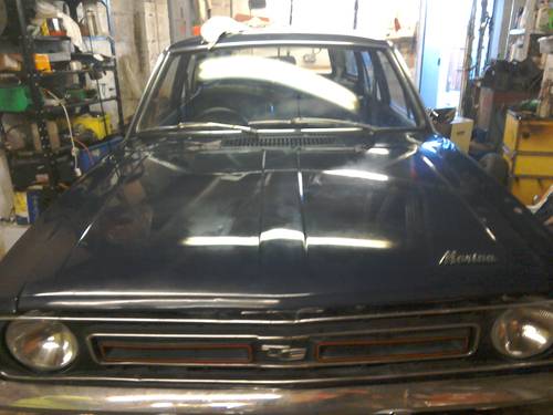

Had a look at this yesterday, will get some photos up later.
Still in two minds myself but I think it's not tidy enough for me- if I'm going to have another estate it'd have to be a really nice one- I've been spoilt by my Mk2.
So far as I can tell it was a Mk3, originally in the bright blue that Dawn Thornber's car is in. It now has an 1800 B series with twin carbs. Both engine and 'box are gold, so presumably gold seal. It's been resprayed in the dark (midnight?) blue, thorough job including doorshuts and underbonnet (but not boor floor inside- hence knowing what colour it was!). It's not a bad respray but not show quality- there's some overspray and a few sags here and there that I spotted. Looks very straight and solid- the only obvious filler was in the rearmost pillar where it meets the rear quarter. Wings look good except for the top rear of the LH one which has bubbled (adjacent to the scuttle). Think it's more likely to be paint reaction than anything else. Lots of underseal underneath but from what I could tell it looked very solid.
Other than the engine the only other TC aspect is the front grille. It does have Mk1 bumpers (front is tired chrome and slightly bent) but no underiders, and arch trims. There's no window surround stainless trim (including windscreen, that has the mk2 on plastichrome) or sill trims. Window weatherstrip and stainless trim is apparently with it but needs fitting.
Interior is nice, looks to have had new carpets, standard SDL doorcards in reasonable order, front seats aren't Marina (not Mk1 anyway, and they are vinyl) and have been painted but look the part, rear seat is Mk1 estate and looks good. Mk1 dash (navy) in good order although the wood effect trim is a bit tired, non standard steering wheel. Switchgear is also Mk1, mostly looks a bit tired, dip beam doesn't work so suspect the stalk is duff.
Didn't drive it but it started OK and sounded fairly well, although lumpy at idle (it wasn't exactly warm yesterday though). Engine looks a bit shabby (typical gold seal paint!) and the engine bay in general is a bit grimy but nothing that some TLC wouldn't solve.
Clearly been loved as it's had money spent on it- respray is the obvious one, it's got recentish brake lines, rear springs and shocks, and a few other bits and bobs. Has the potential to be a very nice car but it will need a fair bit of finishing/ tidying and probably an amount of recommissioning.
The seller is aware that the price is a little optimistic, he spoke to a club member a few weeks ago and that's what they suggested. My view is that it would have to be near mint to be a non tax exempt estate at that price- I'm confident that he'll accept considerably less.
Be nice if someone will take it on as it'd be a respectable enough summer toy without too much bother. It might still be me but I'd gone down with expectations of it being mint which has clouded my judgement a bit.

its had mk1/2 front doors fitted note the seperate quarter light,looks nice different a tc estate
has it had any suspension upgrades?or standard mk3 .
best regards
barry
Re: 1980 Estate C&C with TC looks
Post by PHUQ » Mon Feb 13, 2017 9:40 pm
They are either Mk2 doors or someone has managed to fit separate quarters to Mk3 doors. They've got the flip seal channel so not Mk1.
Standard underneath- forgot to look at roll bars, but normal late type lever arms with normal (not Walford) trunnions, 3 leaf rear springs if I remember right which look nearly new.
No "special" bits on it that I noticed beyond the obvious TC trim bits. Personally I'd probably put a standard mk1 grille on and have it as a bit of a sleeper...
