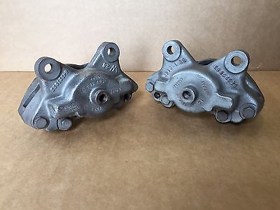

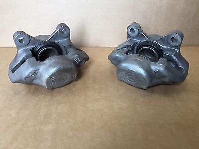

The brakes are old school cast iron opposed piston Girling Type 14LF, common with Triumph Dolomites and Spitfire
1500.
Here's a pair on eBay.
http://www.ebay.co.uk/itm/Morris-Ital-M ... 2866409415
