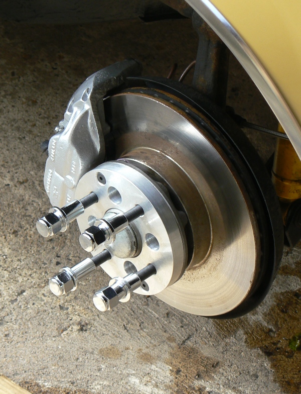

The wheels I have used on mine were firstly some 6x13 Performance MiniLites, these needed generic 5mm spacers to correct the offset - the inside of the tyres were rubbing on the top front suspension balljoint/arm. They did not require hub spigots to locate the wheels as they had 60 degree bevelled steel inserts in the stud holes and I used 60 degree bevelled wheel nuts to centre the wheels on the hub.
The second alloys are early Revolution Alloys they are 6x14. The reason I went for 14” rims was to fit over the Princess calipers. Without the wide brake calipers, they would also have fitted with the 5mm spacers. They use a different mounting system of long sleeved wheel bolts which clamp to the wheel hub.
When I designed the spacers for the Revolutions, I could have designed in some hub Centre spigots to fill the inside of the revs, but the original wheel bolts do a perfectly good job.
It’s only modern wheels on modern cars that are hub centric, but most wheel companies aren't used to classic cars and so give advice based on how modern wheels are fitted.
