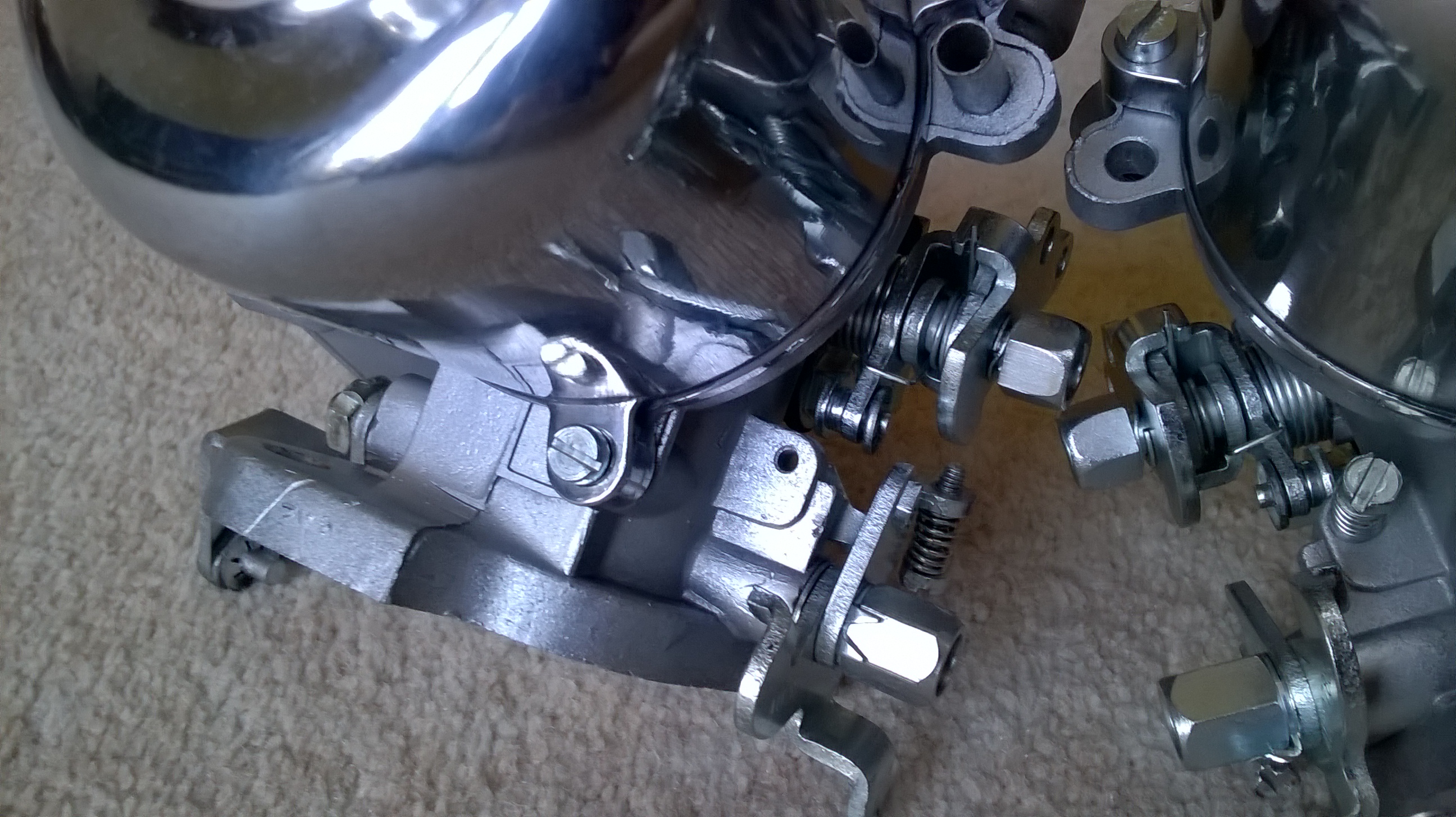

I've got the S.U.s back. Posted to me, delivered by Parcel Force while I was out, and collected by me yesterday. They look okay. These bodies do not have any holes for vacuum take-off stubs so they suit my car. However I've still got questions. Last week when I went to see Andrew Turner and he produced two naked S.U. bodies and asked me if they looked like mine, I looked and both appeared to have the small drilled hole for the type of piston lifting pin that has an external spring retained by a tiny circlip, which Andrew said was the later design. These were how my original carbs were, so these looked like my bodies. What I've got back is one carburettor with the type of thicker piston lifting pin that has the concealed spring, and one with the circlip. So does this mean he's drilled one of them out, or is this yet another different body? Even though last week he told me that when he'd searched, the two bodies he showed me were the only spare HS4 bodies he had in stock. Also I remember being told he would transfer all the 'original' parts I took back over to my 'original' bodies, including the float chambers - which on the ones I took in, had been wafted with silver paint. On my latest carbs, the float chambers are bare bead-blasted alloy. So not the same ones, I'd say. So even though the lids are done up tight with fresh gaskets, I feel obliged to take a look inside to see if there's any compacted debris at the bottom. None of this amounts to any reason to reject the carbs and as long as they've been built right, they should be functionally adequate. However - one of them has come back without the idle speed setting screw. Another email has been sent along with the photo seen below this text.

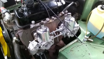

I should have posted this a week-and-a-bit ago, but I was short on time and then the server for this forum went down! A week last Saturday (or Sunday, I forget) I nailed the carburettors back onto the side of the engine. Unfortunately progress then came to a halt again, mainly because I found myself short of a few parts once again. I seem to be responsible for the main one - I can't find the choke cable trunnion. The tiny bit that clamps the cable. I believed I'd removed it when taking the carbs off for a rebuild and probably have, but while all my nuts and washers and everything else related to stripping the carbs off was safe and easily found, the choke cable trunnion has gone walkies. But seeing as I couldn't see the trunnion or where it fitted in any photos I took of the old carbs on removal, I started to doubt I WAS responsible at first because yet again, I've discovered some bits I got back from Andrew Turner are probably not my originals. The re-plated linkage bars came with the centre throttle cable return spring already hooked around the pin of the cable clamp, behind the split cotter pin and plain washer. But looking at the assembly diagram in my manual, and THEN my old photos, I found the spring should be hooked through a metal tag that dangles from the pin, not the pin itself, and also there should be a curved washer of some sort behind the cotter pin and plain washer. Not there....but present in my old photos of the assembled carburettors. And since it is apparent that much of the re-plating has been done with everything in situ, i.e. unscrew a nut and the metal underneath is rusty, then if these linkages were not dismantled, THEY ARE NOT MINE. Trivial, minor details perhaps, but more evidence that 'my' rebuilt carburettors were just an assembly of parts he happened to have. This is NOT the service he offered me. While it remains to be seen if the rebuilt carbs are up to a serviceable standard, and right now I assume they will be, if I have any need in the future of an S.U. carburettor rebuild service, I will be looking for someone else. Also I noticed my choke lever stop screws were slightly bent. Removing these for a better look also confirmed they'd been plated in situ, along with the butterfly operating levers and cams, because their threads had rust where they were screwed in. I managed to straighten the screws up a bit. I swear my old screws were not bent when I was originally playing with the carbs trying unsuccessfully to tune them, before they went away. Again - potentially these are parts from another car, not mine. All the cheese head screws on the carbs looked like used screws with slightly burred slots that have been re-plated, which my friend Dennis of the classic motor bikes said would annoy him. Also no spring washers were used anywhere and also the carb ID tags, usually fixed to the float chamber lids, which were present when sent away, aren't there any more. Well, what's the point? These carburettors are just an assembly of bits, not original carbs! It's a good job I'm not trying to re-create a concours example because I'd be completely stuffed trying to make my car look like a factory example under the bonnet if I wanted to retain the original details.
The better news is that after an unsuccessful attempt to get the cable attachment parts from an eBay seller who I bought some S.U. manifold gaskets off (as I was two short from Andrew Turner) I found them on the Mini Spares website, so that's where I've ordered them from. I know Minis only had A Series engines but some had HS4 carburettors and in any case, little parts like I need are often common to other cars, but I find the Mini Spares website in particular, and some other Mini websites much easier to navigate and identify parts on, than the likes of Rimmer Brothers or Moss.

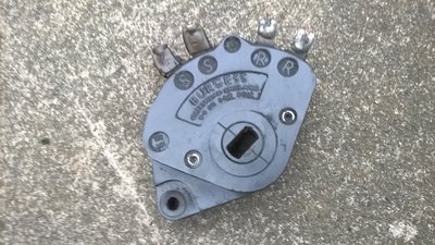

While sorting through some of my spares that came with the car, I cleaned the muck off the old inhibitor switch that came in an old Lucas box along with an old fuel filter. Presumably it is scrap anyway, but wires were never meant to be soldered to the spade connectors, were they?

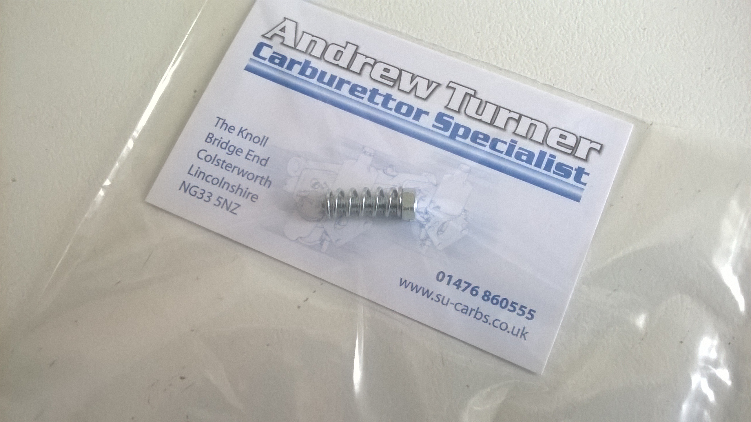

It's okay about the choke connection parts, the ones I ordered should be on the way. Thanks for the offer though. I did consider posting about that little problem here to see if anybody could help, but then after trying another S.U. 'expert' on eBay and coming up with nothing from Burlen's website, I remembered my bookmarked Mini parts suppliers and there they were.
