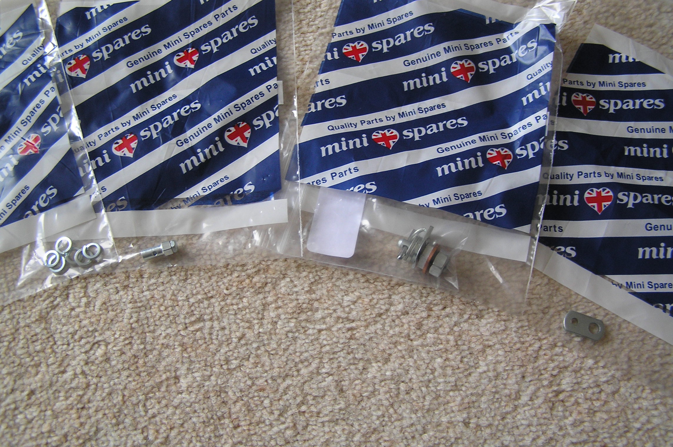

As a Apprentice one, of the first thing I was taught was when removing the cable barrel, was to screw it back on to the cable when removed. So they never went walkies, something I still do today.
- Posts: 1457
Very good point Dave! I could make the excuse that my old cable was scrap and I only kept it for making measurements trying to obtain a new one, but that's something to bear in mind for the future
- Posts: 1457
Thank you Mini Spares
