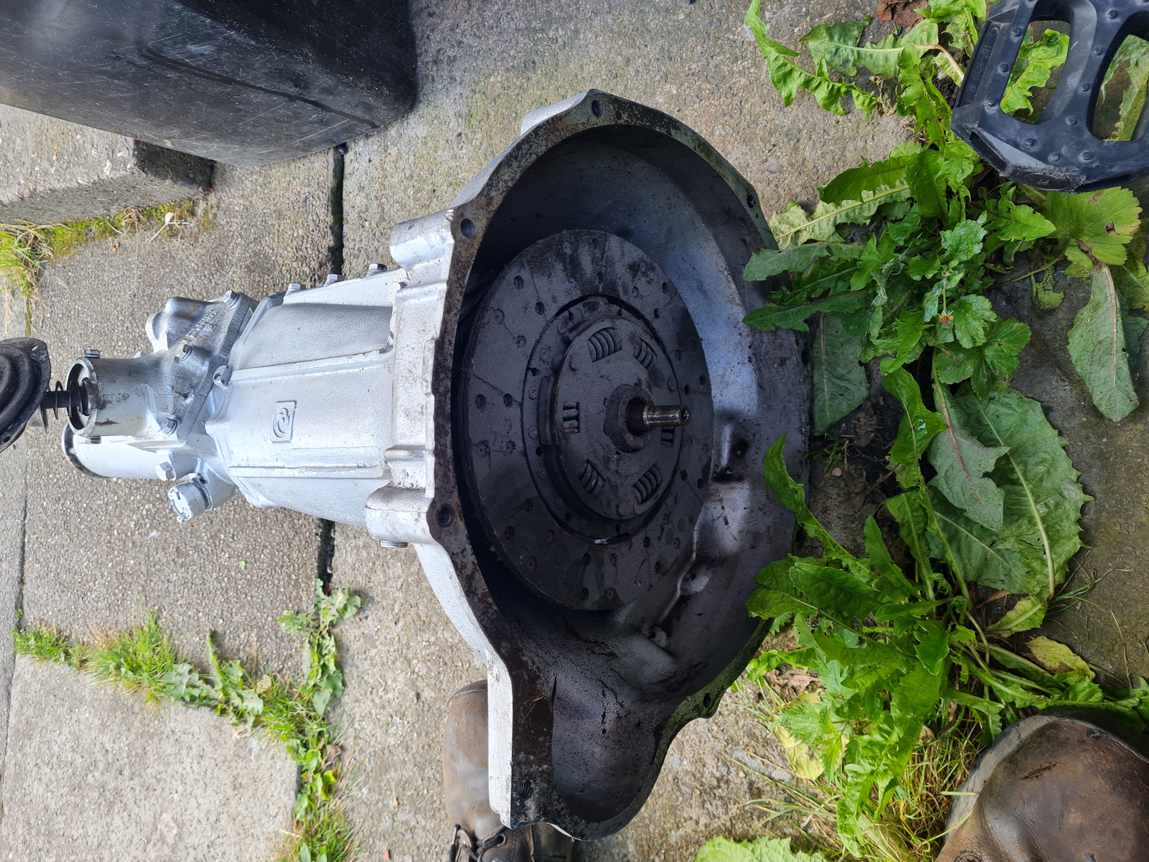

Is the sherpa gearbox a non O/D version on the MGB one? What are the ratios like in comparison?

Yeah its a very late version of the gearbix with different clutch splines than the A60/MGB unit, it will have an awful first and second gear no doubt so will be more a 3 speed, the bw bellhousing could be useful but I think that would likely emulate the A/B series marina pattern,,still I'd wonder if the torque converter on this would slot onto a rwd type 35 splines maybe!

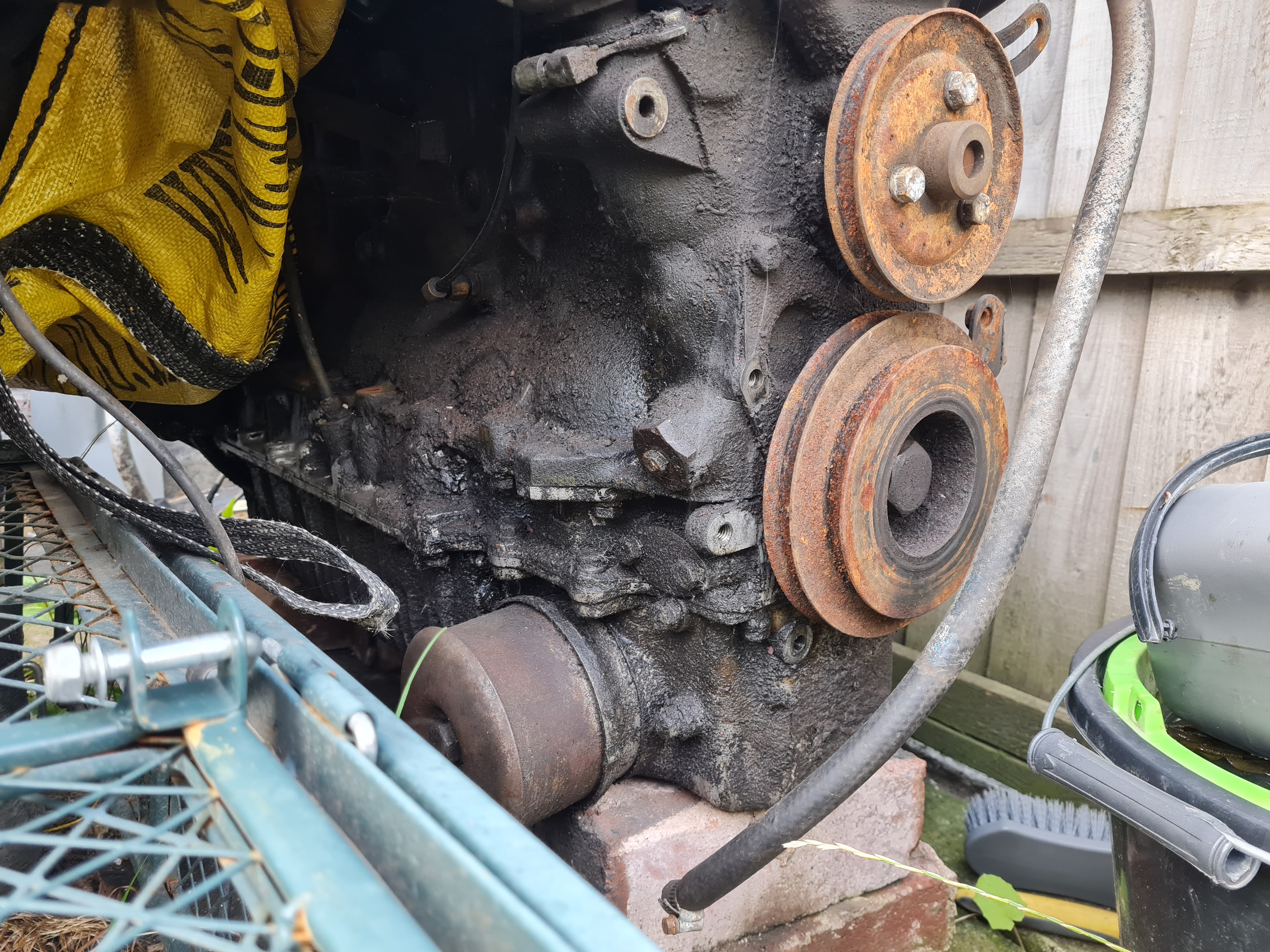

The E has a torque converter that might work with a type 35 as it drives a short shaft with a morse chain down the side,,it also is piped to recieve oil in circulation which seems to me to be quite an engineering challenge given this gearbox only went into the landcrab and later princess! But for now I'll investigate the manual gearbox and see what is the least invasive way to adapt them together but thanks for the heads up on the bellhousing, parts like that are very handy often at random.

Once I unbolt the engine off the autobox, I'll measure and count the shaft splines and seal sizes, it might actually be a generic type 35 converter possibly

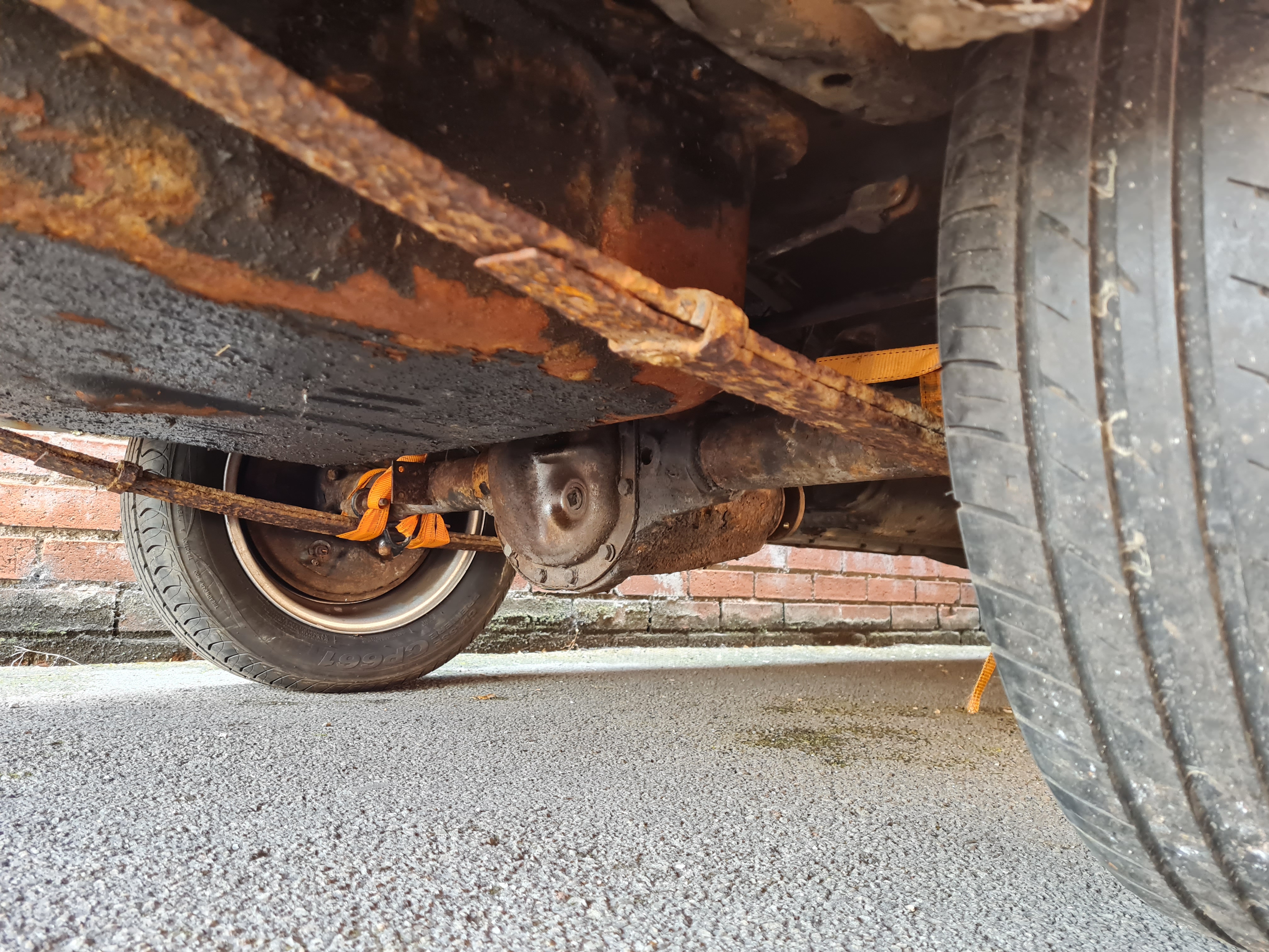

Just went up this morning to stick the axle, hubs and wheels on,,could barely lift the axle at all,,not strong enough for this atm.
Still with some egyptology it got sorted.
Looking worse for wear but it's a good base to work with really, will try to straighten and save the front as best I can as I imagine front panels are difficult to find eh
