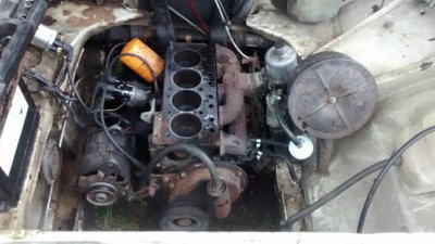

Well , I have done about 150 miles in boppy and she has behaved quite well , its always run really hot and constant flushing hasn't sorted it , so the engine is I'm bits and nearly all water ways were blocked! So I've cleaned it all out , used a bendy metal rod to get around all the awkward bits , just waiting for the head gasket set to come to put it back together !
