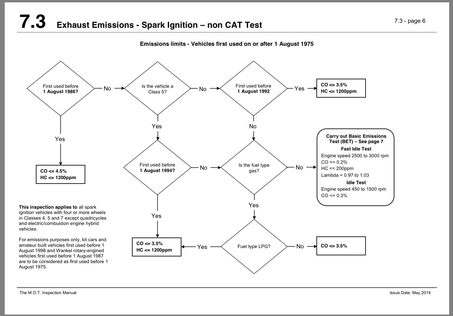

Morris McKinnon wrote:1st August 1979 onward is when cars have to be emissions tested. Before this date it's visual only.
August 1975 and before is visual only.
Posts: 10270
Post by MarinaCoupe » Fri Jun 23, 2017 9:02 pm
Sorry guys,
Visual test only if before 1st August 1975.
01.08.1975 to 01.08.1986 is CO not greater than 4.5% and HC not greater than 1200 ppm.
Here is an extract from the MOT inspectors rule book
Here is the full 'Bible'
https://www.gov.uk/government/uploads/s ... -and-7.pdf
Post by Morris McKinnon » Fri Jun 23, 2017 9:29 pm
oh. Has the date changed recently? I was always told it was 1979, even read it in Practical classics once.. though I haven't bought that mag for about ten years now.
Post by balmy » Fri Jun 23, 2017 9:53 pm
Morris McKinnon wrote:oh. Has the date changed recently? I was always told it was 1979, even read it in Practical classics once.. though I haven't bought that mag for about ten years now.
Hasn't changed as far as I know and certainly not for a long time.
I find MOT testers never know whether to test or not. I've had it both ways-trying to test a pre '75 car and not testing a post '75 car!
Post by mickthefitter » Fri Jun 23, 2017 10:03 pm
My MoT tester is 60 so he's been around for a while! He used to banger race cars like ours (well he said he used to banger race Triumph 2000s when I had one and took it to him) but he gets quite a few classics through his doors. I'm not sure what I'll do when he retires.
Post by david painter » Fri Jun 23, 2017 10:07 pm
Has never changed since Emissions testing introduced back in the early 90's. Should never be tested on wrong dates. The dates for different tests are selected to the Gas Bench Computer with reg letters on first screen before car details are entered.
Post by Morris McKinnon » Fri Jun 23, 2017 10:19 pm
Well, bloody hell! I always thought it 1st August 1979 :rolls: I'll have to dig that mag out that says it was 1979 because it refers to a 1979 Vauxhall chevette. I remember it clearly because I had 79 mk2 Escort estate at the time which didn't get emissions tested the first year I bought it but did the year after and failed! It never ran right after that and swapped it for a mk2 Escort 1.6 Ghia... which was a W reg and never got emissions tested ever in the four years I owned it.
