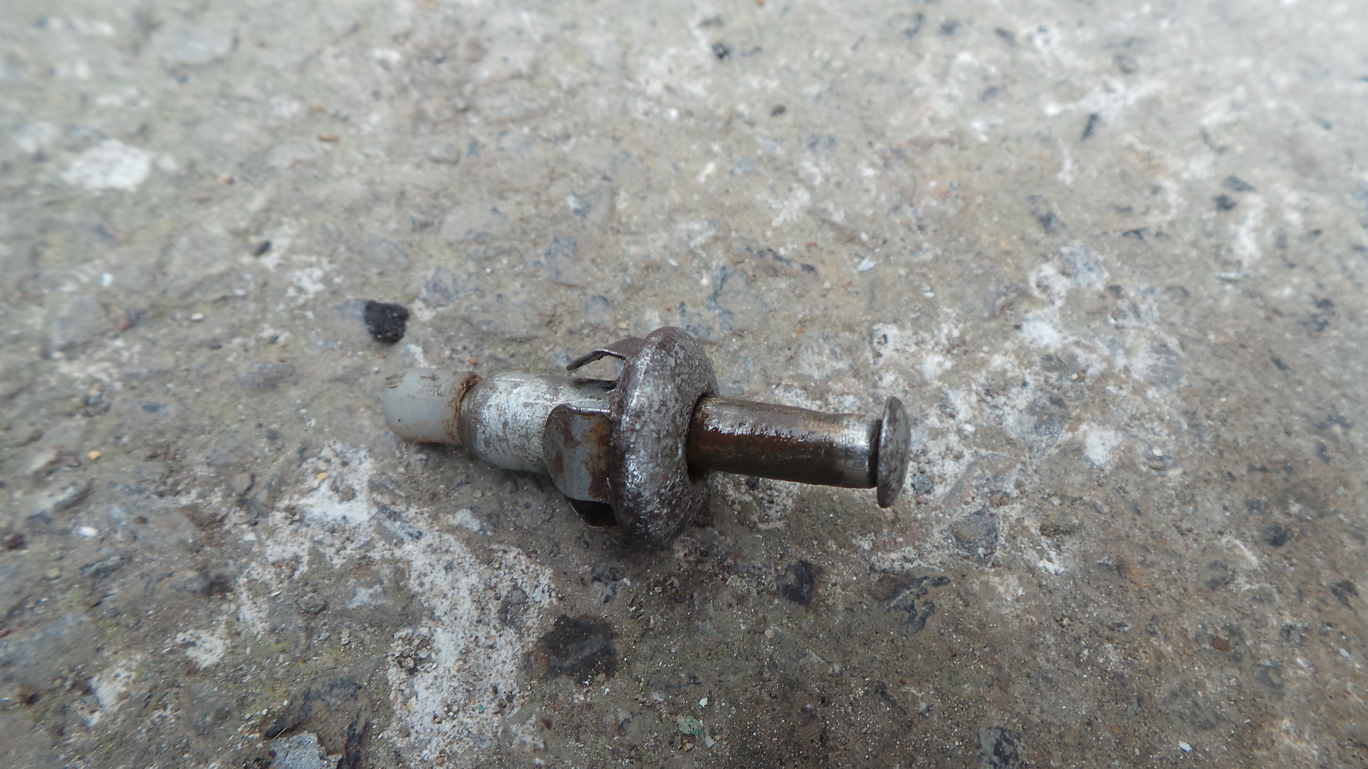

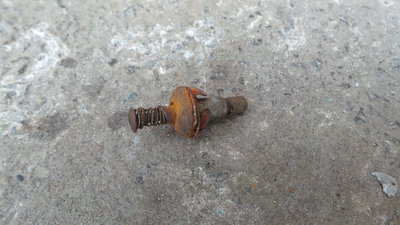

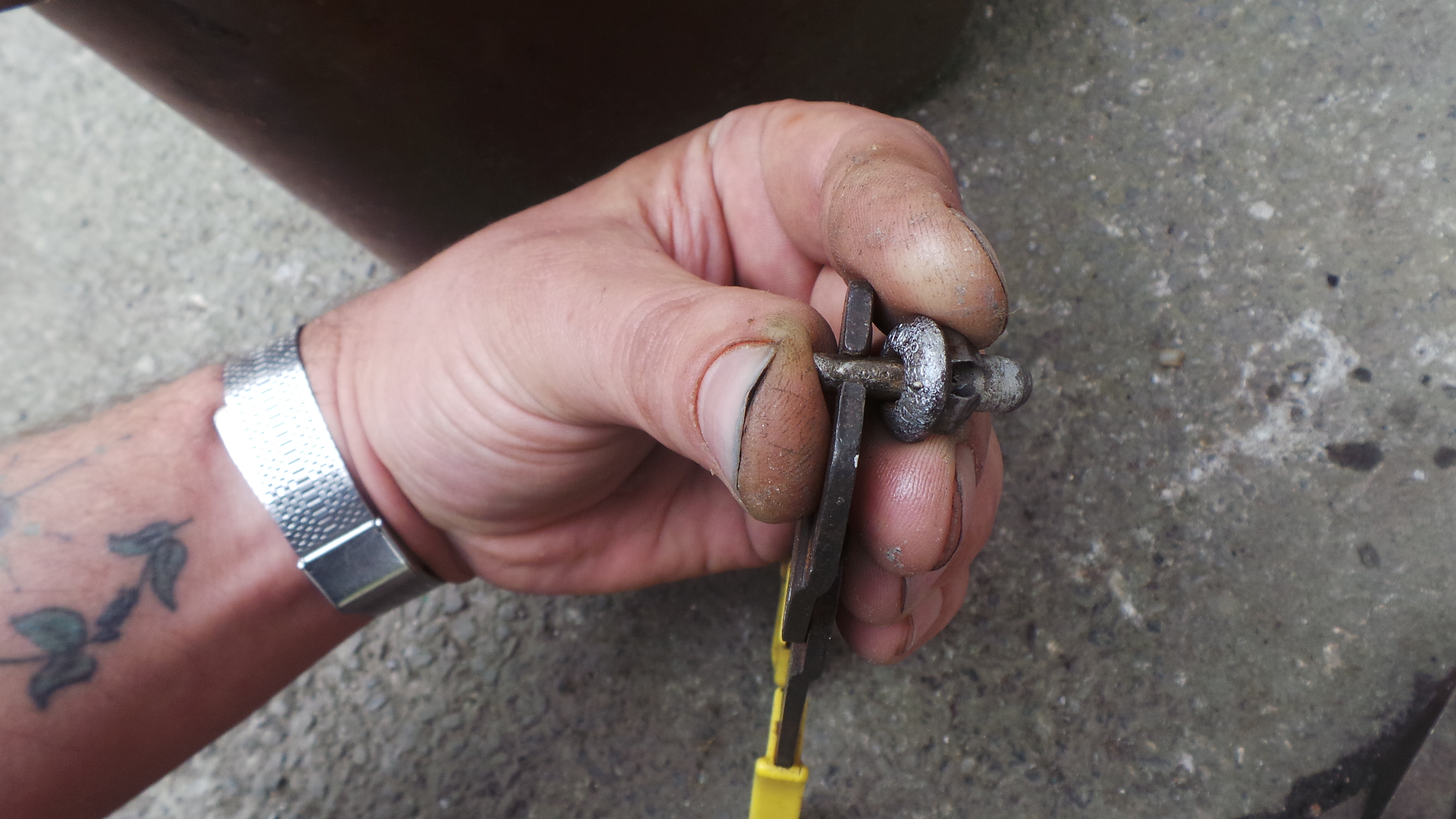

I needed to sort out the courtesy light switches on PTH so popped on to ebay to see if I could find some new ones. Their the same as the early Mini but have you seen the price on them! New ones were out of the question so I had a good look at the ones I had to see if they were salvageable. The pins were stuck in so I soaked them in WD40. I didn't hold much hope for the springs inside so I pulled the nylon cap off of the end and withdrew the pin and surprisingly the spring inside was fine but the passenger side had rusted fast. There is a sleeve that fits into the button which the spring presses against and it was that which was causing it to stick. I had to destroy the sleeve to get it and the rotten spring out. I used a pop rivet end to replace the sleeve and a spring from an old parker pen ;)
All cleaned up and put back together and now work perfectly :thumbup: probably the only car I've ever owned where the courtesy lights actually work as they should! :lol:
I've included some pics of how they come apart..

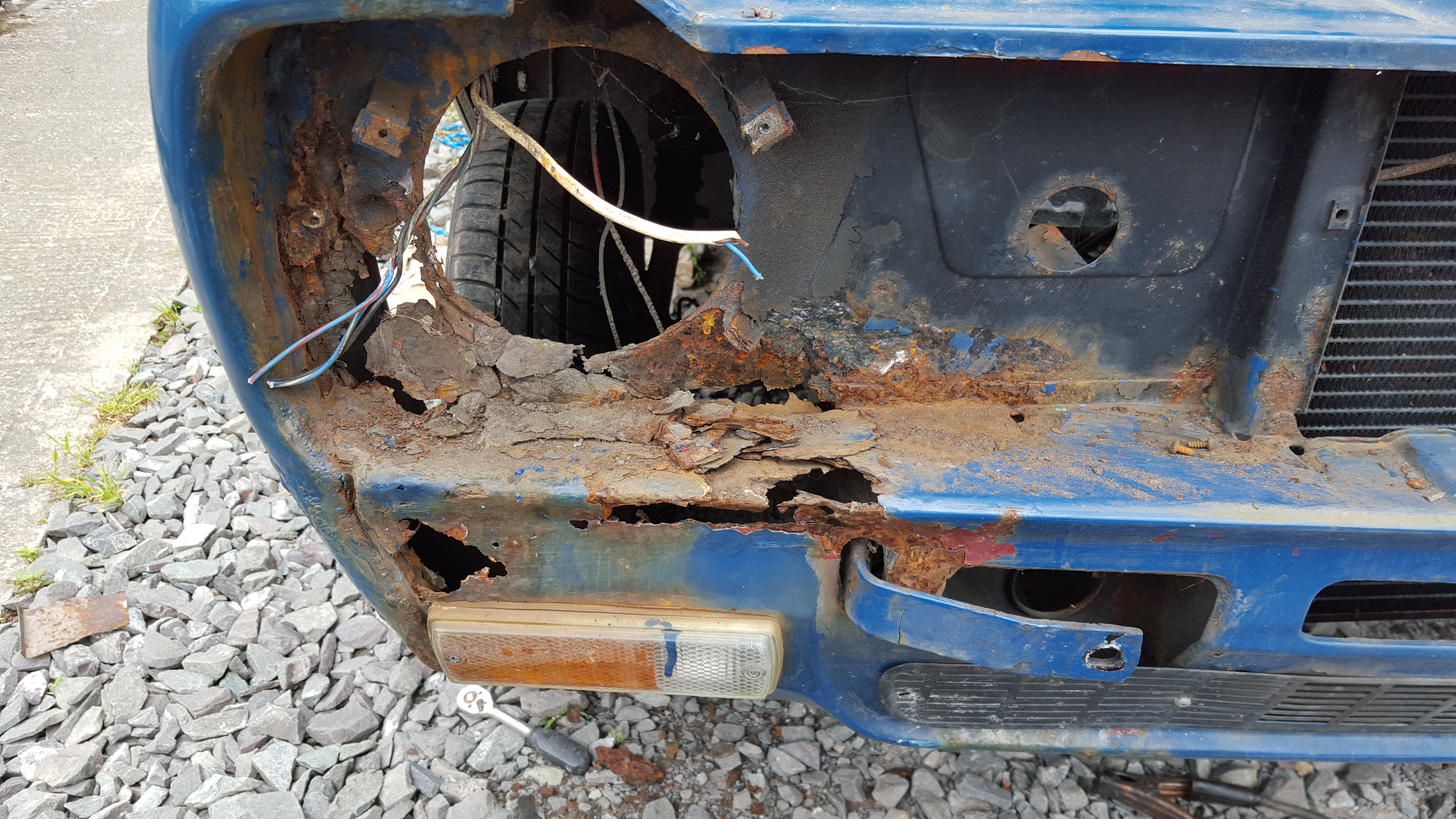

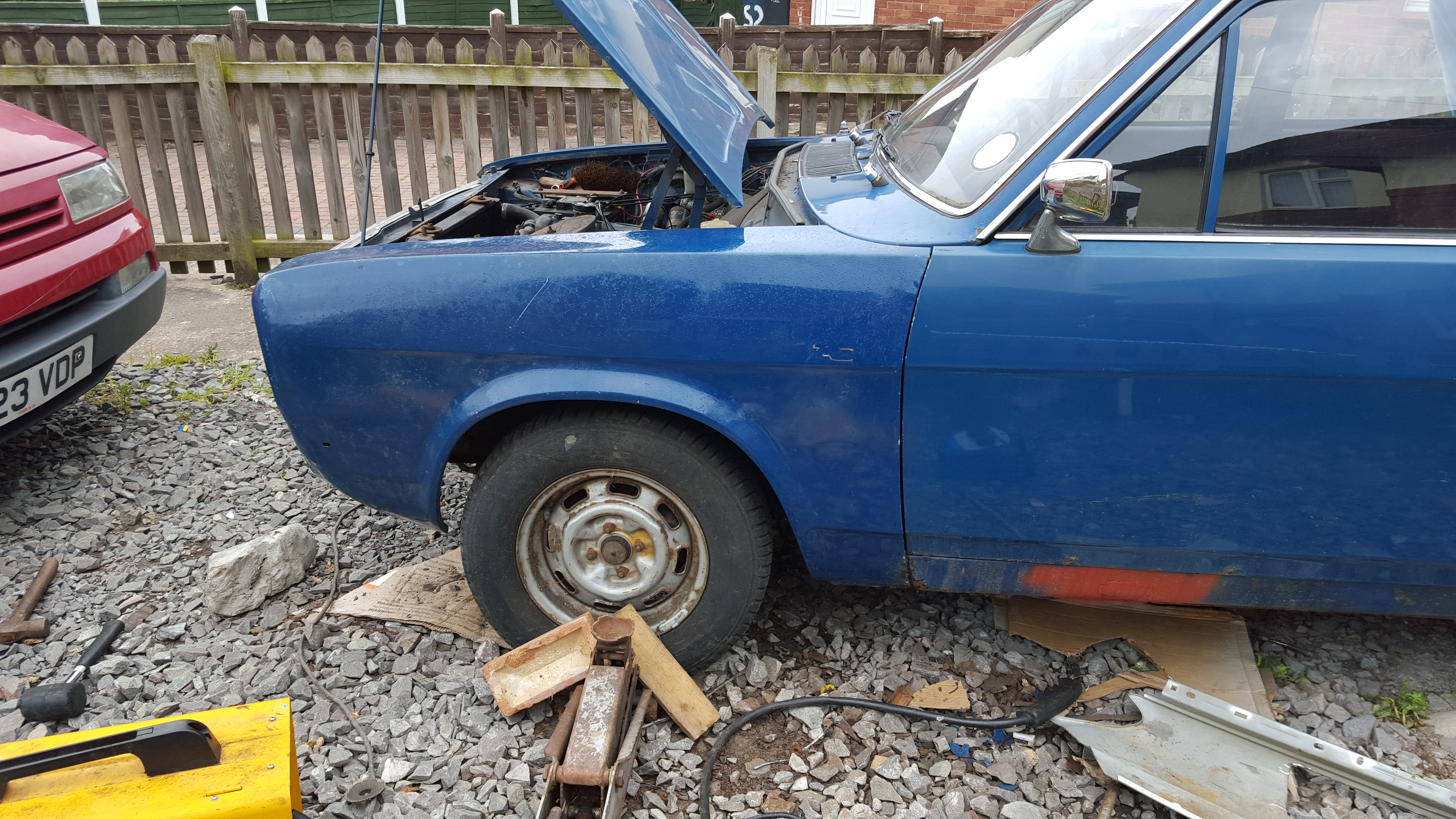

Fitted a new wing today, then removed grill to find bad rust behind the headlight!!!
Ahhhhhh
Ahhhhhh
New wing
New wing
Post by MarinaCoupe » Fri May 20, 2016 5:07 pm
Yup, if the wing is shot then the headlamp panel usually is.

Post by JubileeNut » Fri May 20, 2016 6:17 pm
I guess it was not a front wing you were fitting as when fitting it you would have to remove the grill to do so! Or do you mean before you fitted the wing you decovered the rot around the headlamp? :eh:
Post by MarinaCoupe » Fri May 20, 2016 6:20 pm
The inner wing that separates the wheel arch from the engine compartment, is closer in towards the centre line, so the Marina headlamp backs open onto the wheel and collect mud and crap. The later Ital had different inner wings that run behind the headlight.
