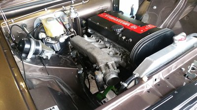

Lol I think anyone who owns a marina has boxes like this well I had productive day on the marina got the engine back in with box props haft all back up then started mocking up the inlet manifold as the original clashes with the back of the suspension arm mount and can't really knoch the back of the inlet as it will restrict the air flow so I've gone chopping up inlets to get it to look as much as possible factory fit
I've managed to mount the intercooler behind the grill to keep the front all original

Nice work

I'm picking up late on this. It looks very nice. A Marina-looking Ital pick up? Last week I saw a Marina TC looking Ital van with MGB engine and Capri 5 speed gear box. it was one man's re interpretation of the van he owned when he was 18. It wasn't exactly a camper but it has some nice stained wooden cabinets in the back as it was this man's trade!

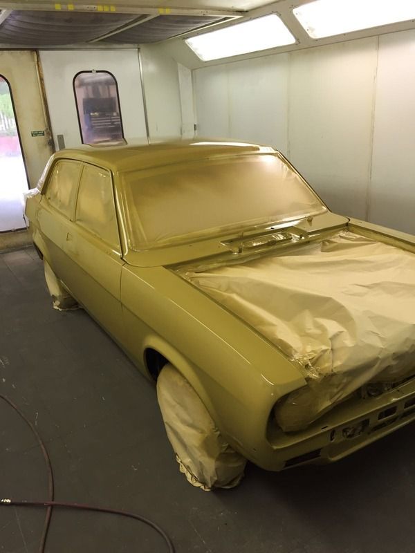

I've started putting all the bits back on this..,,
timspencer wrote:Image

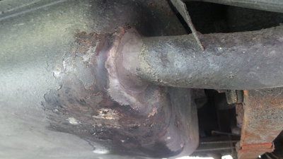

Finally put the parcel shelf back into PTH (been in the shed since the day I bought her!) also freshened up the interior. Front sidelights were already full of dirt so gave them a quick clean out too. As luck would have it I found the petrol tank leaking at the filler neck! I've replaced the tank on the other two here, now I need to it again to PTH! She has a later tank fitted so it's been replaced before at sometime.. can't even remember if it was me that replaced it :lol: It's not too bad and I think a temporary repair with araldite will be good enough for now.. it better be because sparks will be flying from the rear the amount of spares I'm bringing with me to the Nats! :lol:

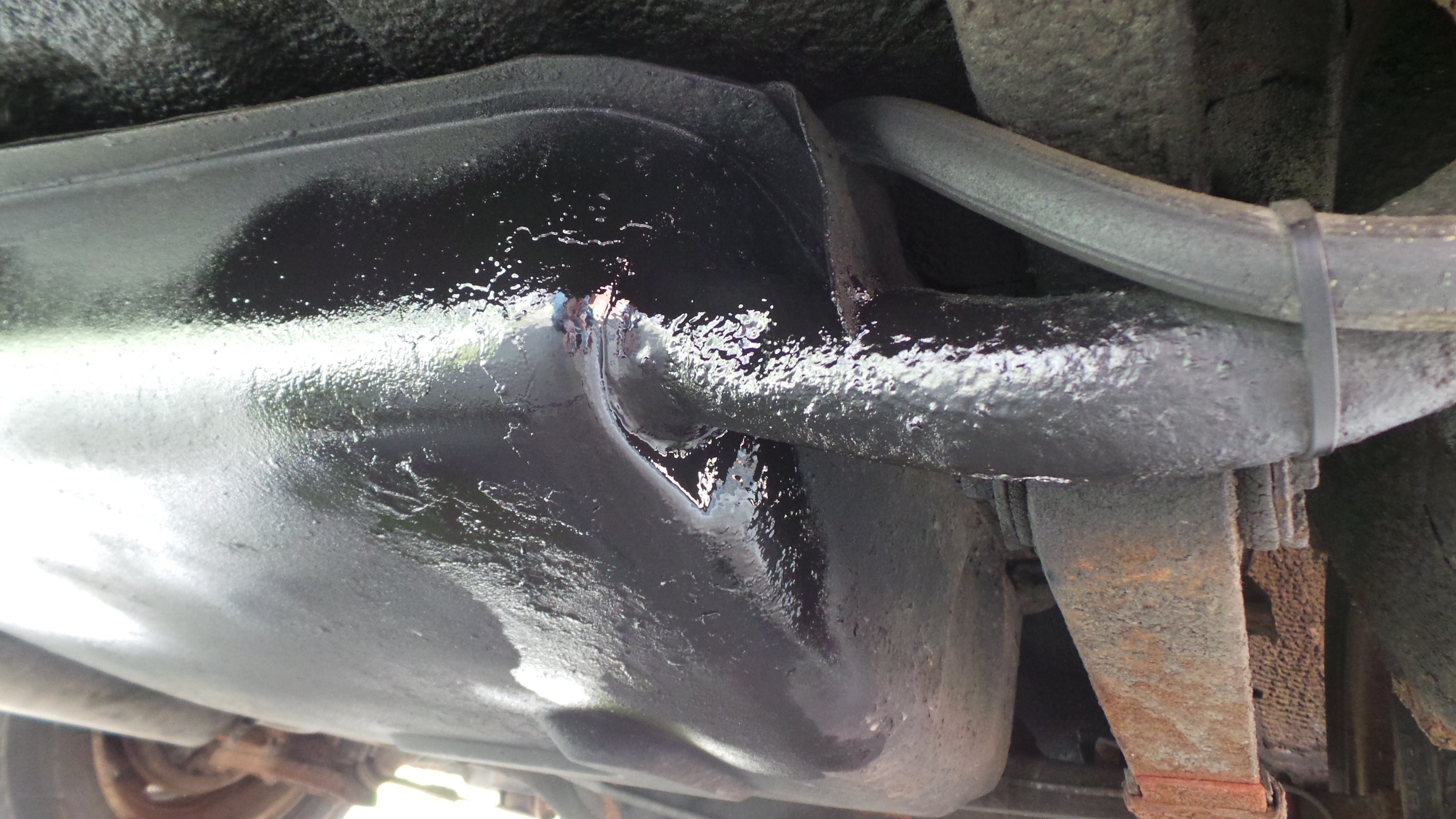

Got the leak fixed on PTH today but who knows haw long it'll last. Cleaned up the surrounding metal for the Araldite then covered with stone chip. Petrol tank fixes like this never last so I'm on the hunt Again for a replacement tank :rolls:
