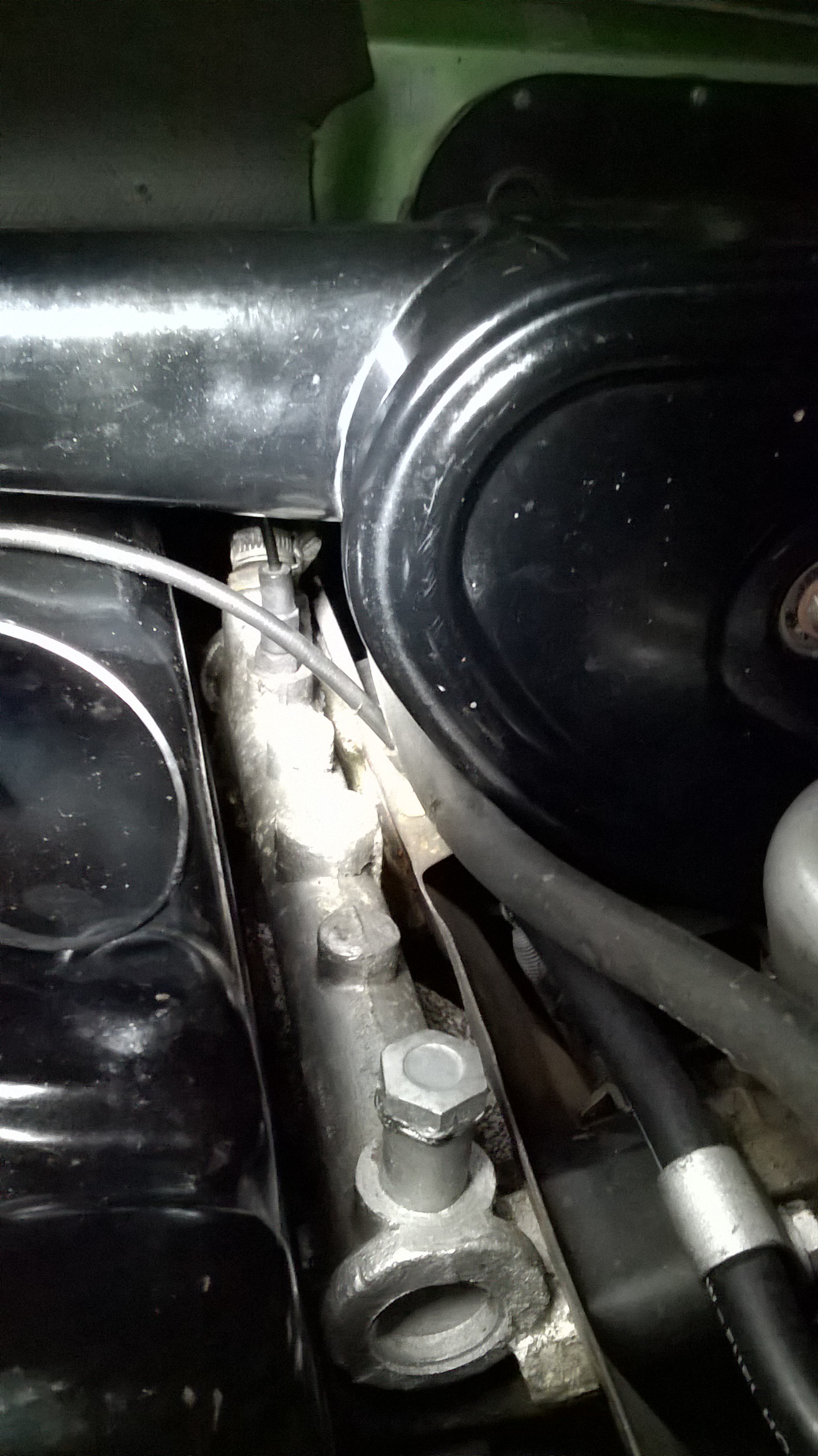

But there's more. Take a look at this old picture of my inlet manifold, taken when I was trying to tune the car last year.
Have a look at it now.
I've never has a 'TC'. Or an MG. So I don't know what the inlet manifold is supposed to look like. I thought the front bolt was threaded in. So did Glyn. But in setting up the carburettors he was getting signs of an inlet manifold air leak. He put a spanner on the front bolt and found it was just 'glued' in. And leaking. So while it doesn't look pretty, he's sealed the leak with a piece of rubber pipe, a bolt and jubilee clips. And this solved the carburettor tuning problem. Before he discovered the loose bolt he had the jets out, which is something I'd be scared to do for fear of doing something I didn't know how to get back right, but he said it is jetted correctly so at least I know the carburettors have been built correctly, although I realise it might not have been necessary to have them done in the first place. That was a gamble I was prepared to take over winter.

the pipe on the end of the manifold is for the anti run on valve pipe which they fitted to mk2 HL and GT models for some reason its been taken off.

IVOR DENNEY wrote: Fri Jun 30, 2017 7:38 pm the pipe on the end of the manifold is for the anti run on valve pipe which they fitted to mk2 HL and GT models for some reason its been taken off.
Chris said the other day, when I was reading the 'Mystery engine' thread, that my car should have an anti run-on valve. I'd not seen it, now I know why!
