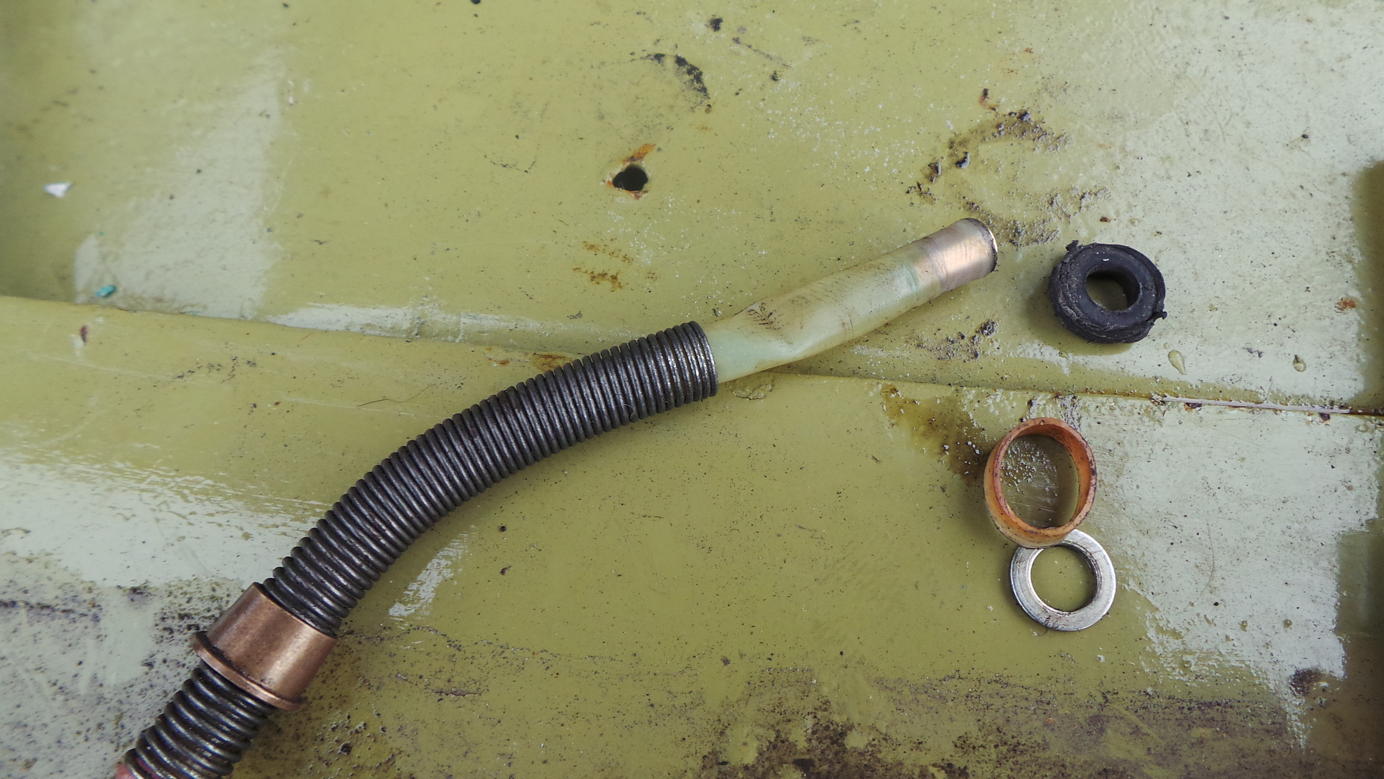

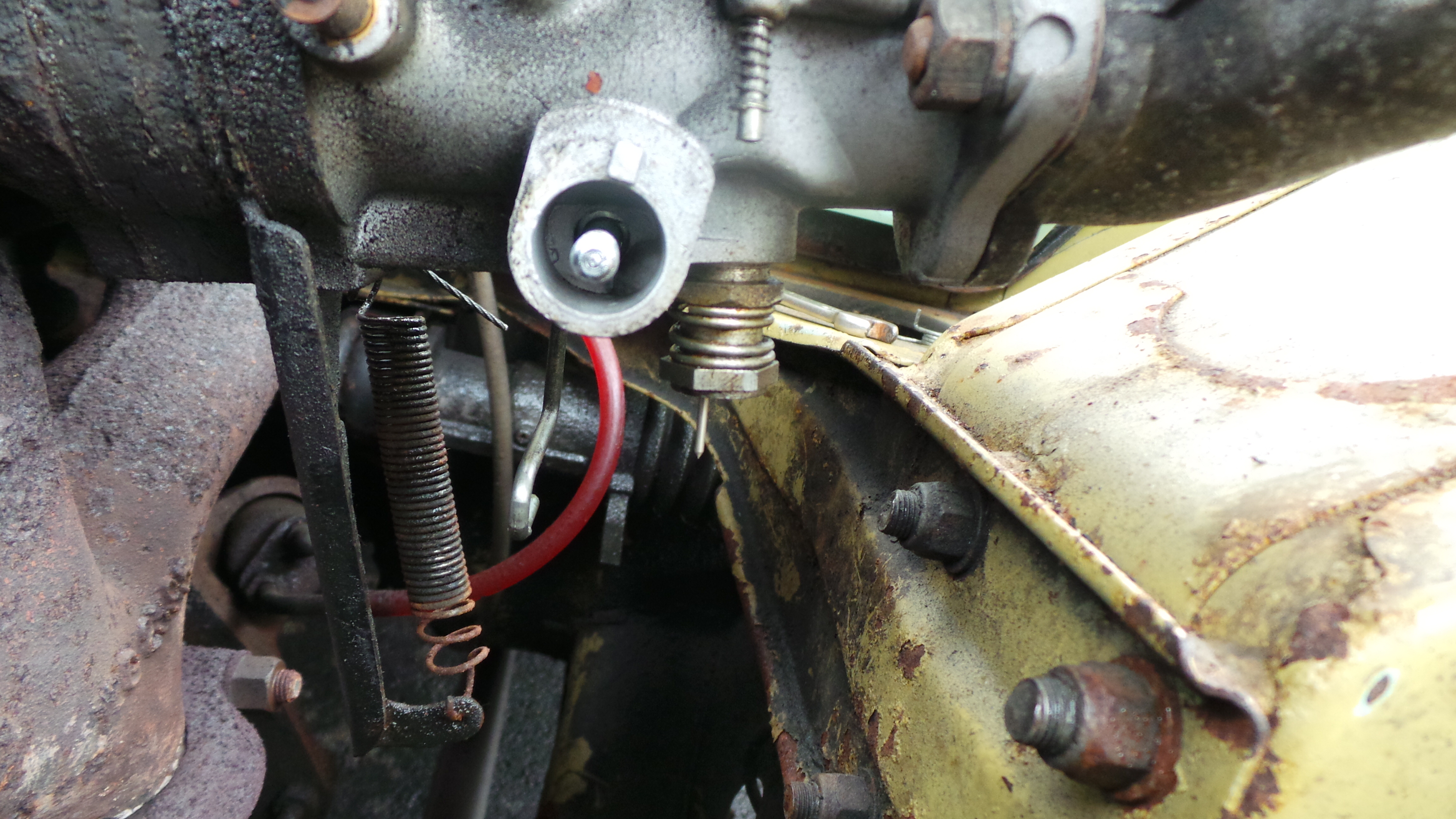

Battery went flat on PTH the other week (dynamo
) charged it and she run fine... for three seconds then died! No fuel getting to carb.
Checked the pump, pipes etc and found the pipe going from the reservoir to jet had a kink in it. Easy fix I thought as I had spares but as is sods law my spare jet was different! The hole where the rod for the choke fits is facing a different way so had to remove the pipe from that and fit it to the old jet. It's a tight fit and little bits went everywhere when I pulled on it! Eventually found the bits and gave the bowl a much needed clean too. It's back together now but the battery is dead again from earlier trying to figure out why she wouldn't start so hopefully all will be well in couple of hours.
What a morning
What a morning
