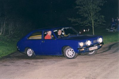

Not my car but came across this Night Rally Marina on Piston heads did a DVLA look up last taxed in 2008 so probably long gone

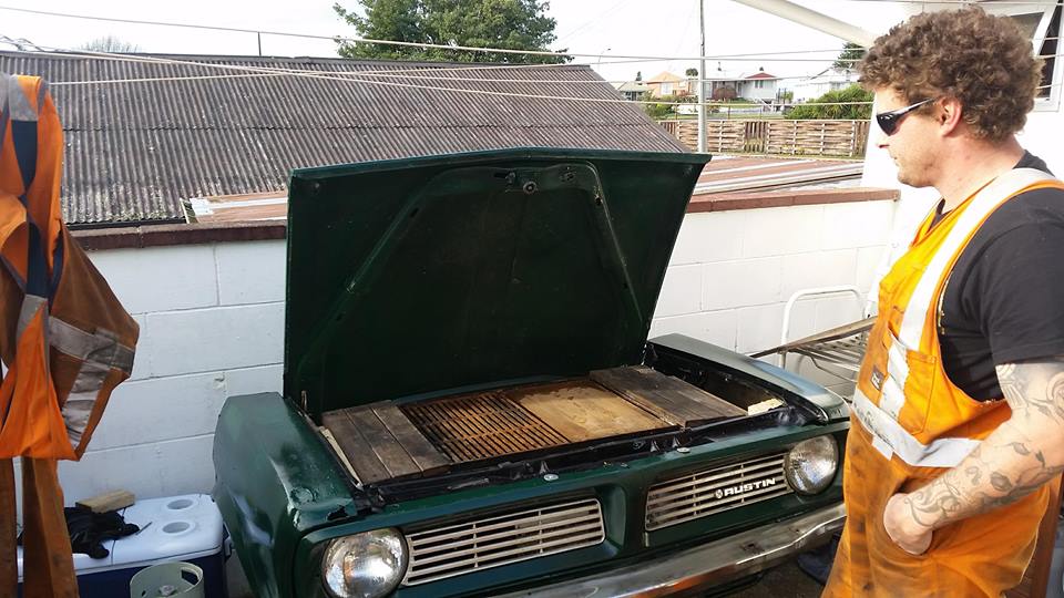

Made a car-b-que from my parts-ute (very rotten) hope y'all like your steaks marina-ted! easiest way to convert a marina to electronic ignition
next thing is to get solar lights inside the headlight buckets, and perhaps even clean the bbq..

Nice!doullama wrote: Mon Jun 25, 2018 9:43 am Made a car-b-que from my parts-ute (very rotten) hope y'all like your steaks marina-ted! easiest way to convert a marina to electronic ignitionnext thing is to get solar lights inside the headlight buckets, and perhaps even clean the bbq..
Needs a few of these accessories...
