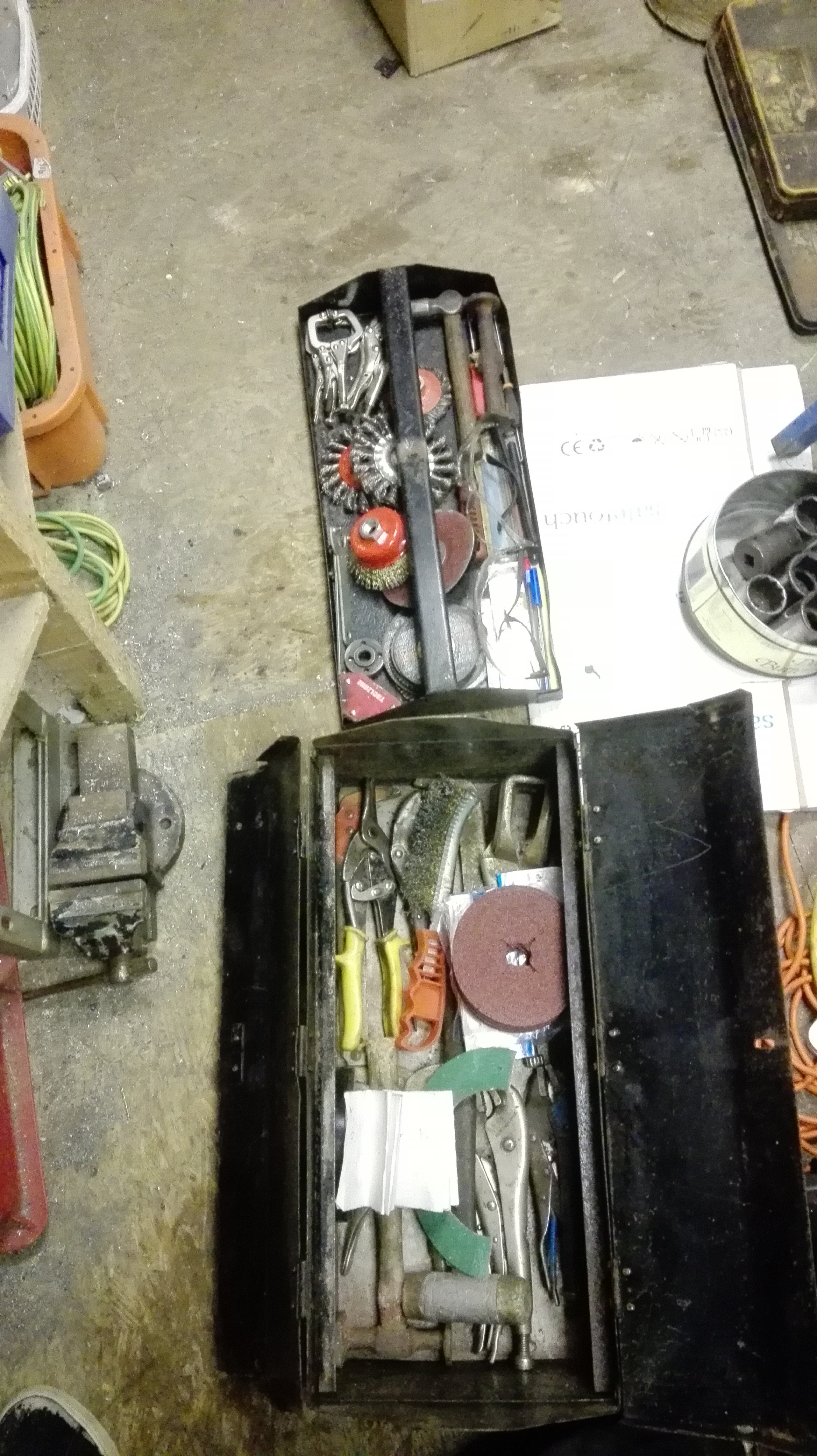

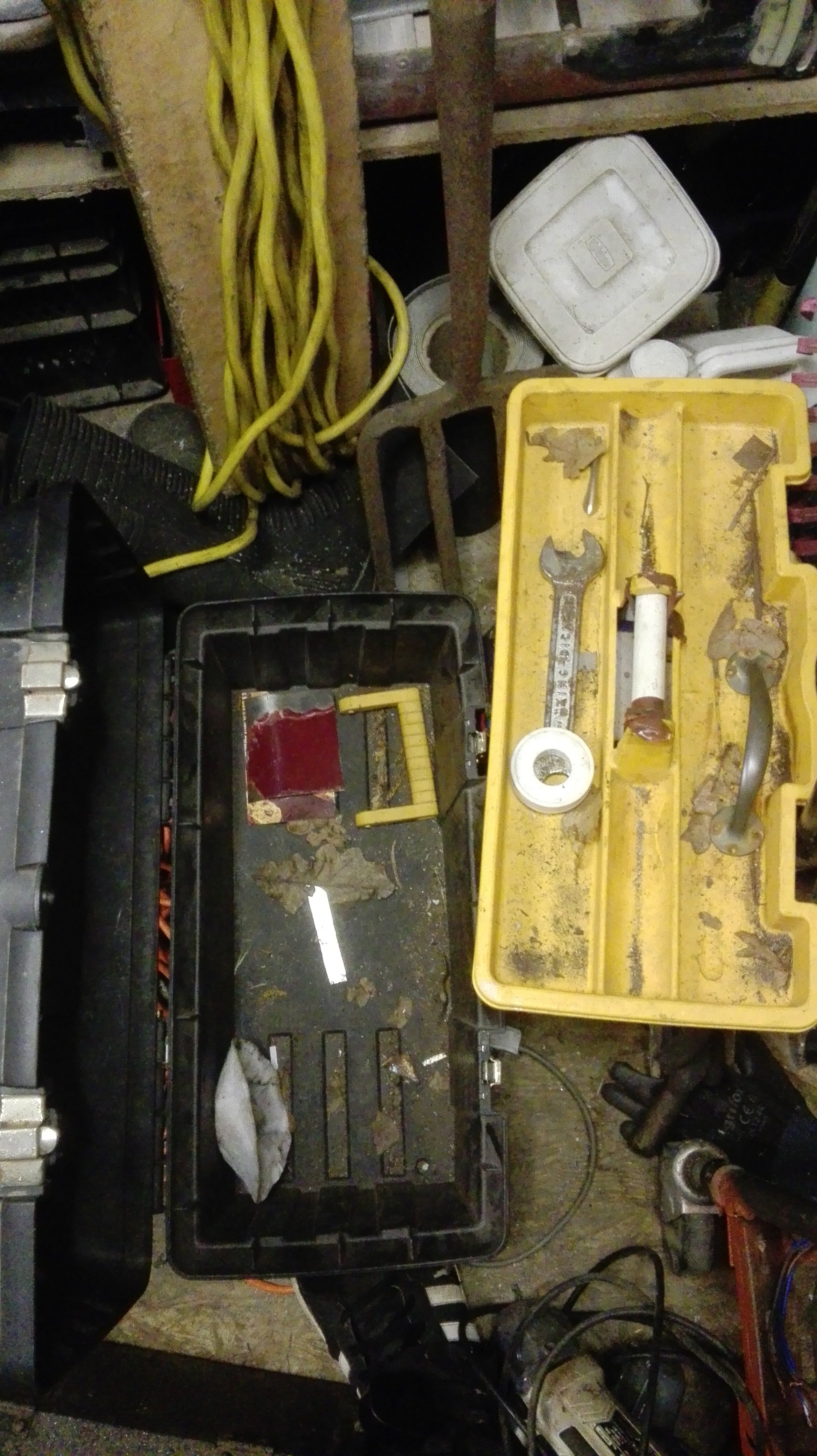

While welding the exhaust bracket on REW tonight, I decided it was time to upgrade the welding box ;). I bought a tool box of full of tools at a car show this year for £2.50 as the guys said they were fed up loading it up, not selling it and taking it home again. Got some pretty decent tools in there but was wondering what I could use the huge box for now the tools are in my tool boxes :think:. This was the answer :thumbup:
From this:
To this:
I like the old, solid metal toolboxes as they can take (and handle being metal rather than plastic) more tools which I'm sure I'll be buying in the future :shifty: :lol:

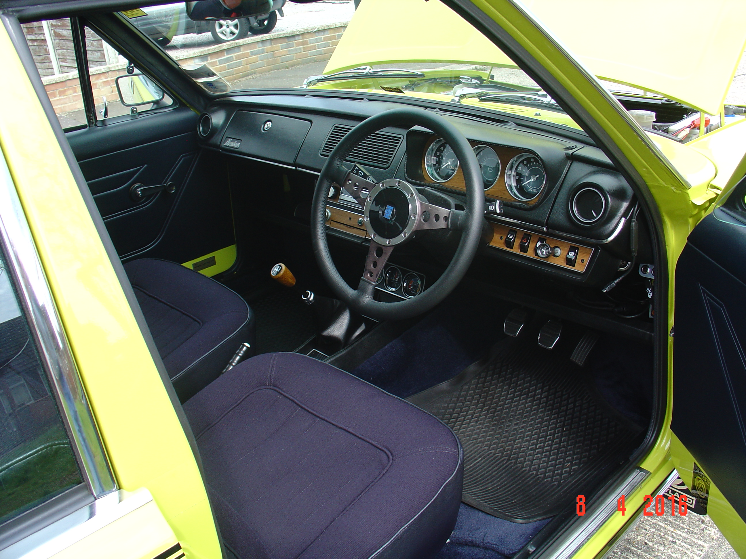

Fitted a 13» Moto-Lita wheel with Leyland ST spec together with new Superflex bushes on the damper arms. What a fabolous feeling:)
Posts: 5229
Post by JubileeNut » Fri Sep 14, 2018 8:16 pm
Nice wheel.
I have an ST wheel from 1973 had Motolita re-leather the wheel rim.
Had a name written on the rear of the wheel centre which turns out to be the original person who stitched the wheel in 1973!
My OCD is kicking in on your boss screws though :thumbup:

I will consider to line up the screws for you;) The boss is NOS in this case but the wheel is new. Got a written message from one of the employees at Moto-Lita in Norwegian with the shipment which was a cool surprise.
Posts: 5229
Post by JubileeNut » Sat Sep 15, 2018 8:49 pm
As you can see the black part of mine have faded with age and use but still a very good wheel.
