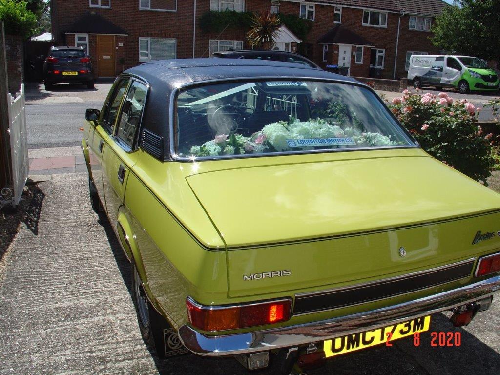

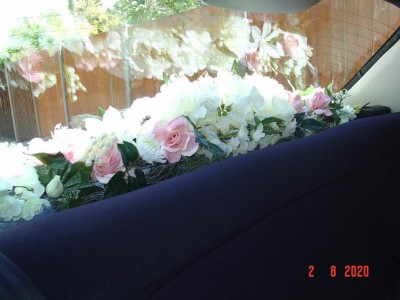

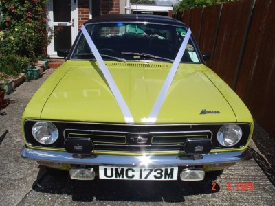

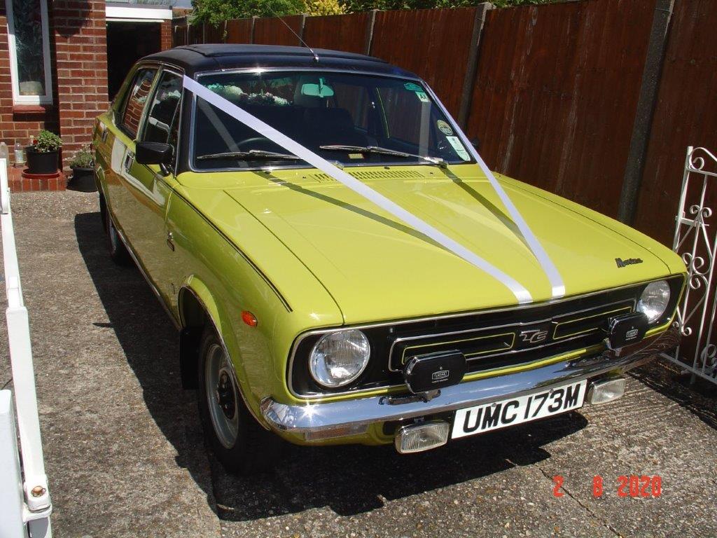

Been dressing up the Jubilee for my Niece's wedding next Saturday.
Hopefully we will still be OK to do most of the wedding but who knows what will change ?

Also check all the tuning and general items to make sure it runs perfectly.

Post by drinud » Sun Aug 02, 2020 8:05 pm
Covid or niece changing her mind? :lol:
Car looks awesome :clap:
Posts: 5239
Post by JubileeNut » Sun Aug 02, 2020 9:32 pm
Yep I did not make that clear :thumbup: and I hope my Niece will not change her mind!! But definitely uncertainty with Covid.
Thanks for the compliment. Just hope she likes it, it was her request but she has never been in it so that may change :o
Post by locost_bryan » Sun Aug 02, 2020 11:00 pm
At least the Marina has a roomy back seat, so she should have room for her frilly dress and train.
Jubilee looks great! :thumbup:
