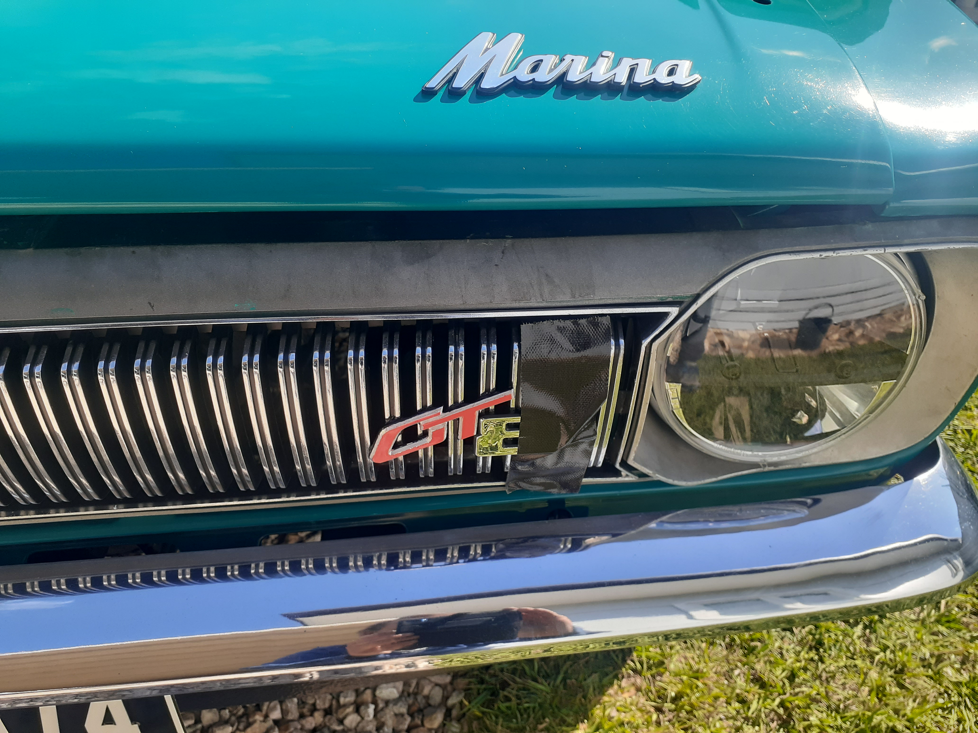

Finally got the Marina back on its wheels after 11 months on stands.Put new grille & badges on it & will be taking it to All British Car Show.First time in a car show with this car.
