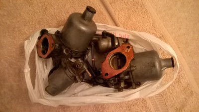

Well I'm sure you've all seen grubby carburettors before, but these were mine yesterday before they went away for a six week holiday near sunny Grantham.
Andrew Turner certainly appears to know his stuff. Much of his working areas appear a little chaotic but he's got lines of bead blasted carburettor bodies in rows on shelves, for all manner of BMC, BL and Jaguar cars. He had a preliminary look inside my carbs while I was there, and he was happy that they were in basically good nick, but picked up on the fact that the floats weren't the originals and pointed out to me that the jet flexible pipe on at least one of them wasn't original either - so this is where I need to know if the jets are the right ones, damaged or worn. Seeing as this car has ran so badly since I bought it, yet it is meant to be relatively unworn with its genuine low mileage, I feel as though I've got a task ahead of me worthy of Sherlock Holmes, detecting what's good, bad, and what' been altered.

My Precious......
- Posts: 10273
ohh! now they look the boss
Bet your glad to get those back.
- Posts: 1457
Yes today was six weeks to the day since I took them. I did phone up myself to check on them, and was told they were ready....maybe I would have got a call next week if I'd not checked, as he did have quite a lot of units waiting for collection when I turned up. They look the biz, I assume they aren't complicated devices if you know what you are doing (unlike writing software for a modern car) so lets hope they provide my benchmark from where to start returning my Marina to life. When I've traced the electrical problem, that is...
