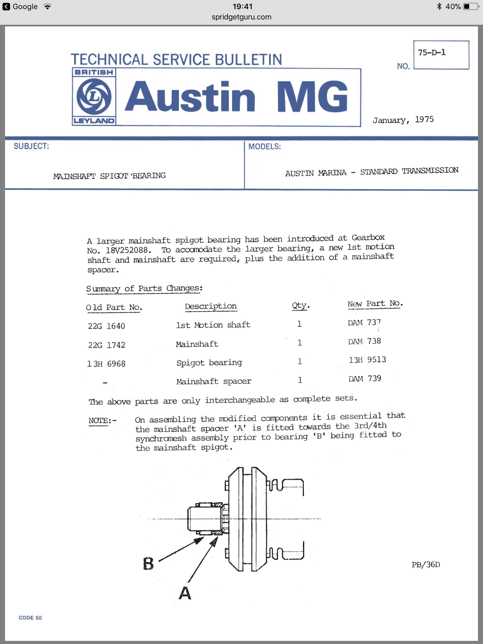

I have been doing some more research and turned this up on the net, dated 1975. It confirms the engine number for the change of bearing and the order of fitment of the earlier bearing and spacer. The spacer definitely is fitted onto the main shaft before the bearing.

The way I read the TSB its the early small diameter, but wide bearing did not have a spacer fitted. I would fit a new 13H6968 bearing and put it back together as it came apart. Having another close look at the photo what I thought initially looked to be wear. could well be assembly grease

True David, deffo need to buy a spacer and small caged bearing.

Thanks again both, David, that is correct the score marks are actually assembly grease that I applied, it is only a 40k box and it looks to have had quite an easy life. It looks to me like that is correct, the earlier caged bearing looks to have not had a spacer fitted, I have bought the caged bearing that Chris found for me so I'll fit that and assemble it again hopefully that will be the solution. I'm going to try and find some data on the earlier 1st motion shafts and see if I am correct that the earlier types are machined differently to the later types.
