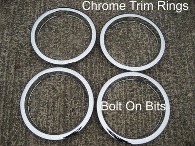

Mick there is a set of 13inc chrome trim rings on ebay listed for MG Midget I found them a while ago when deciding what to do on my MK3 Coupe just checked a set still listed item number 361290275036
- Posts: 1457
Yes thanks Dave, actually before I went to bed last night I was checking eBay on my phone and I think I put the same ones in my watch list. I also found some secondhand ones said to be from a Ford Fiesta, after Gareth said Mk2 Escort ones would fit (so I assumed these would be the same) but they might be a bit marked. I watched them but need to have a proper look at everything from my larger computer screen. Plenty of new plastic ones and even a few sets claimed to fit 1600Es, but I don't want plastic and 1600E ones look far too wide.david painter wrote: Fri Jun 22, 2018 7:30 am Mick there is a set of 13inc chrome trim rings on ebay listed for MG Midget I found them a while ago when deciding what to do on my MK3 Coupe just checked a set still listed item number 361290275036

If I remember, the Escort rings had those wide lips that almost touch the tire like in that pic, whereas the VW versions sat nice and flush to where the wheel weights clip on. Much neater but probably impossible to find now.
- Posts: 1726
Check on size of Fiesta ones some had 121 inch wheels from memory
Very early Fiesta (MK1) had small wheels.

I've been out most of the day till well past midnight so not looked on my computer but yes, I did think the Fiesta trims might look a bit funny, though they are advertised as 13". If they are pitted or damaged when I look on a bigger screen I will rule them out immediately.
