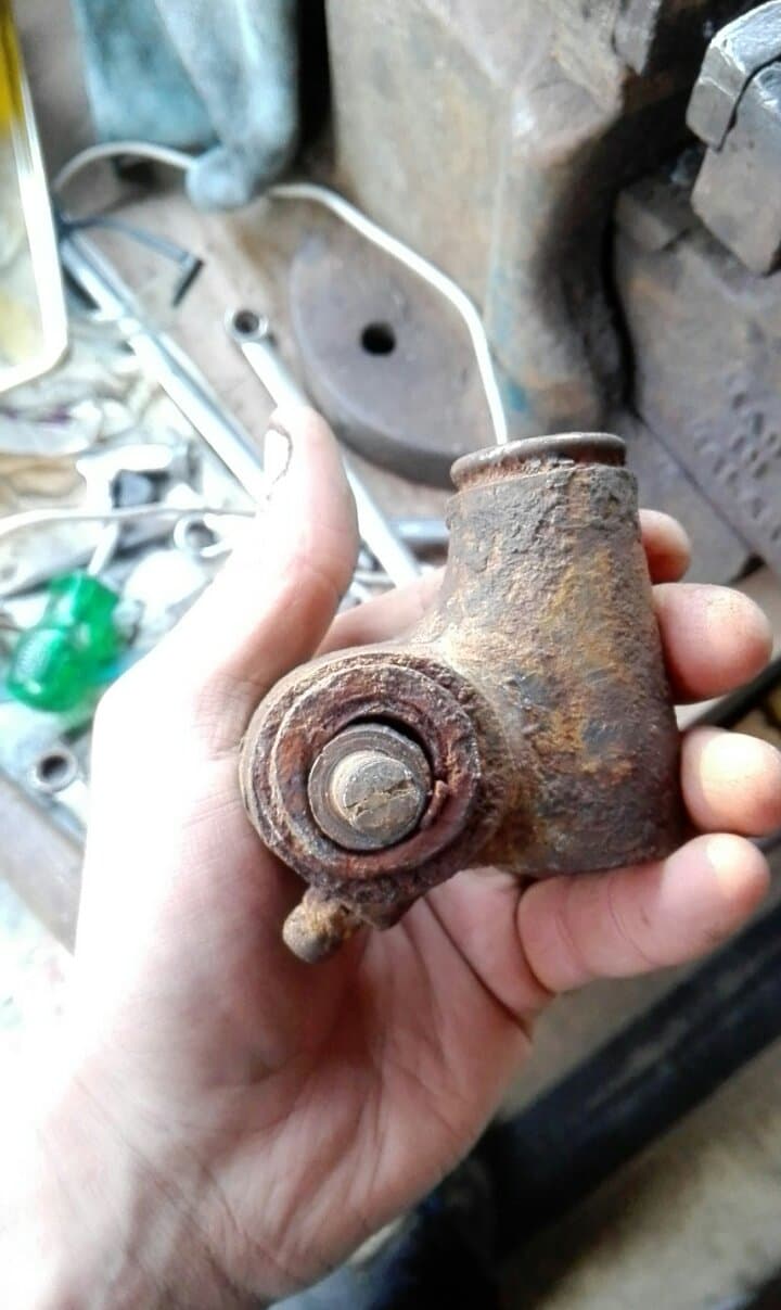

This was the state of one of the trunnions on REW and the pin was so seized that even some serious hits with a lump hammer wouldn't shift it :lol:.
I can't think of anything else to try apart from what's already been suggested, but it will probably be something straightforward, it always is :thumbup:. Unless something's been overtightened somewhere? :think:

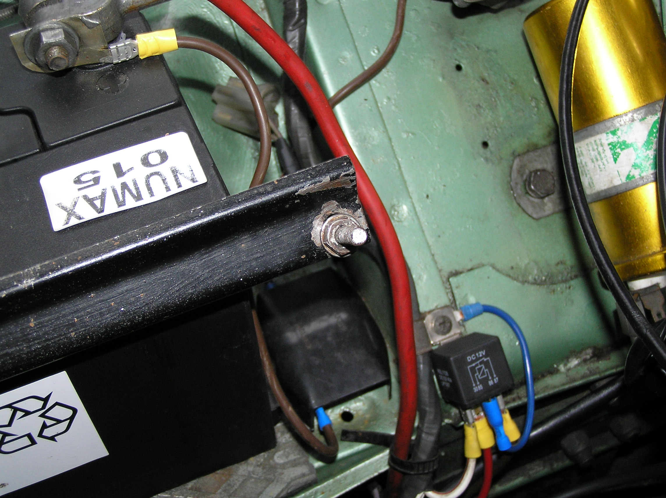

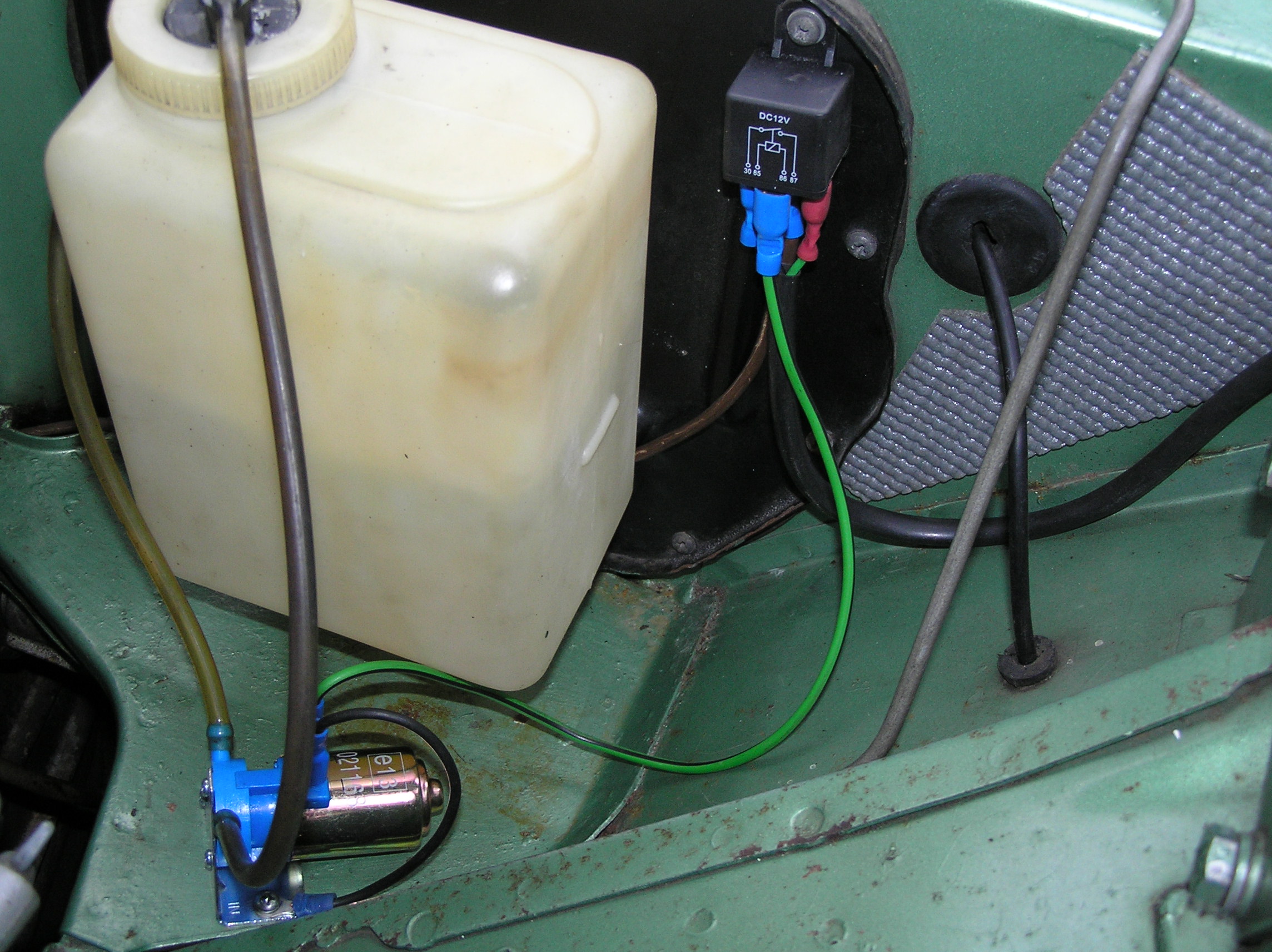

So earlier this year going through the car's systems I found the washer motor not working again. Volts at the wires, I took the motor off and checked it with a spare battery. Very intermittent. Again I stripped it to expose the impeller, found the motor worked without it, put it back together, tried it on the car (nothing), back to the spare battery, still intermittent. I played around for a while, then gave up, and ordered another new one from Somerford Mini. That one came branded Wipac, which I found reassuring. (The Mini Spares one was unbranded). Bolted on the car, the Wipac one worked. Then I left it till this afternoon and found it not working again. Which is very inconvenient with an MoT first thing in the morning.
Wipac motor on a spare battery, it spun freely. Wipac motor on the car, nothing. Except the motor got a bit warm. Multimeter on the spare battery, 12.5 volts. Multimeter on the car, ignition on and stalk pressed in, 11.5 volts. Could it be the voltage drop? Engine running, mutlimeter says 13.5 volts at the spade terminals for the washer motor. Engine running and motor fitted, nothing. It just gets warm. Why???
Electrics not being my subject, I could only suppose the VOLTS were there, but not enough current. I know current is power, but it's so long since my college days of electrical work I cannot remember why you can have 13.5 volts for a 12 volt motor and it still won't turn.

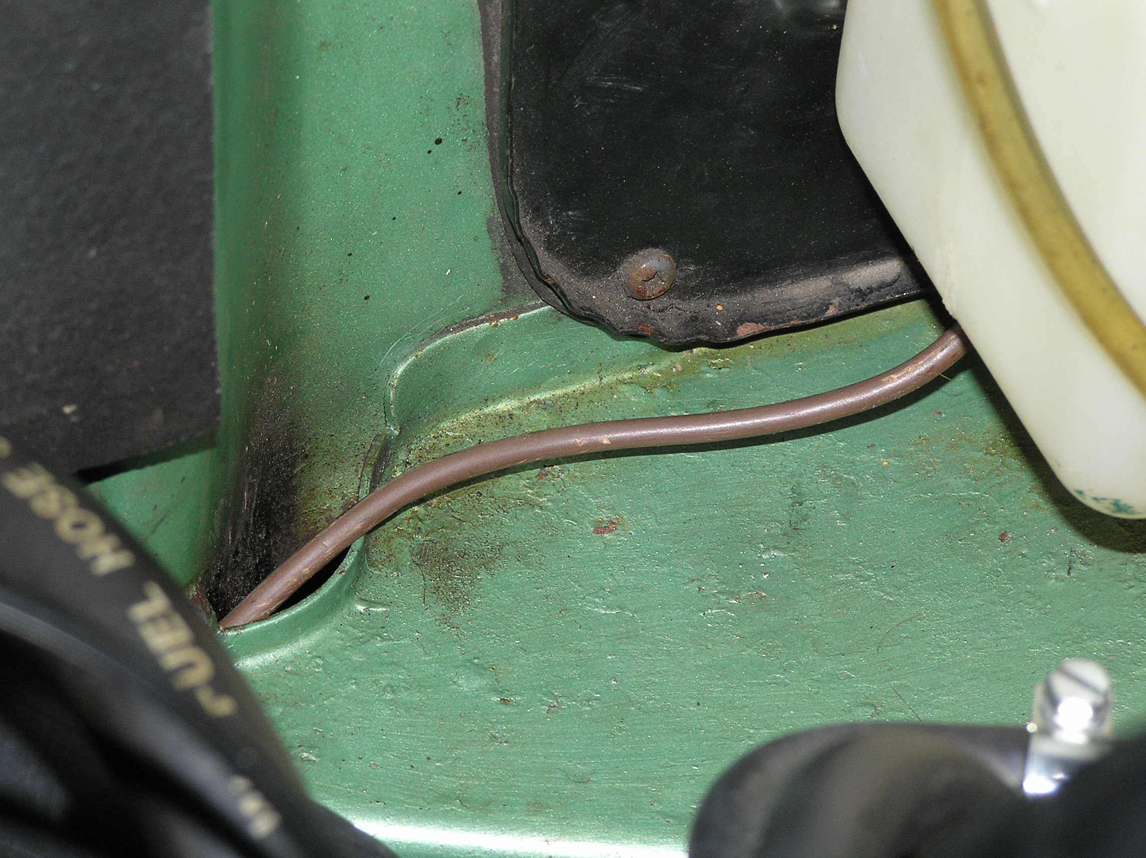

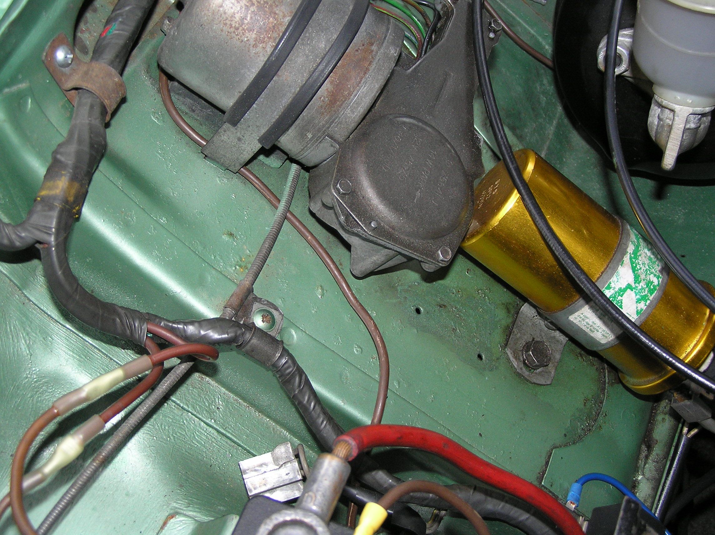

Anyway I had a spare 30amp relay from when I did Kilroy's modification to the starter motor circuit. That relay had been meant for the headlights but I never did the mod. Since I didn't have a wiring loom to figure out I sussed out this one myself. As expected the two wires meant to connect to the washer motor pulled in the relay's coil when the stalk button was pressed, and I took a wire from the battery, around the engine bay, across the bulkhead to the switched side of the relay, then another wire from the other switched terminal on the relay to the live terminal on the motor, and then a spade connector from the negative terminal on the motor to an earth point at its base. I've now got a powerful stream of water hitting the glass. Remembering Dave Painter's warning about my 'hot wired' ignition solenoid when I got the car, with a permanent live straight to the solenoid, I routed my live wire from the battery through the Lucas fusebox put behind the battery tray that somebody put there, to run the Kenlowe fan from, that I removed ages ago.
I'm not 100% happy running a wire across the bulkhead from the battery side to the washer side, but I didn't have a lot of choice tonight. I might look at slightly re-routing it or at least get some sleeving to protect it from metal edges and get some of those sticky fixers that tie-wraps pull down to, to secure things, but it's not too bad for an hour's work. I intend getting another relay to keep in because I don't know what will go next!
In the pictures where I'm showing the route of the live wire from the battery, follow the brown wire. The metal tab on the battery terminal was also put there by somebody else, the same person who wired in the Kenlowe fan and fuse box.
