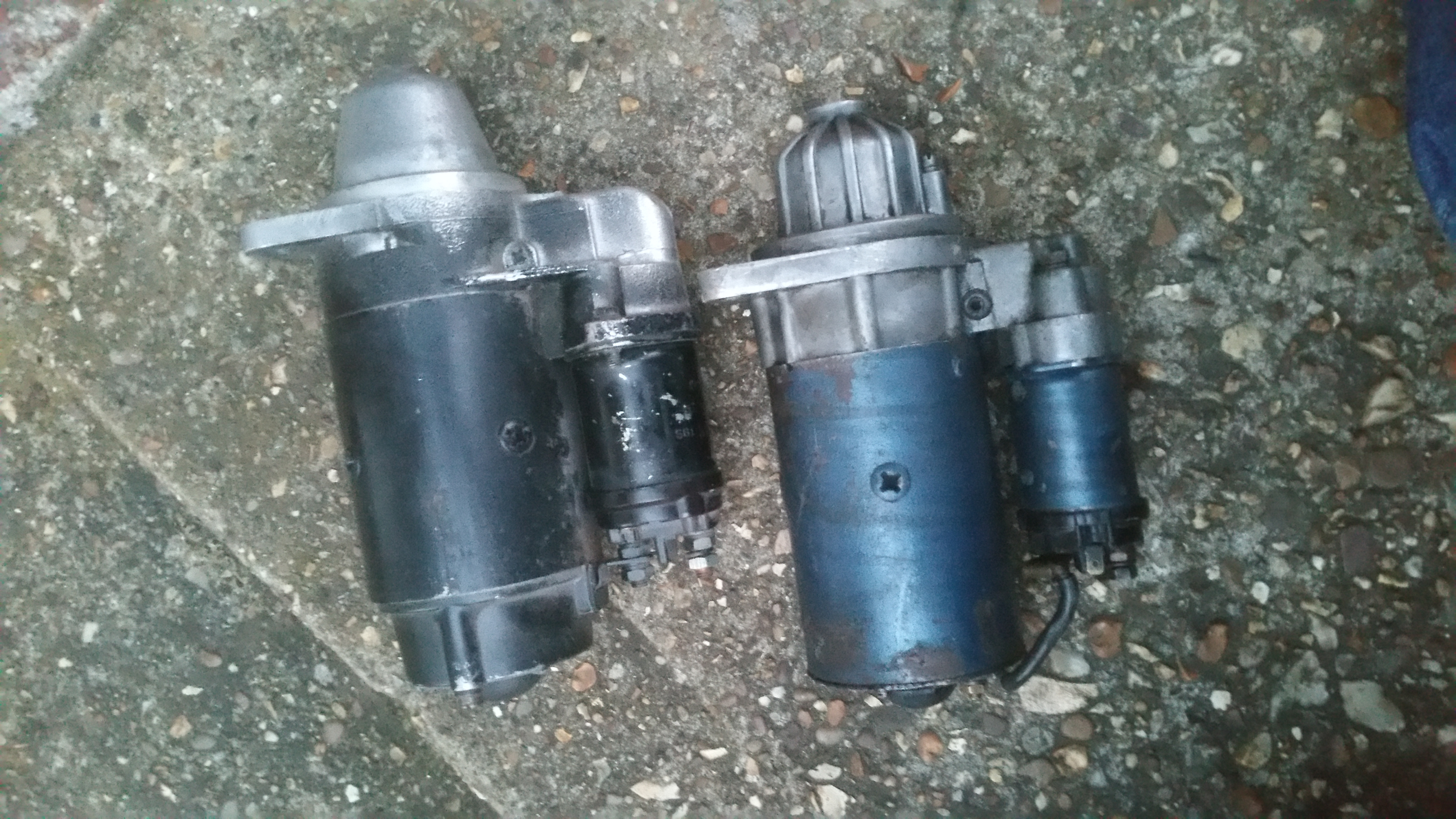

That's the wrong starter motor for an auto
Shold have a 2m100 bigger stater for the auto,'s that's a standaRd 1.7/1.8 mj35 manual one u got there
I'll get a pic of an auto one for u
Barry
Barry
Barry

I notice, Barry, that the MG starter motors are completely different to the Marina ones, in that the open end of the casting where the pinion gear is, is on the opposite side of the starter motor, or put it another way, if the motor was orientated to mesh with my flywheel, the solenoid would be underneath instead of on top. And I bet the mounting flange holes don't line up either. I found a used 2M100 on eBay, but same as what I thought when I looked at starter motors at Moss, ones for MGs don't fit. I find it puzzling that Lucas used the same model numbers for starter motors used in different applications, that aren't interchangeable.
The Haynes manual I got with the car, which only covers the 1.8, mentions the M418G starter and the M35J, but doesn't make any specific reference to starters for automatics. The Autobooks manual, which covers the 1.3 and 1.8, mentions the M218G, M35J and 2M100, and gives torque figures and applications. That book says the M418G is standard for the 1.3, the M35J is for cold climates on the 1.3, but the 2M100 is the ONLY starter given for the 1.8! Both books cannot be right.
Do you suppose there's any chance that BL used whatever starter motor they had to hand when my car came down the line in 1976? I've heard of things like that happening before. Such as, in the brochure I've got that covers the Mk2 Marina HL and GT, the HL steering wheel has plastic wood grain set in the steering wheel spokes, and the fake drilled alloy look is on the GT, yet my HL (and Steve Moss's I think) has the GT steering wheel. I assume they'd got no HL centre pads when they were building our cars!

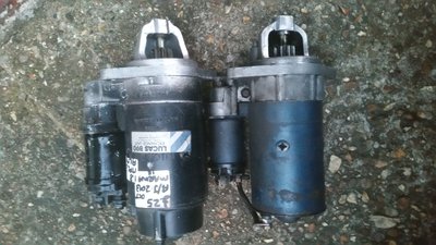

Pic's of starter differences as promised
Cheers barry

All my 2.0 auto ital's have the 2m100 this is also the correct starter for the 1800 auto as well this is in my lucas starter motor book I'll get a pic of the page for you the manual starter will do the job but the 2m100 is a bigger starter to help with starting an auto.cheer's barry

Thanks Barry. Yes that 'Autobooks' manual I have in my possession rates the 2M100 as having the highest torque. The used MG starter in my eBay watch list is this - http://www.ebay.co.uk/itm/222432232059? ... EBIDX%3AIT
It is easy to see it is more or less a mirror image to the 2M100 you have. If you look at the photos with the solenoid lying on the same side, one motor has an open casting for the pinion gear and the other the closed side. I'm not familiar with MGBs but I can only assume they put the starter motor on the opposite side of the engine bay on those. Looking at the photos, it looks to me like the alloy castings are bespoke. I don't think it is a case of undoing a few screws and swiveling the casing around to suit a different car.
Now my motor is with the reconditioners, and with the likelyhood it won't cost me that much, it would be silly not to let them finish it and use it on the car. However now you've told me what it should be like, I can keep a look out for something better if it turns up.
I'd say that starter you have there has been played with (reconditioned or whatever) as the alloy casting has been painted- I've never seen that on an original one.
The main code on the starter refers to the motor itself if I remember rightly, there are numerous permutations of nose castings (solenoid position relative to where the ring gear engages) and gear wheels to go with that.
