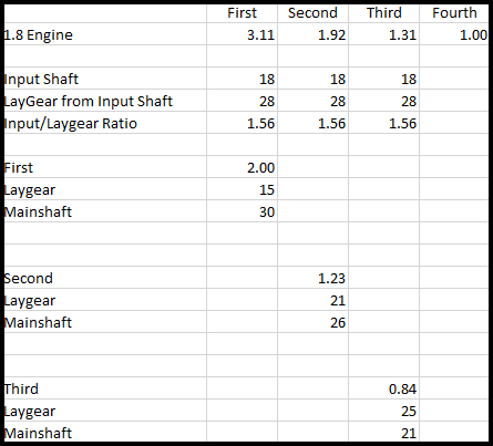

These are the Marina Ratios
Re: Flat Spot
Posted: Mon May 11, 2020 9:14 pm
by MarinaCoupe
I researched this some time ago
Re: Flat Spot
Posted: Wed May 13, 2020 3:20 pm
by MarinaCoupe
Hi Renzo,
I have checked your teeth count and recalculated the gear ratios with the aid of a spreadsheet. Initially I got the same answers as David Painter. These are clearly wrong. However, I think that you have written down the teeth count for the second and third gear Mainshaft and layshaft the wrong way round, so if you write
Second gear as Laygear 21 and Mainshaft 26 then the calculation comes out exactly right at 1.92:1
Equally for third gear as Laygear 25 and Mainshaft 21 then the calculation comes out exactly right at 1.31:1
So this is a 1.8 gearbox - its an easy mistake to make.
