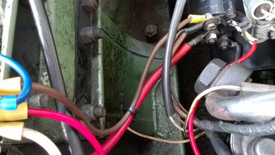

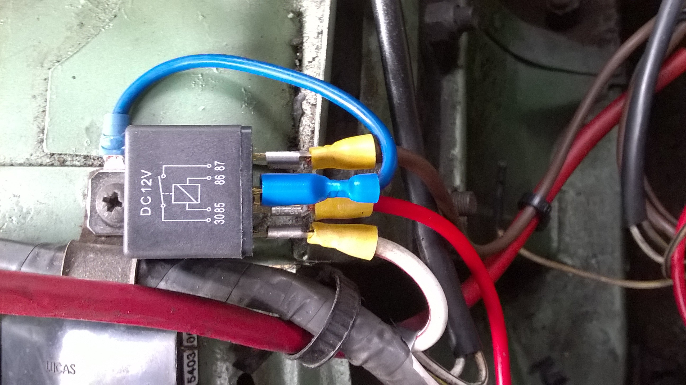

Okay, the good news first, updated with pictures. Kilroy's mod to the starting circuit for Marina automatics with the 'click' problem when you turn the key, and no starter motor turning, works a treat. I can make good, sound electrical connections and do wiring neatly, but electricity flow isn't my strong point, and I would never have come up with this solution myself. Neither would the person who hot-wired a starter button from the battery to the starter solenoid on my car, it seems. Kilroy's instructions are on one of my earlier threads but if anyone wants a reminder, it goes like this.
Use a 30 amp 4 pin relay, and cut the white and red wire on the inner-wing side of the harness, right where it goes into the plastic connector block on the harness leading to the starter solenoid, the block which on my car was hanging down between the oil filter and the horn. A spade connector was crimped to the end of the white and red wire, and it was plugged into one side of the relay's coil, and the other side of the relay's coil went to earth. In my pictures this is the blue wire, with a ring connector trapped under the relay mounting screw. Then, on the 'switched' side of the relay (the remaining two pins), one pin is connected to what should be, by rights, the remaining white and red wire of the original car harness, to the big 35 amp terminal on the starter motor solenoid, but in my photos its a plain red wire cos I couldn't get any white and red. A brown wire goes from the other switched pin of the relay to the same post on the starter solenoid as the big fat live cable from the battery, though in my case cos there's an original brown, and green/brown cable piggy-backed onto a metal plate on that very terminal post, I used a ring connector to fasten my brown wire to that instead. It's the same difference. Bearing in mind I've got no carbs fitted and open inlet ports on my engine, I only flicked the starter a few times to test the mod out, but the engine turned willingly with no hesitation each time. Brilliant mod. Thanks Kilroy.
P.S. most of the wire I used was 27 amp to be on the safe side, with just the blue earth wire being 17 amp, as again, its all I could get, but I bought new stuff because the begged, stolen or borrowed scraps I had kicking around were not up to the job.

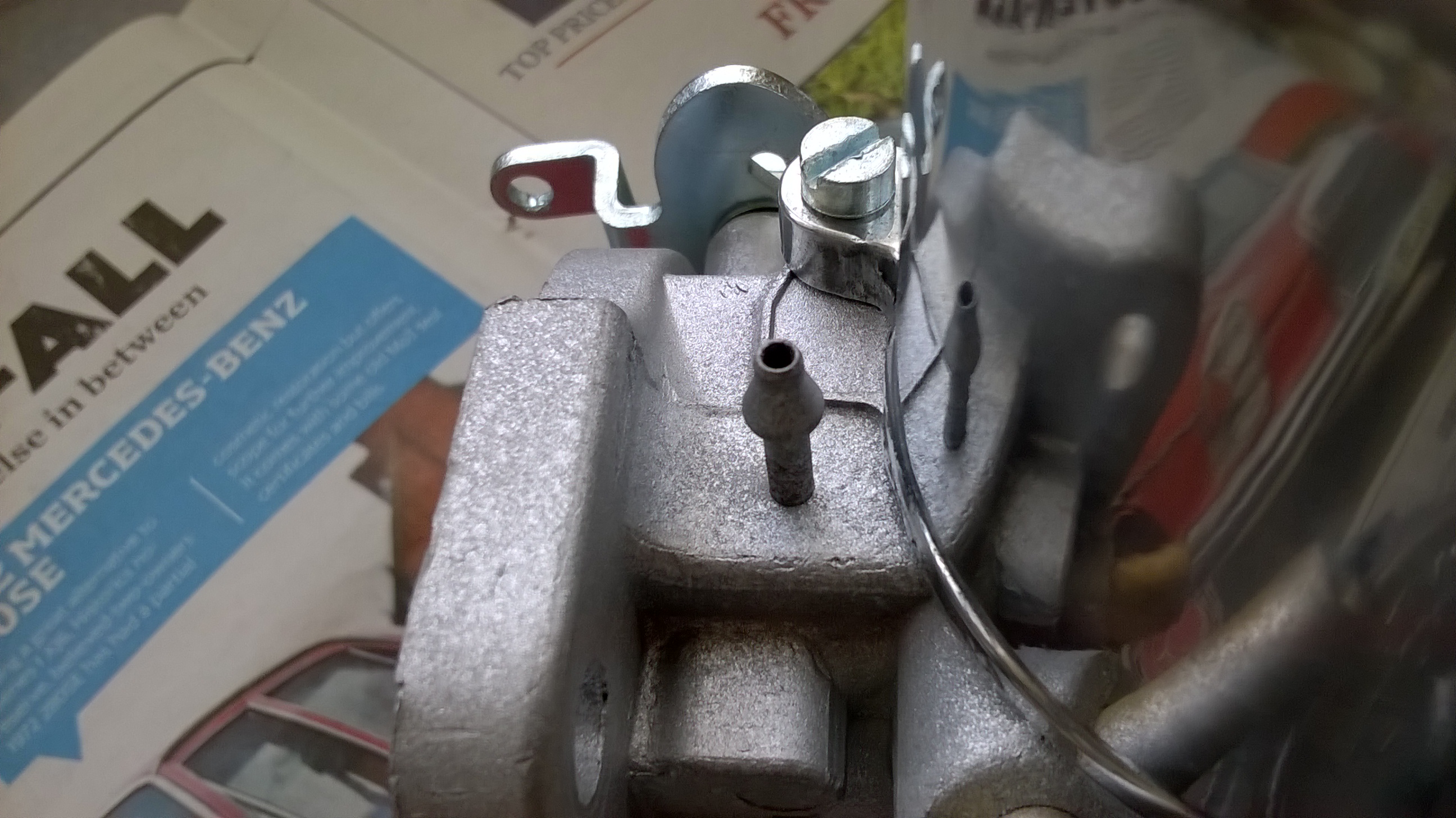

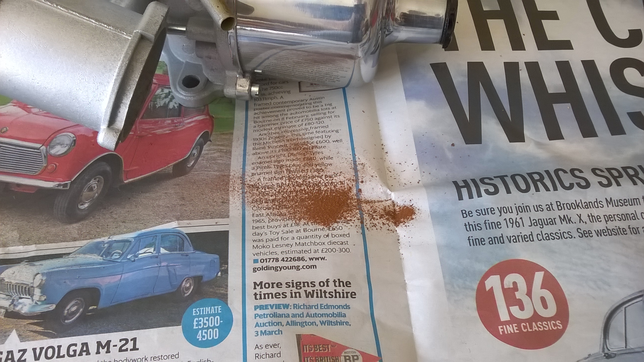

Now the not-so-good news. The carbs.
Okay, so worse things happen at sea, but seeing as I was supposed to be getting my 'original' 27,000 mile carbs rebuilt, it comes as a bit of a blow to discover when preparing to fit, that I've got different carb bodies to those I supplied, and one is drilled out for a vacuum pipe where I don't need it. I scraped the bottom of the float chambers and got rusty crud out, and I suspect these aren't my originals either as I'd already performed a similar task in-situ when I got the car. Yes they have been bead-blasted, but it didn't reach into the float chamber properly. These carbs HAVE been prepared for me, I haven't come away with someone else's, as the kickdown linkage is there on the rearmost carb, but I assume by now, someone else has my carb bodies for their car. I can live with this provided they've been built right (though I was told 27,000 mile carbs can be returned to new, 100,000 mile carbs to about 25,000 miles....so how far have these been?) but what to do about the unwanted vac take off? I've considered - trying to solder over the hole, as I've got a big soldering iron, or, cutting the taper off the pipe, crimping the pipe flat and THEN soldering it - though I'm a bit concerned that any rubber or plastic seals in the carbs would be damaged by heat transfer. Or, use some sort of filler, but I don't know what would resist heat and vibration, or just push a piece of vac-pipe over the stub and try to seal that by doubling it over and clipping it. Hardly concours stuff though. The photo of the inlet ports show the numbers stamped into these castings that weren't present on my original carb bodies.
