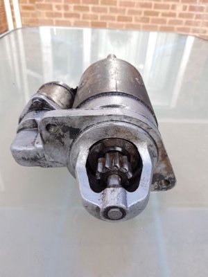

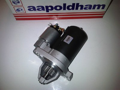

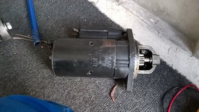

Be very careful. MGB starter motors do not fit 1800 Marinas. The pinion gear nose piece is different. I don't know why, but it is. It is a different casting and it cannot simply be unbolted and moved around. This is the biggest obstacle in finding a starter to fit a Marina (or a kit car with a Marina engine). Here are some images. The first is my M35J starter, pre-rewind. Then there are two images of MGB starters listed at the moment on eBay. You can see that if the solenoid sits on top, the pinion nose piece is open on the opposite side. Finally Barry (marinamadbaz on this forum) sent me two images of the M35J and 2M100 side by side, to show the difference. Barry reckoned the 1800 Marina should have the 2M100 and that the M35J was for a 1.3, and Whyatt's said much the same. My Autobooks workshop manual also supports this, but the Haynes manual I had (a replacement is due soon after the old one got trashed) actually linked the M35J to Mk2 1800 Marinas, which is what mine is, and I see no reason to suspect my low mileage car, messed up as it was in the maintenance department when I got it, has had a different starter motor added.
