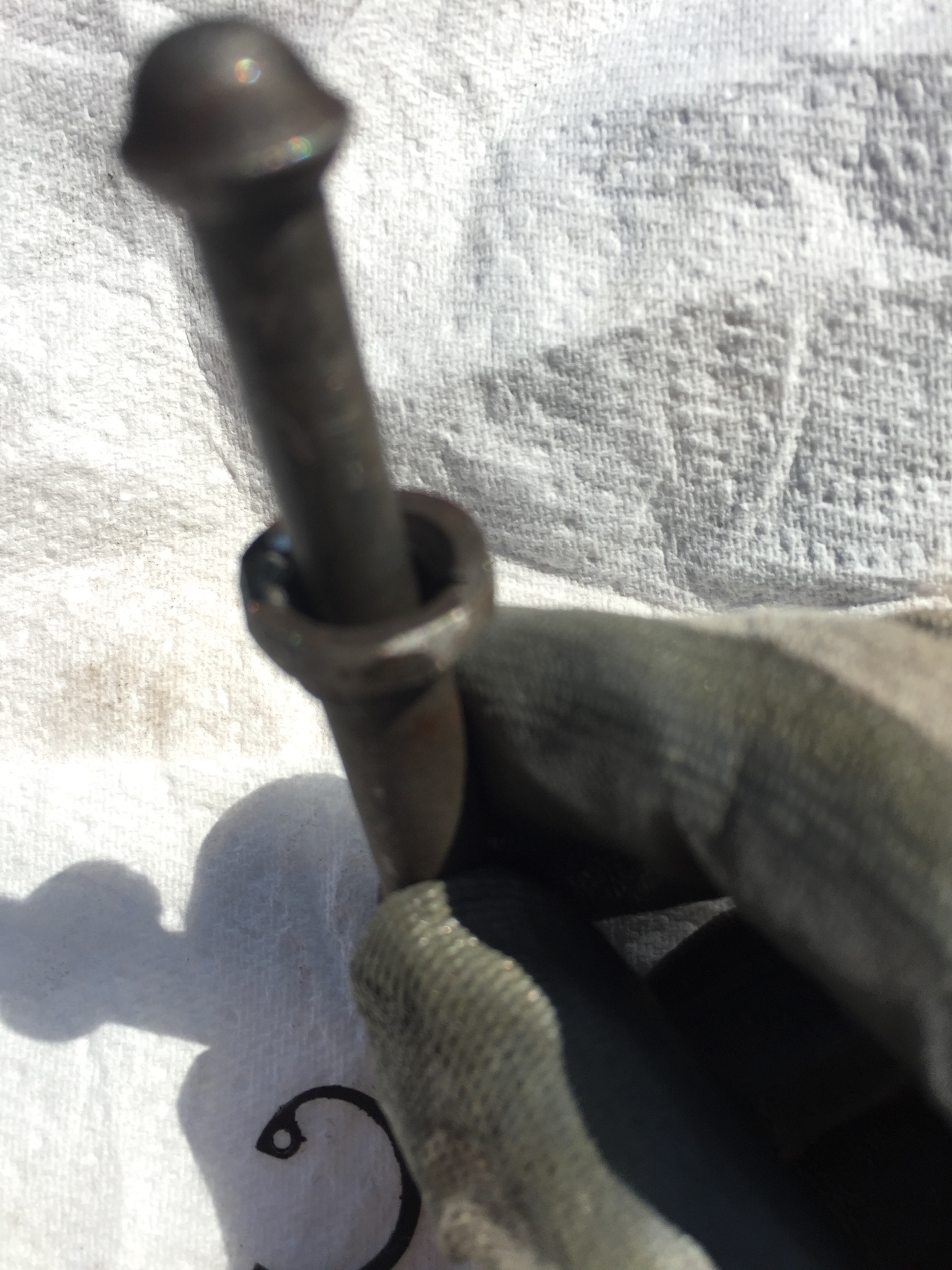

I had a clutch master delivered to me on Friday, the owner described it as OK, but looking for a recon unit.
This is what I got.
1. Broken circlip - absolute bas**rd to get out, as circlip pliers won’t work.
2. Pushrod retaining cup broken and (badly).
3. Black and sh**ty fluid stuck all over everything.
I had to cannibalise another unit to build up a good one to send back, so he lost his surcharge.
