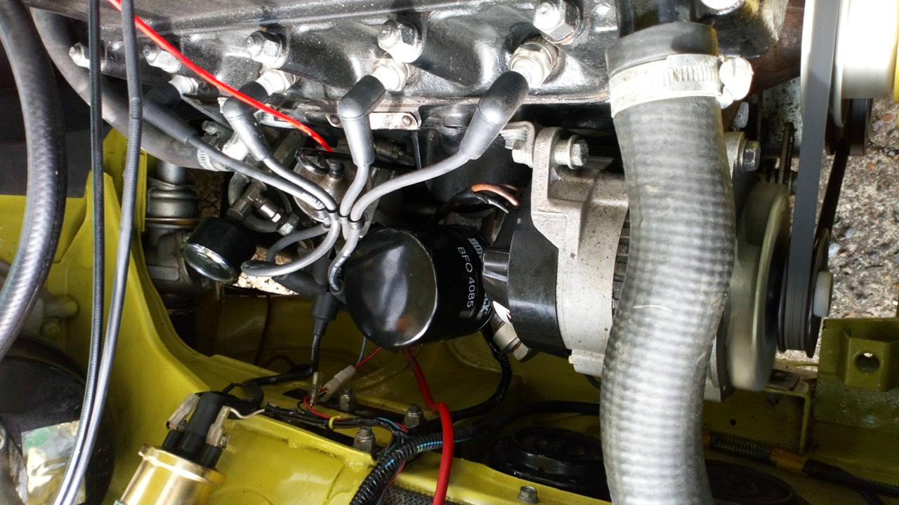

I am going to do a service on Renzo’s TC Jubilee. It has the upward facing oil filter, rather than the later hanging oil filter. The current oil filter is a Borg & Beck BFO 4085, does anyone know the Unipart equivalent part number (GFExxx), also where I can source one as many white Unipart filters seem to have dried up on eBay.

I run a GFE 121 on my MGB with the same inverted arrangement

Thanks guys, I’m hoping to find a pukka white Unipart one GFE121. David where did you find yours?

Chris last one was a ebay special they are listed quite often as was a popular filter back in the day it also fits a Ford Pinto if memory serves me correctly that as a Motorcraft EFL90 Mahle OC23

This site gives a different Unipart number GFE422
https://www.oilfilter-crossreference.co ... CK/BFO4085
This ebay listing says "It has the Part No. BFO4085 and is the equivalent to Unipart oil filters GFE121 & GFE422."
FYI also used on Avenger, MGB, and most 70s Fords https://webcat.borgandbeck.com/PartDeta ... nfoBFO4085
