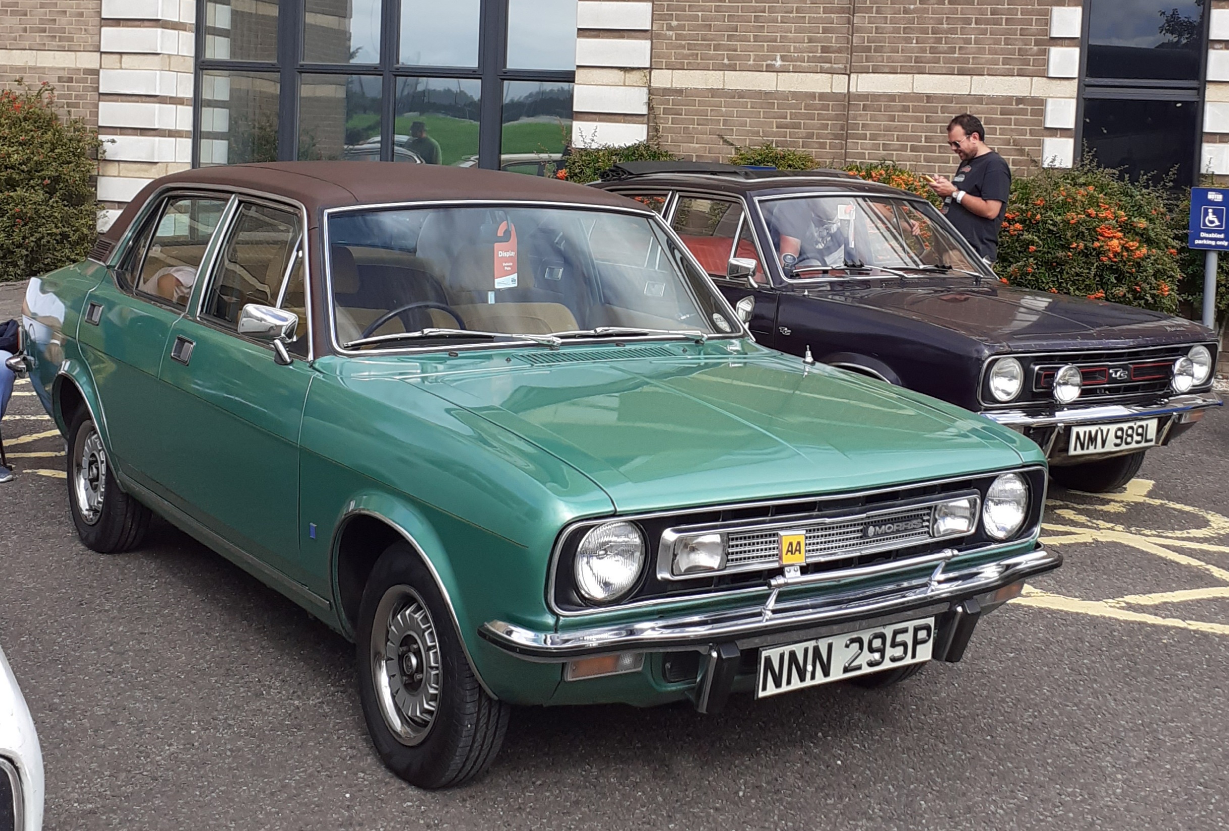

Thought it was time for an update - not that there's a lot to tell. The fine, hot weather in July tempted me to go for a few longish and random drives. I clocked up 200-odd miles over three afternoons. The car behaved pretty well although it got a little too hot when I was stuck in a traffic queue at roadworks near Bromsgrove.
Ownership is still a learning curve. My driveway slopes steeply. Early in August, the car spent 10 days parked on the drive facing down the slope. When I used it again, the engine rattled horribly on start-up thanks to the slope causing the oil pump to be starved of oil 😲 Lesson learned... park it facing up the slope in future!
At the end of August I noticed a faint smell of petrol both under the bonnet and in the boot. I found the front flexi pipe into the pump was showing signs of deterioration, despite being fairly new. As I was nursing a shoulder injury (I'd fallen over a small dog on a very long lead) I didn't fancy crawling about under the car so I found a local old-school garage to do the hard work for me. They ultimately replaced the flexi pipe mentioned above, along with the one from the tank exit and the one attached to the tank breather. They also went round with the grease gun, adjusted the bonnet catch and tweaked the idle speed a fraction.
That brings me to September, and to the BL/BMC/Rover day and Mini show at the British Motor Museum, Gaydon. I was there, on the Owners club stand, for what was my first (and probably my last) 'proper' show of 2020. Again, the Marina performed well on the 90 mile round trip. A great day out and it was nice to meet some other Marina/Ital folk.
