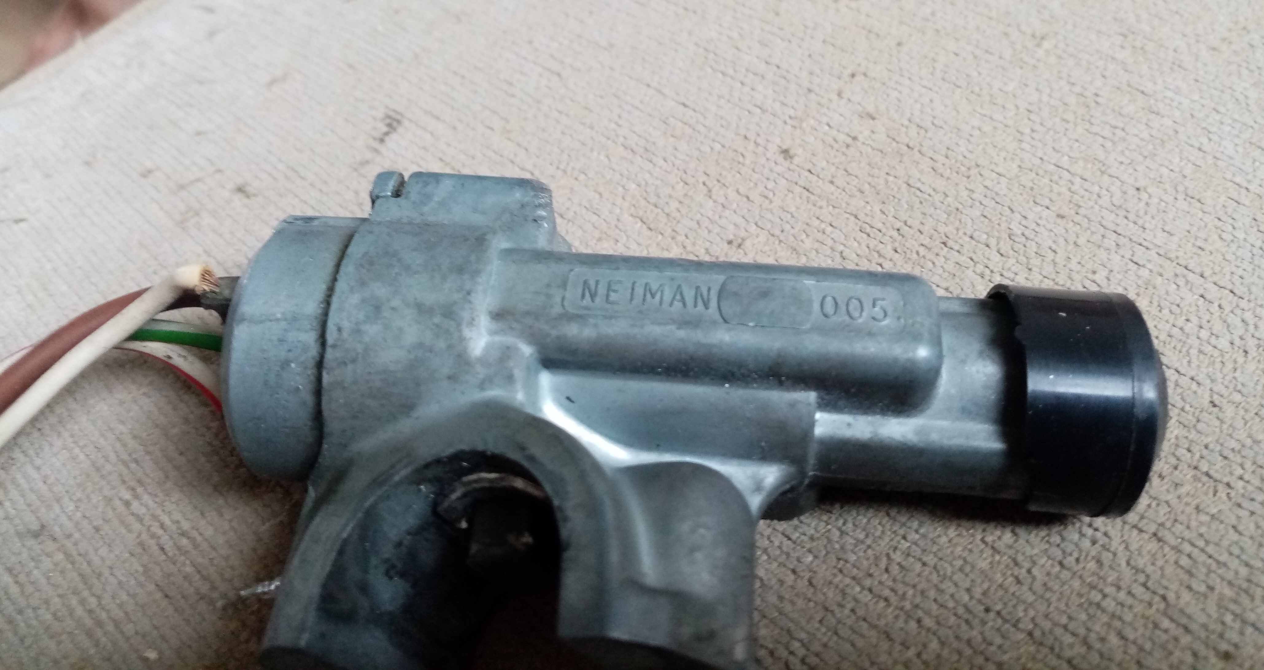

Post by Spindrift » Thu Jun 18, 2020 2:17 pm
Hi all
Managed to get key out after a fight and thats never gonna work again, so got barrel out but cant find any for sale so far that match. The casing has NEIMAN 005 on it.
Any help would be appreciated
Ta Jeff
Re: Stuck Key Ignition
Post by david painter » Thu Jun 18, 2020 6:42 pm
The BL mk2 part number is BHM 7034 Except GT and HL. BHM7089 is the number liosted for GT and HL. I dont know hat the difference is but suspect both will fit

Post by Spindrift » Thu Jun 18, 2020 7:01 pm
Hi Dave
Thanks for part nos, been searching all day no luck yet.
Ta Jeff

Post by IVOR DENNEY » Thu Jun 18, 2020 10:10 pm
DAVE the GT and the HL had an extra wire on the plug for the anti run on valve but I think the ignition locks are the same for the mk 2 its just plug has the extra wire .
