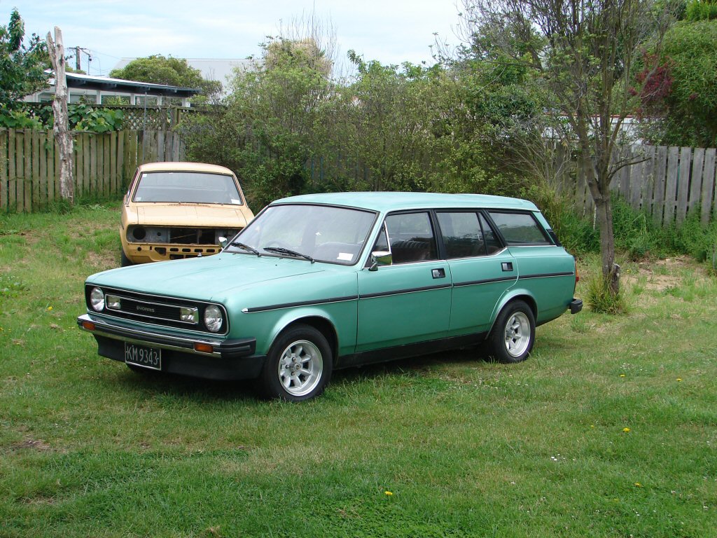

Hey gang.
I have what is to me at least, an interesting problem.
Vehicle in question - my green estate - has had a varied career and anything is possible.
While I have tried to return everything to how it should be in the suspension, I still have an odd problem.
Symptoms;
When going over a bump at speed, which causes the front suspension to compress almost fully, the car veers to one side.
I feel that it veers to the left on compression, and to the right on rebound.
I guess that figures, as whatever geometry is out of whack will reverse its behaviour depending on whether the suspension is going up or down.
I have investigated the steering and found that one tie-rod end had failed in the last 2 weeks, but having replaced that and adjusted the toe-in to zero, the problem persists, although perhaps is less developed.
The steering rack is definitely a later type, but I noticed when adjusting the toe-in that the tie rods are differing thicknesses.
Questions;
Are the tie-rods on early racks of a different length than later ones.?
Is it possible that some numpty has swapped parts and I now have tie-rods of different lengths.?
It is one of the only possibilities I can think of which would cause these symptoms.
The other would be an eye bolt whose bush was worn to bits causing the lower arm to move in and out, although they both look fine.
All theories gratefully accepted.
The judges decision will be final.
Send no money...
It is otherwise a joy to drive...
