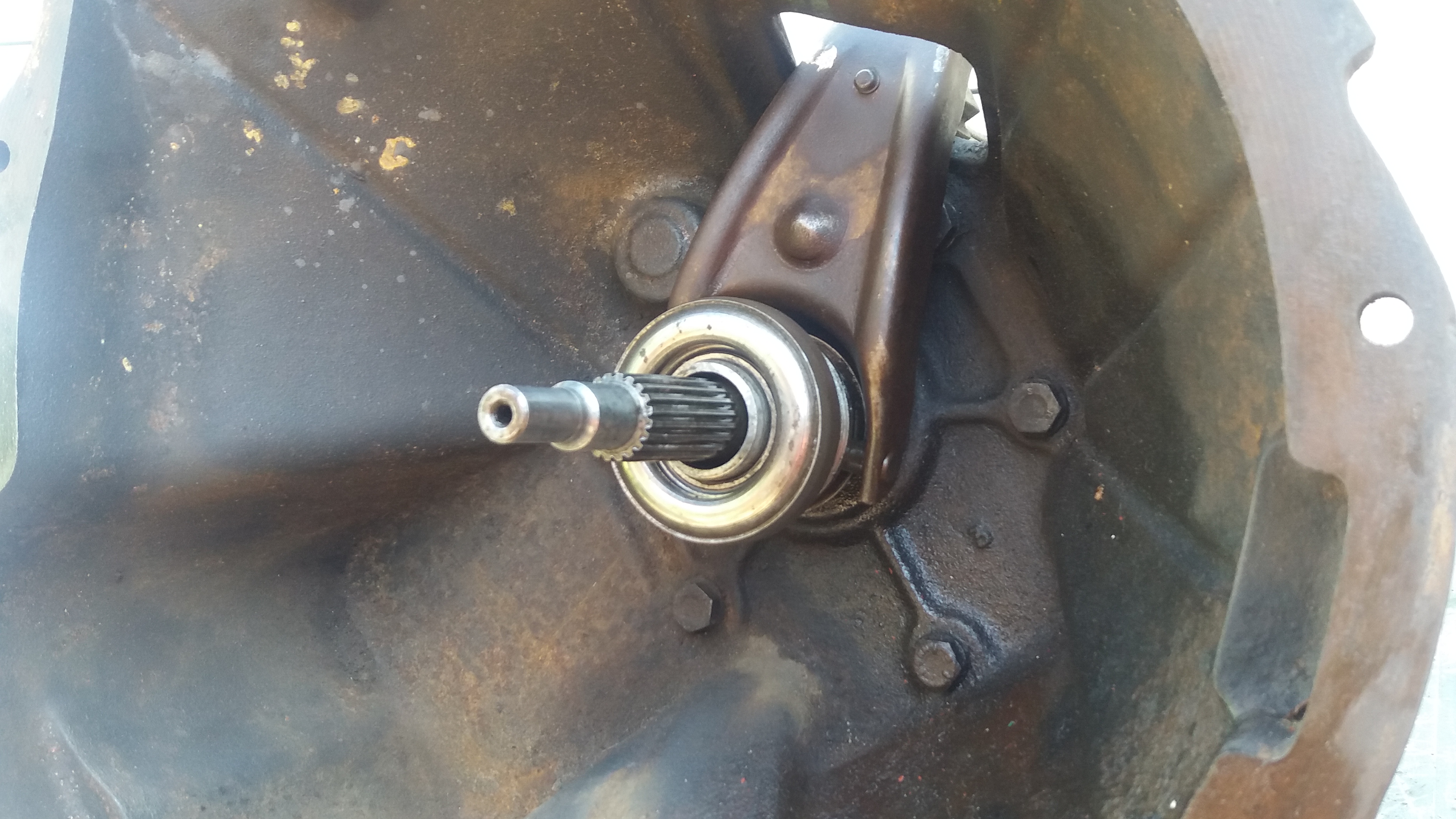

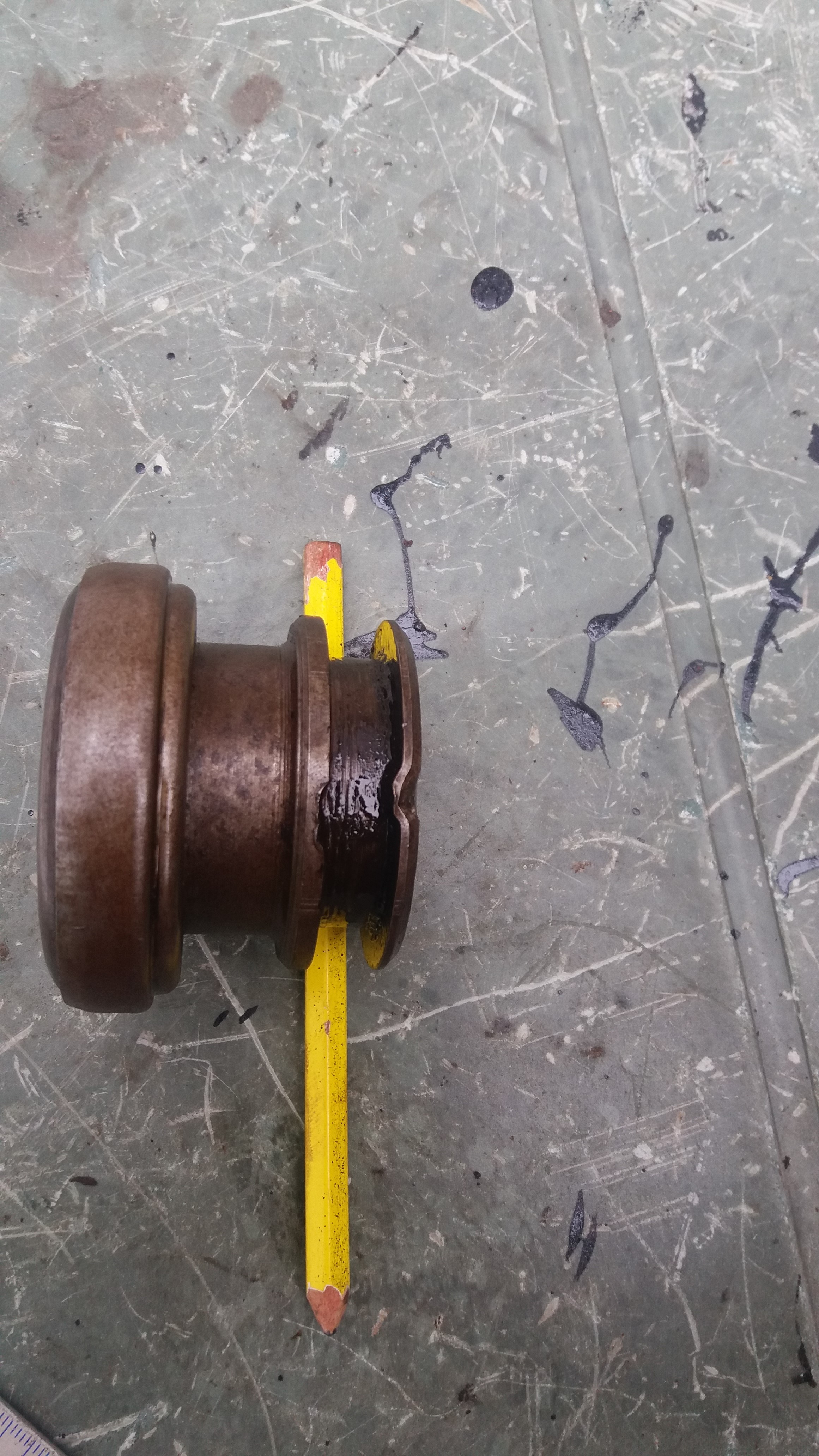

The clutch release bearings are all, the same, however the carrier for the clutch release bearing are different between the 1.3 and the 1.8/1.7.
Sorry for the upside down pictures.
Are you certain that the clutch lever arm clip is the problem?

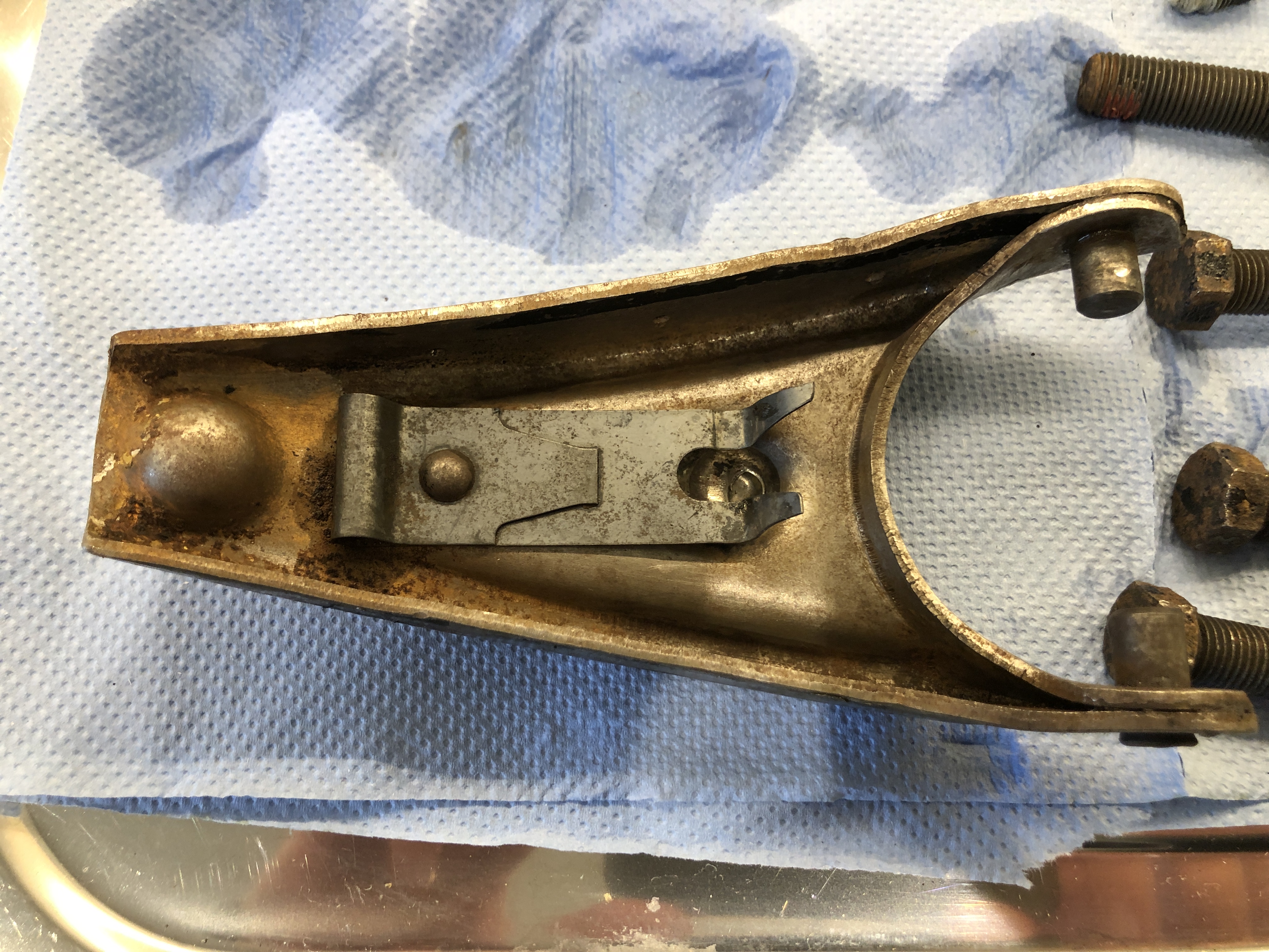

Post by MarinaCoupe » Tue May 25, 2021 11:53 am
The fork/clip looks like this, as you can see this ones a little bent but serviceable.

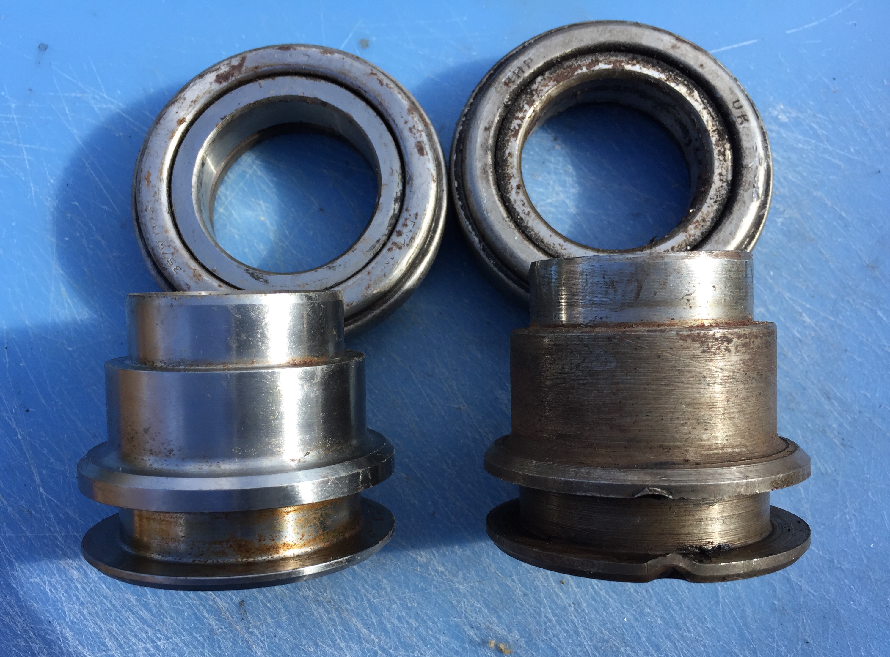

I did see your video, it does look a little strange. I’ll measure the one in my pics, so you can compare it to yours.

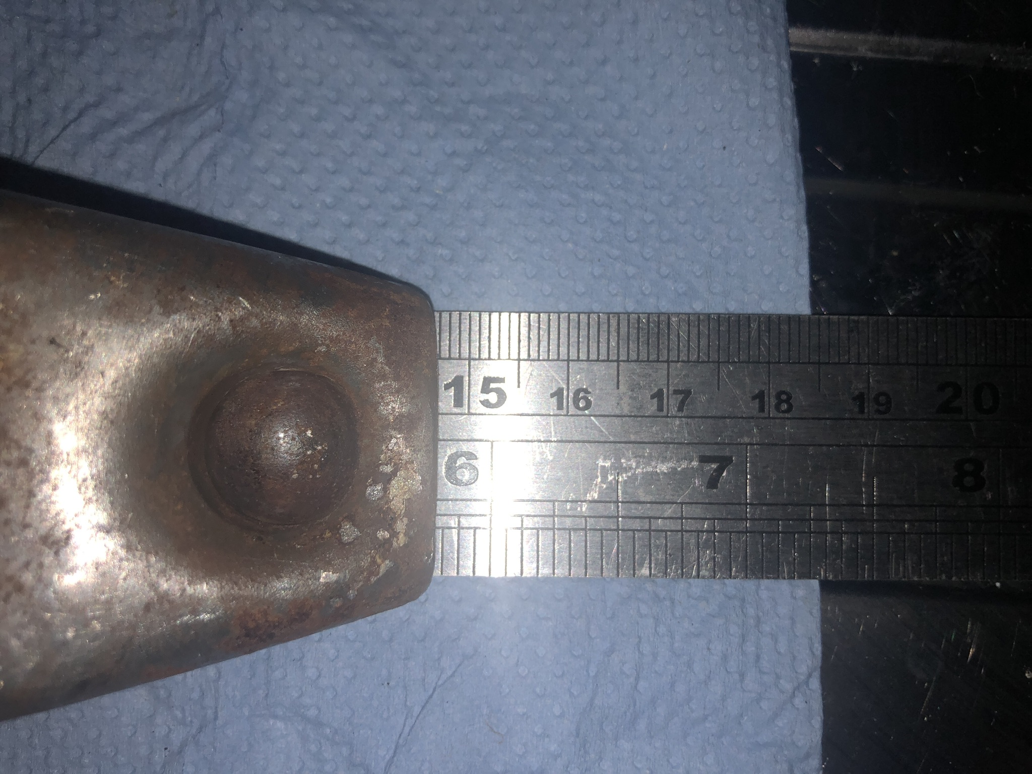

Hi Chris
Please find pics, Can't see anything wrong with the clutch arm or spring, the release bearing and carrier seem fine however the length of the carrier measures 44mm ( strange ) but all working fine.
I do not like this after market slave cyl with the clip arrangement and wondering if this has been my problem, it is such a loose fit in the bell housing and maybe cocking over giving the impression there is something wrong
john

My measurements on the clutch release bearing carrier do not include the section inside the release bearing.
I think that you could be onto something about the wire retaining armature. Have you tried substituting the OE type of clutch slave?

The figures in my pictures are of the 1300 and 1800.
The longer one is the 1300.

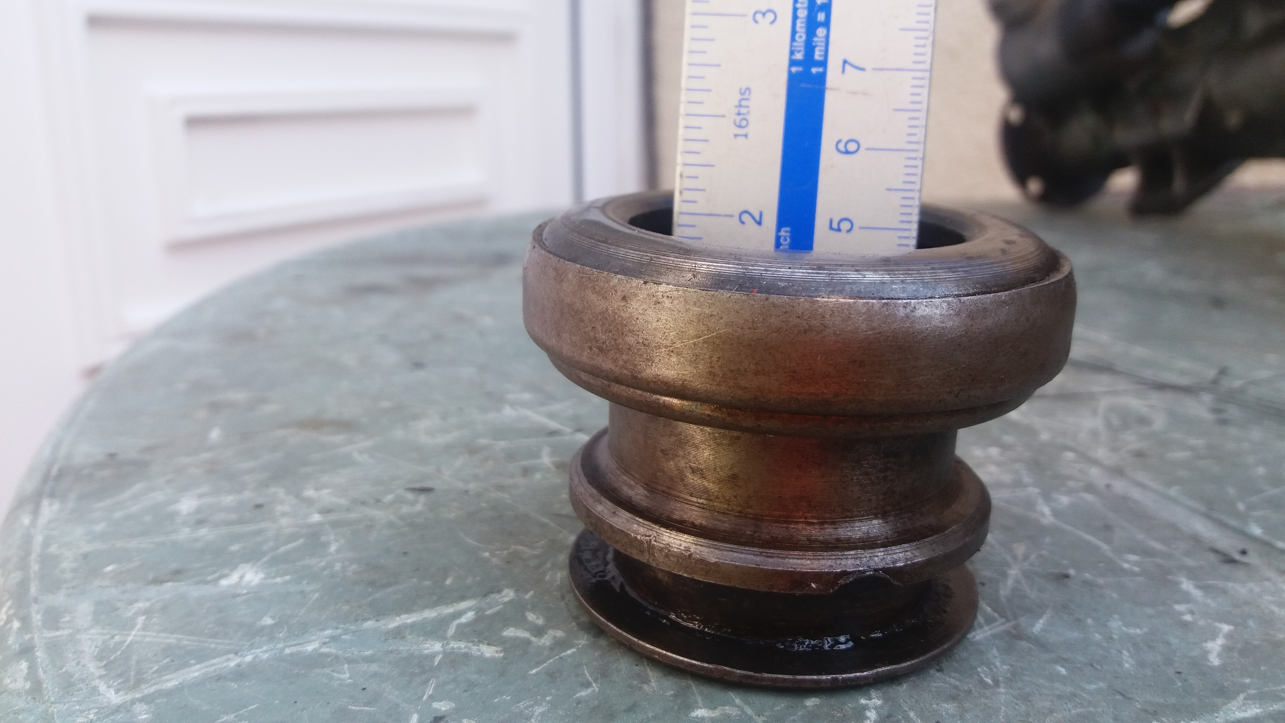

Can you post a picture of you measuring the carrier, to make sure that we are comparing apples with apples.

Please find pics

The release bearing itself is about 3/4” (19.06mm) thick. It all looks OK to me.
