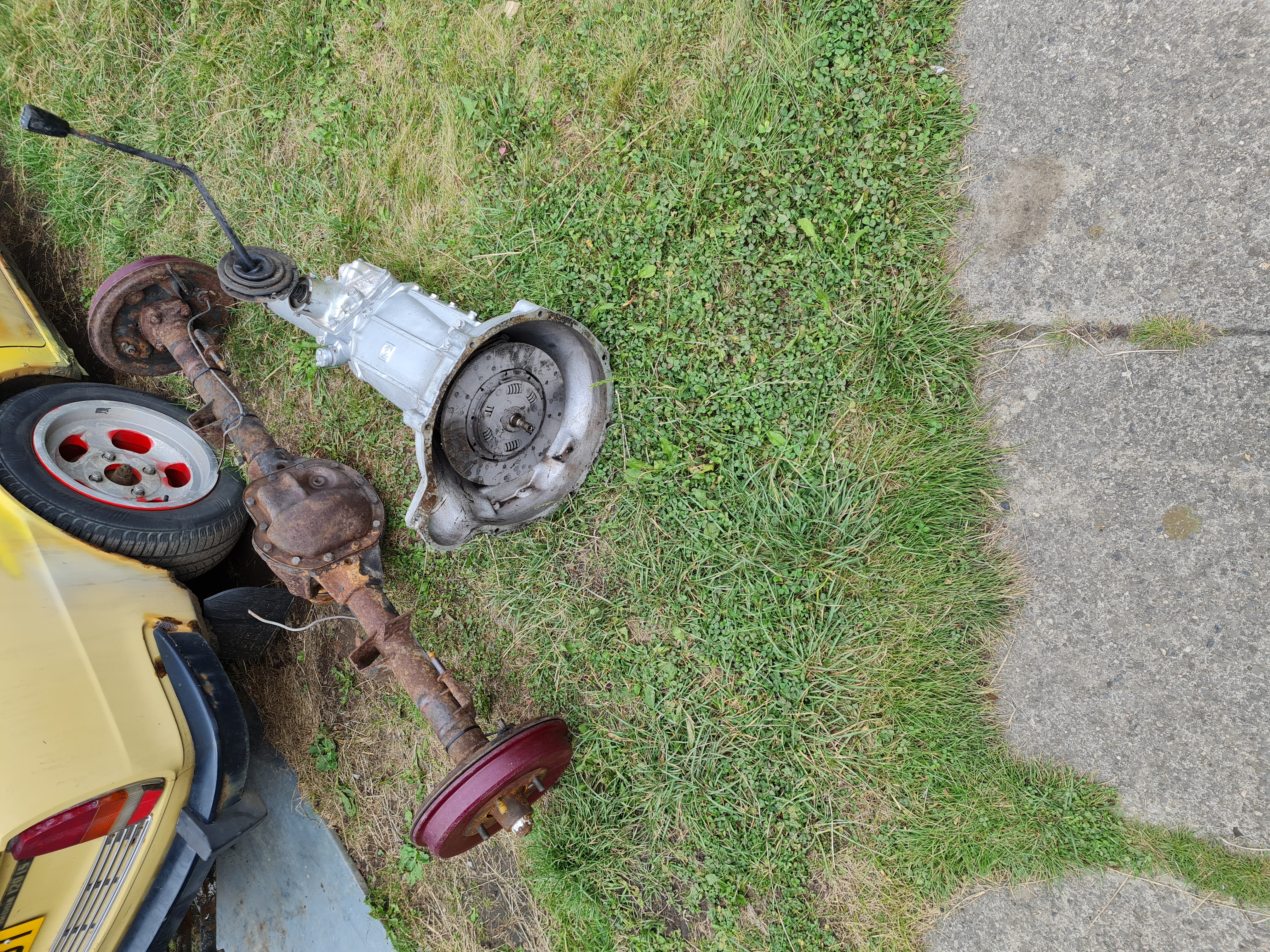

Re: Marina inbound, with questions
Post by trunnions ftw » Sun Aug 01, 2021 3:03 pm
So I'm thinking to maybe use this sherpa gear box as it looks decent enough to adapt onto the 2.2 princess engine, it has a lt77 spline common to the 1.8 marina gearbox so there's loads of clutch plates to choose from instead of the older 10spline boxs, the gear lever looks to come up somewhere about right too.
So just a custom flywheel and adapter to make.

FYI Leyland Australia fitted the 2.6 E6 with an adaptor that allowed them to use the same bellhousing as the alloy V8 in the P76, so a LT77 V8 bellhousing would bolt up to that adaptor. I'm not sure if they used the same crank tail as the fwd E6. Kelvin may be able to look up that info in his parts manual, or Carle or Darren may know the details.

Post by trunnions ftw » Mon Aug 02, 2021 5:33 am
Thanks all, that is very helpful, the fwd e6 comes in 2 variants the manual gearbox engine is hopeless as its like a mini engine, however I struck lucky and found an automatic engine with a sump adapter piece and a convention crank flange for the torque convertor!
What would be handy is if the auto bw35 fwd bellhousong was a B series pattern,,now that would be easy!
