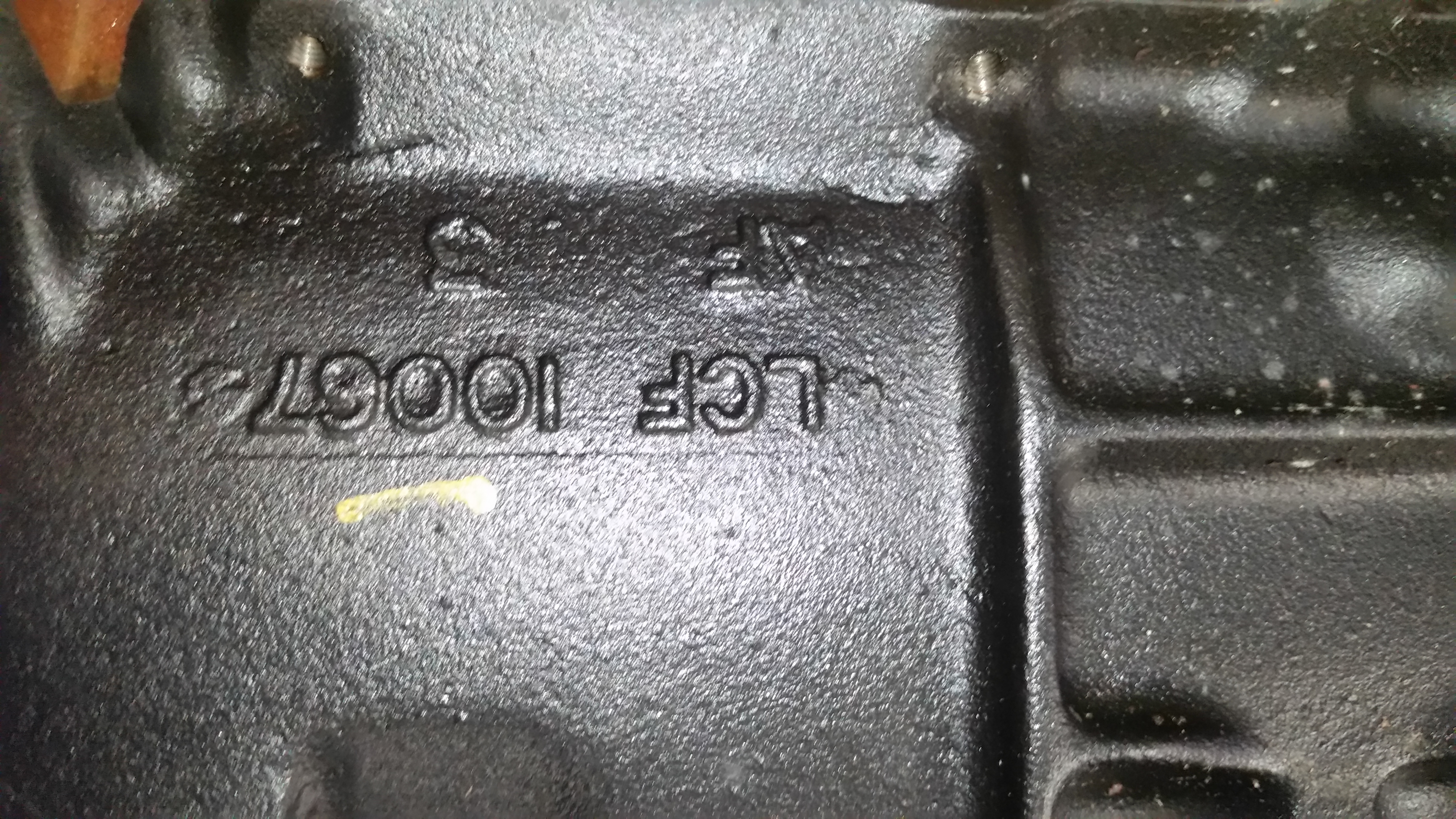

If you can send more pictures it would help to identify the block. From what I can see it looks to be an O2 engine. These come with a number of differences:
Bottom face of the block is mirrored meaning you will need to use a FWD sump, or find a Discovery MPi one.
The cylinder heads are different, mostly the oil feed. Check with a head gasket and see what lines up.
These will run in RWD as well as FWD configuration. Nothing too demanding here and you can use your old flywheel, clutch etc. You may need a new spigot bush for the crank.
The dipstick just needs a plug machining to fit. Then you can use your stick, however you need to figure out what sump to use first.

Post by Mikeyp » Thu Aug 05, 2021 11:01 am
Ben / Bryan
Thank you for the very helpful feedback. See photos showing engine number. Any suggestions on sourcing a FWD or discovery MPi sump? Good news that if i can sort that then should be able to make progress. There is a small precision engineering workshop in town that should be able to make the sump plug in
