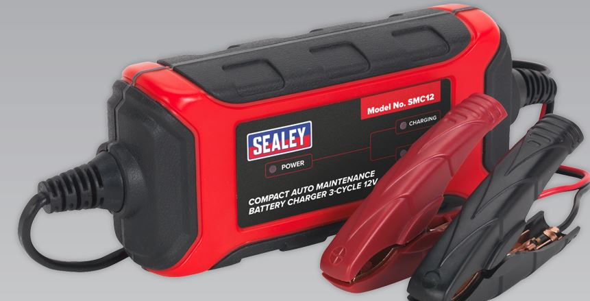

I intend to purchase a battery conditioner, however, as with may items there is a considerable range available with variable prices. Looked in Halfords both shop and online, they sell own brand, RING and CTEC. The list of functions can be confusing, I require something I can attach to the battery and leave without having to worry about frequently checking an LCD display. RING/CTEC are documented as having a 5 year guarantee. One issue which is important to me but is rarely referred to is the length of the +/- leads to the battery. Although my vehicle is kept in an attached garage I do not want to keep the bonnet fully open as dirt still gets in from the outside and would therefore prefer to not keep the conditioner in the engine compartment. Halfords cheapo at £25, packaging states '2m long leads', some of the reviews for the RING RSC612 on the Halfords website refer to the leads being short.
Be interested on any feedback on this subject, especially if anyone has experienced problems with any particular model.
Ian
Re: BATTERY
Post by david painter » Sun Feb 11, 2018 12:29 pm
I Have used a CTEK at home for many years without problems. At work I have sold several Sealey SMC12 Battery conditioners never had one back faulty you. It has a second lead that can be hard wired to any continuous live and the plug put in car or boot to suit you. they sell on web for £25 to £30 ish
Dave.
Model No........................SMC11.....................................SMC12
Type........................3-Cycle12V..............................3-Cycle 12V
Input............................230V.........................................230V
Output..........................12V...........................................12V
Input Current................0.25A........................................0.25A
Efficiency.....................>80%........................................>80%
Charging Current............0.8A..........................................1.5A
Back Current Drain.......11Ah/month.............................<13Ah/month
Ambient Temperature...-20°C to +50°C ........................-20°C to +50°C
Dimensions (LxWxH)... .178x66x38mm ....................198 x 68 x 41mm
Housing Protection...........XXX.........................................IP65
Weight.........................0.4kg..................................... 0.49kg
