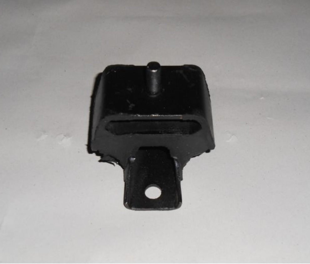

This is a pic of the correct 1.3 engine mount, I can’t find any in the UK at the moment, this one is in Greece. Moprod part number EM466. Interestingly the Vauxhall Chevette uses exactly the same Moprod part number, but I couldn’t find one of those either :-)

This is the 1800, Diesel and 1.3 Auto bush - EM679
