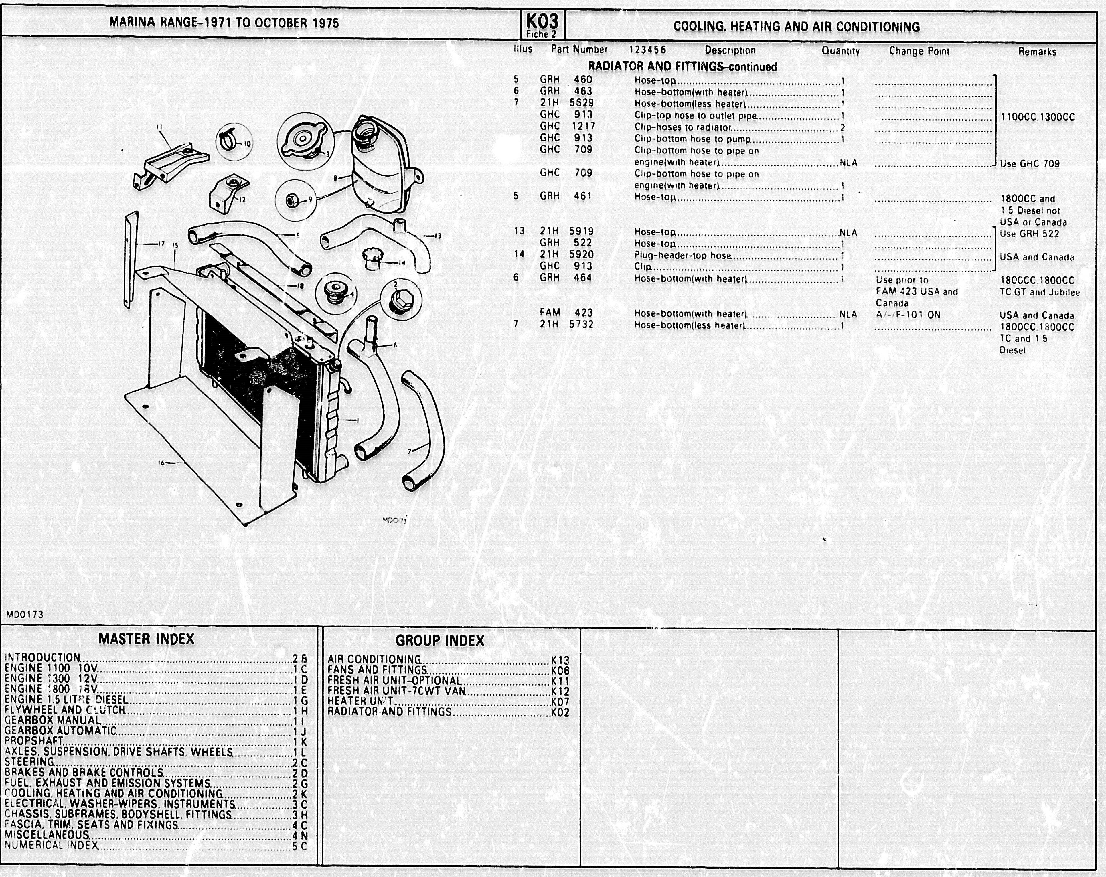

I have a Marlin using the 1.8TC motor etc, bottom radiator hose has been hacked, so needs replacing. Can anyone tell me if there are different versions for UK and US markets please? A very unhelpful Ebay seller hasn't given information of any use at all.

Hi not sure whether you are in the US or UK or that you have been offered a US bottom hose from your comment. This is the MK1 cooling page from the BL Marina Parts Manual, it covers both the 1800 & 1300, the 1800 bottom hose is P# 6. It quotes several part numbers and against the USA & Canada version it says NLA. It also differentiates between versions with and without a heater in the car, not sure where cars without heaters were sold, but I'm assuming not to UK, USA or Canada.
In simple terms it should be a pipe from the bottom corner of the Marina radiator up to the inlet on the water pump. There is a spur pipe off it that links to the heater hose pipe which is a steel pipe that runs under the exhaust manifold back to the heater matrix.
