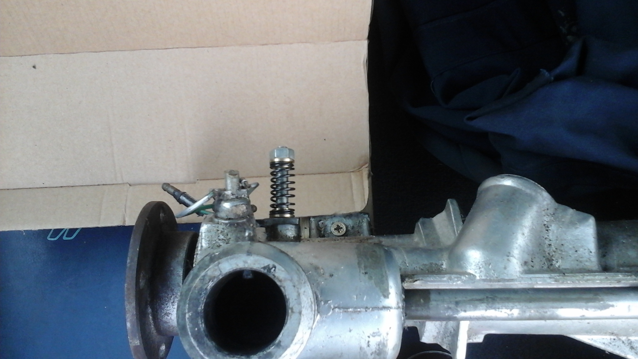

Here's a link to a picture on the Marlin Owners website.
https://marlinownersclub.com/forum/file ... 1574079087
He has also done something clever to incorporate a lock out for reverse gear to stop it accidentally being selected.

https://marlinownersclub.com/forum/file ... 1508143552
Re: Gear stick upgrade
If you look at the picture of the gearbox you will see a long bolt with a spring on it.
That has replaced the short bolt that held the detent in.
Now when you push over for reverse the detent is pushed out of the way thus negating the need to lift the gearstick over said detent.
The choice of spring is critical as is the length of bolt, a lot of trial and error is required.
The one I have gives just enough resistance to let me know when I am using reverse.
I hope this explains how it works.
Adrian
Adrian
