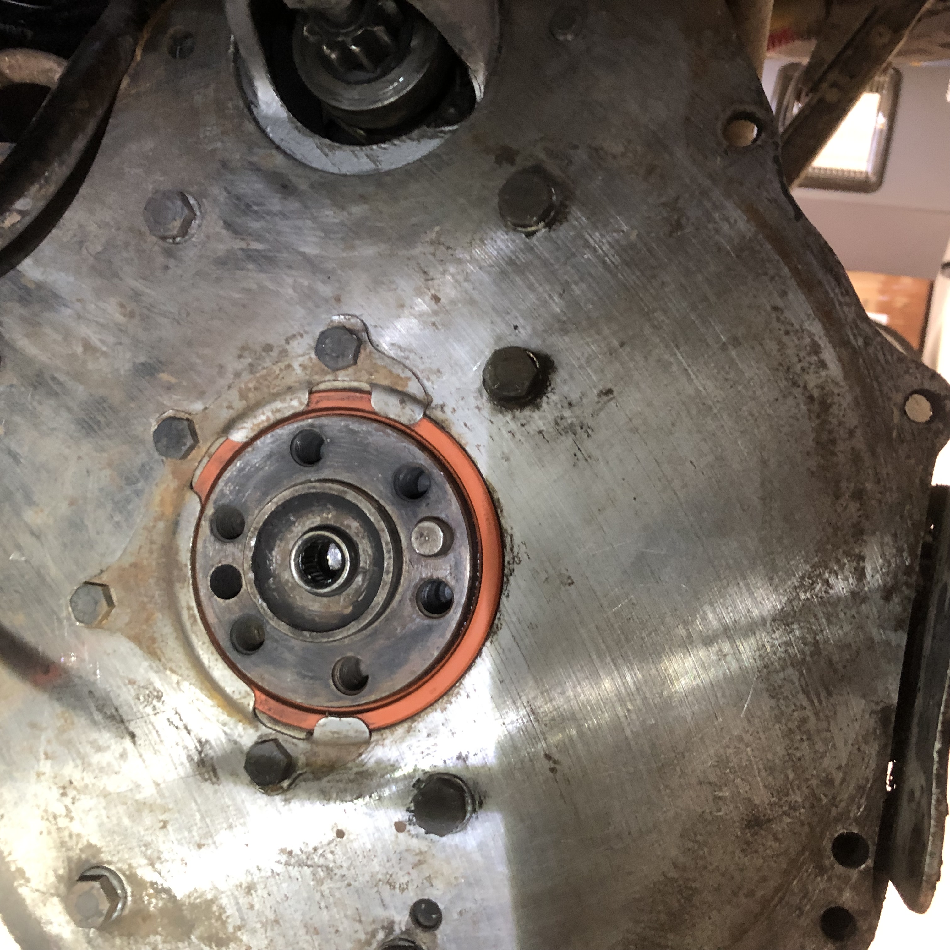

Also, the attached photos show the crankshaft oil seal. There has not been any oil leaking from the
hole in the gearbox bell housing, however there is some slight evidence of oil on the lower section
of the oil seal. (see Photos) Is this normal? Is it a matter of course to change the oil seal every time, or is it
best left alone if all seems okay?

The crankshaft rear oil seal in your pictures looks to be in good condition, unless that is you wiped it clean before taking the picture?
