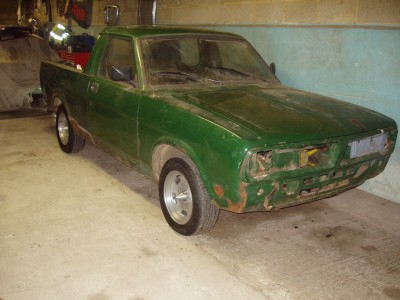

Fitted saloon axle and hubs to my pickup so I can use some wolfrace wheels when its restored
- Posts: 10257
Ah more Pickup porn
I love those spike centres! I think the wheels are Cobras aren't they? I prefer them to the Wolfrace ones. I think Scimitar 14" slotmags are the right fitment for the "heavy" commercials.
