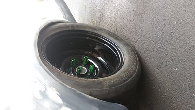

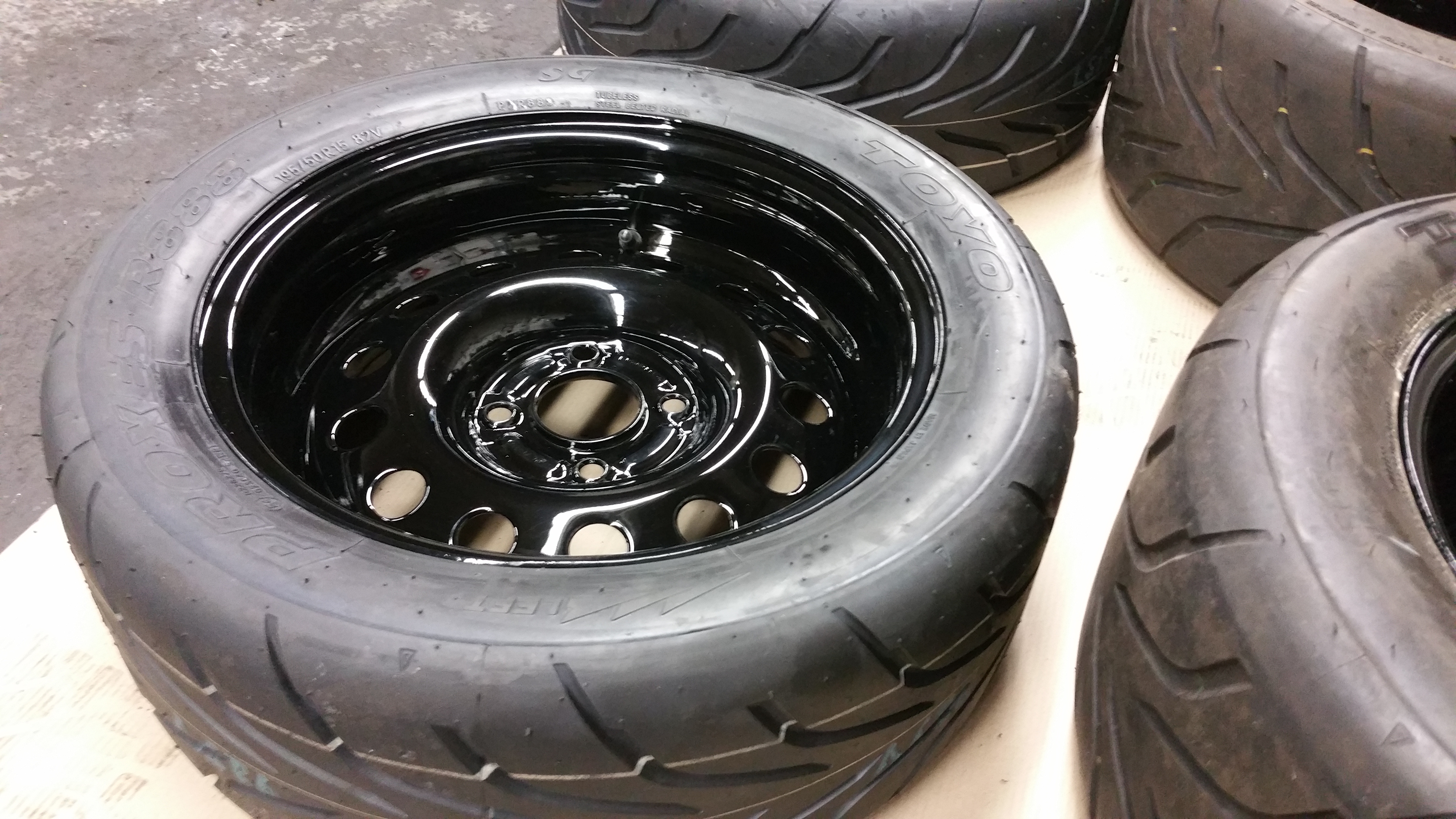

Got my wheels from powder coat and tryed them on
May need tweaking slightly lol

Are they banded TR6 wheels? How wide are they exactly?

Yeah banded there 15 inch ford puma wheels
Fronts the same
Fronts the same

235/50/15 rear and 195/50/15 front
